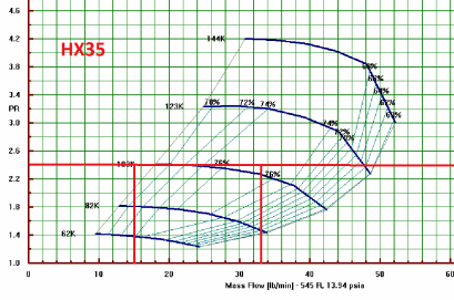

got bored today since im just waiting on shit to ship in so i did some mapping, not sure why the pics are croped and fucked up looking trying to fix through photobucket
with the cam, porting, IM, TB i did the math with 100%VE and 20psi, 1st line 3500prm 2nd 7500
holeset hx35 not sure on the map but it looks legit
best map i could find for my current ebay turbo which is a 46 trim if i measured it all correct (.50 in .63 ex)
a real garret 50 trim
what you guys think i should do?
« Last Edit: April 27, 2010, 08:06:41 PM by speedjunky01 »
Eggylshatch
  • Posts: 2188
  • Pen15 Club President
Re: boosted 4dr...OFFICIALY jdm since pg 6
« Reply #246 on: April 27, 2010, 10:36:20 PM »
holset.  No, I didn't look at the maps.  that is just always the answer.
speedjunky01
  • Posts: 1015
« Reply #247 on: April 27, 2010, 10:43:19 PM »
Truth!!! Lol to bad it looks like it won't make boost till 5000 lol looks like the eBay turd will work better with more then 20 psi but I bet it blows up

Lmao any recomendations of what variant so it has half decent spool time? Wish I had picked one up before the bandwaggon now it's gonna be $$$$$
Eggylshatch
  • Posts: 2188
« Reply #253 on: April 29, 2010, 12:18:50 AM »
Corey is selling the one from his build with a 12cm exhaust housing.  I think that would be reasonable for spool, and he ported the shit out of the exhaust side.  I think he wanted $300.  check his build thread

Didn't know that was Corey hmmmm tempting wonder how it would spool on my shit 1.5 vs1.6 isn't helping and sohc flow ....Think smaller 9cm would be my best bet
« Reply #259 on: April 29, 2010, 01:20:40 AM »
on a 1.5 with a 12 cm, you would see full boost by about 4500-5000
« Reply #260 on: April 29, 2010, 01:24:18 AM »
h1c 12cm made flipnog giggle like a little school girl. You can find them on the ebays for under 150 shipped.

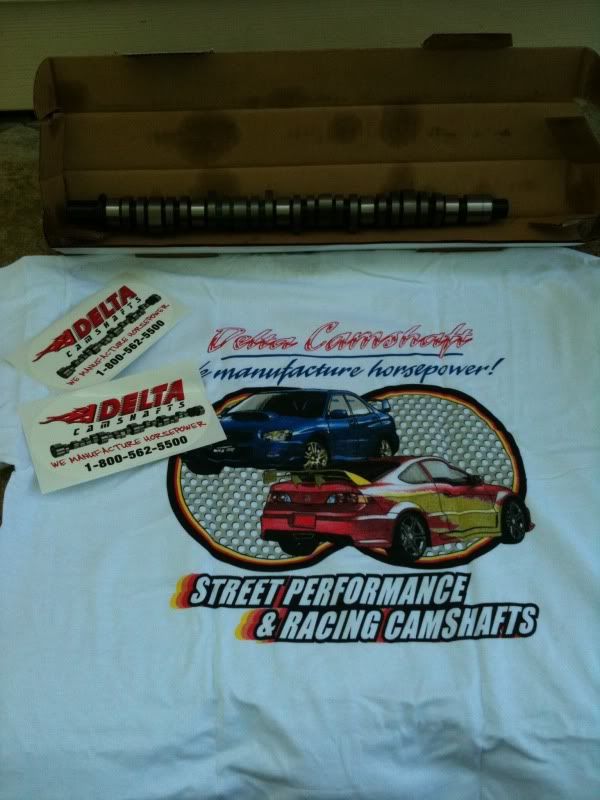

I gave delta a call and asked what they could do for me after watching their videos on Delta Camshaft I was confident on sending my cam out. After talking to Scott for a bit we agreed on a 272 grind :bigok: another benefit is its a stock core cam so reliability cant be beat its straight from Honda!!
I sent my cam out via USPS it fits in a flat rate box (barely) lol and sent it for 14 bucks. about 2 days later I got a call saying its on it way back. :yes: custumer service is top notch and down time is minimal.
the price honestly cant be beat a performance cam for 160 bucks is AWESOME
the packaging was top notch
what you get in the box: The cam, a shirt, and two stickers to whore them out

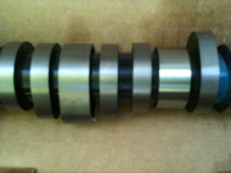

The cam its self looks GREAT smooth surfaces, nicley machined not a spec of rust on it, and no chips missing like in the bisi unit thats in the F/S forum LOL
the lobes look awesome should have a nice loap at idle :D
overall my concencus i see no reason not to go with delta even if you want to go bigger then 272 they can weld the cam and even then its still cheaper then the competitors!
if you want power, price, and 2nd to none service go with delta :bigok:
