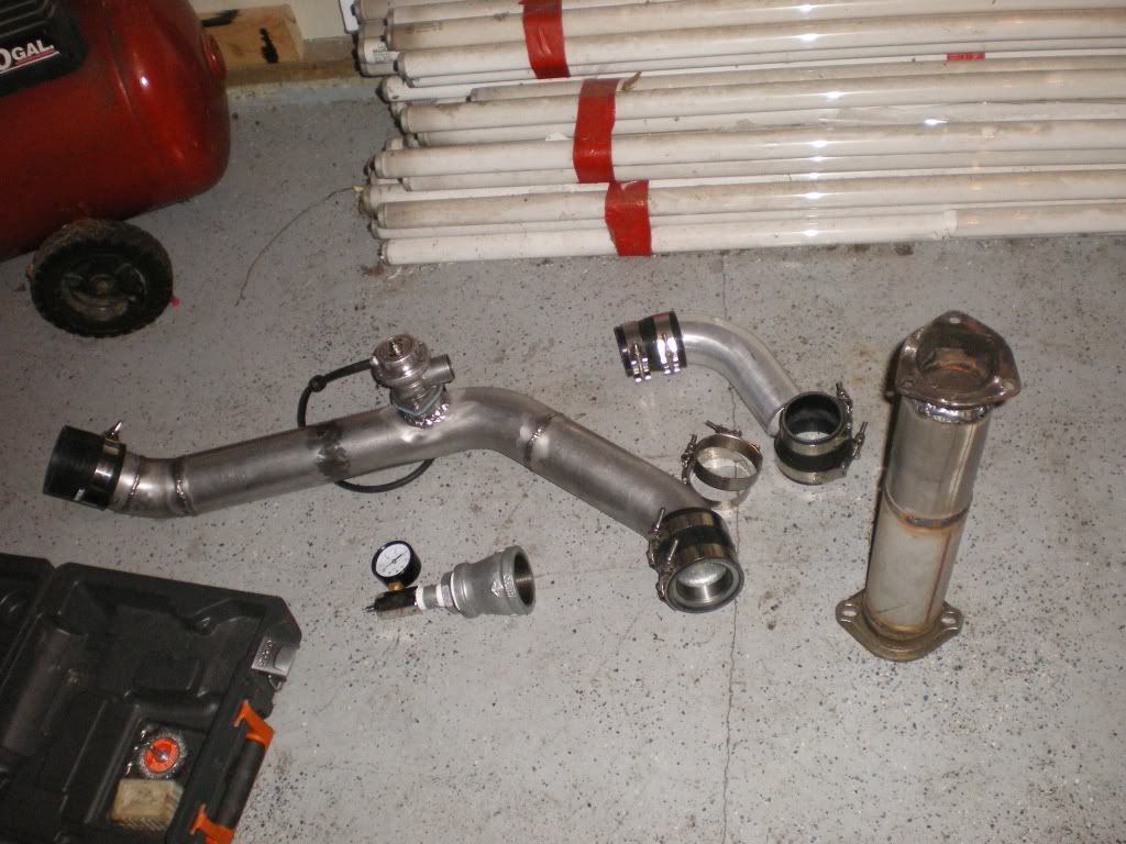

Last night I installed caps on my cold side charge pipe and pressurized it. Held 20psi with a super slow leak from my caps. So its good to go. Just need to clean and paint it.

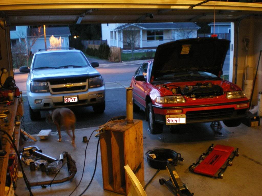

Garage is kinda a mess, but Im getting shit done! Did and oil change.

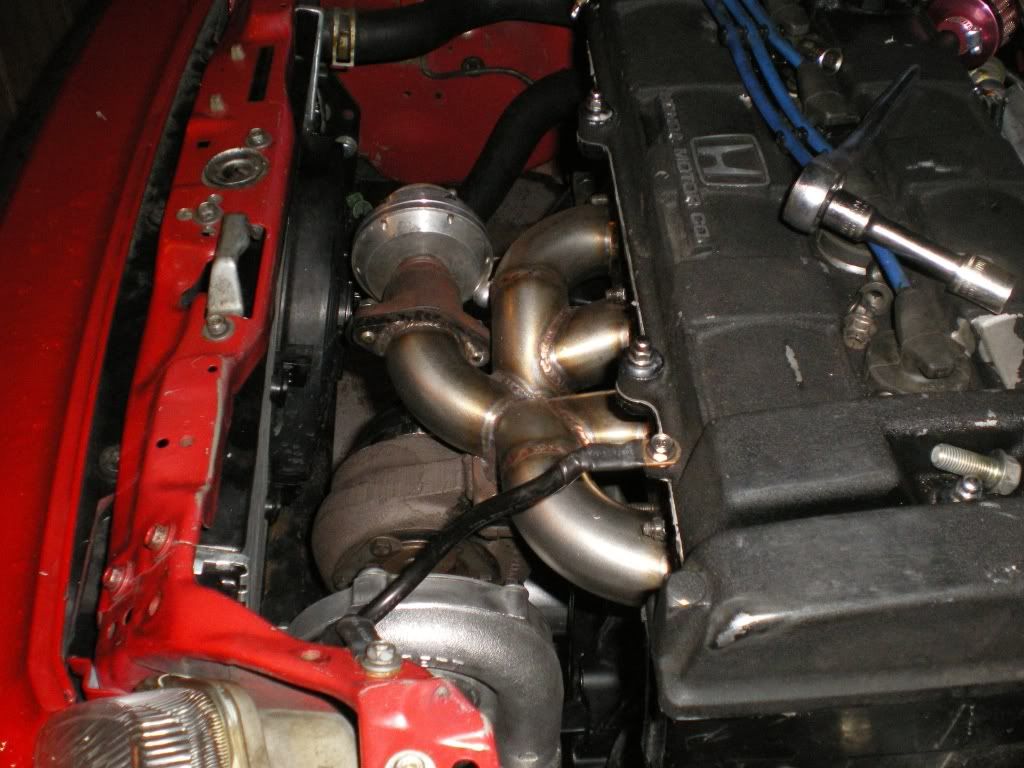

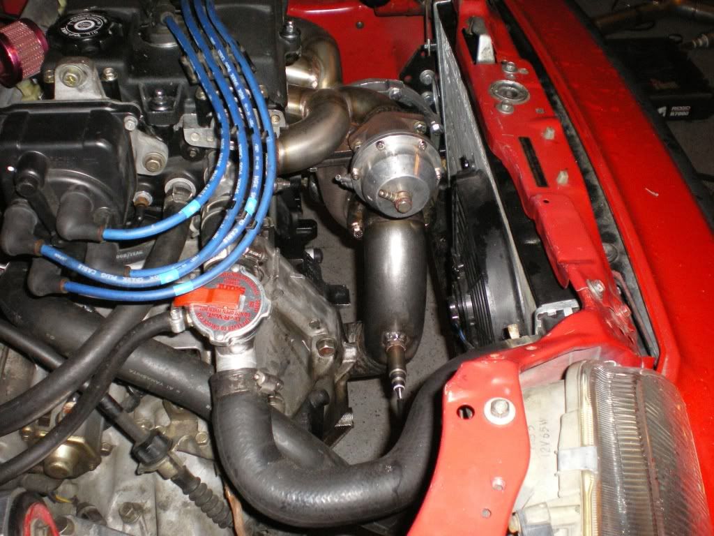

Bolted the turbo in to check fitment on everything again.

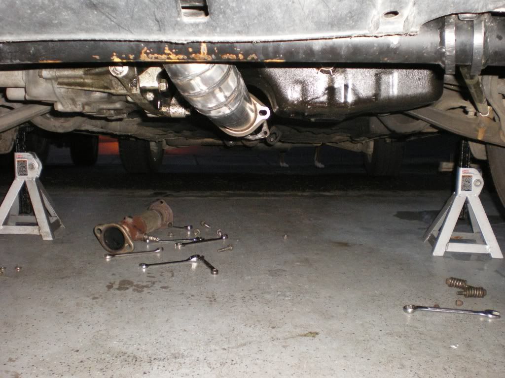

Put my O2 bung in the downpipe.
And made my cat/test pipe to run my exhaust thats on the car for now, and in a few weeks finsh up my stainless steel 3" at Malichite's house. Here is a shot of them in all there glory. With a shot of my homemade charge pipe leak tester.....lol

That leak tester is pimp! We need another pic of it :noel:
Ill get some more pics of it tomorrow.
