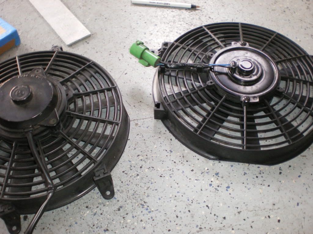

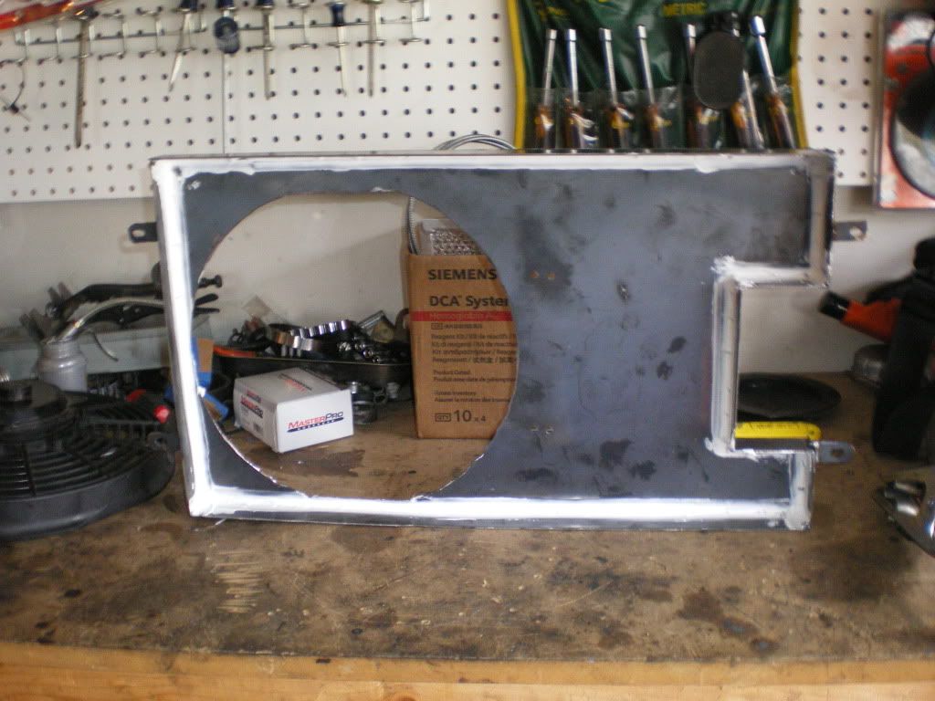

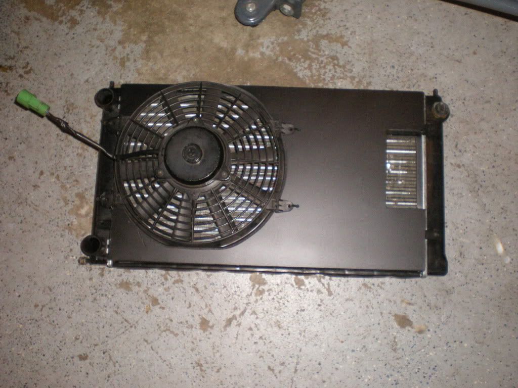

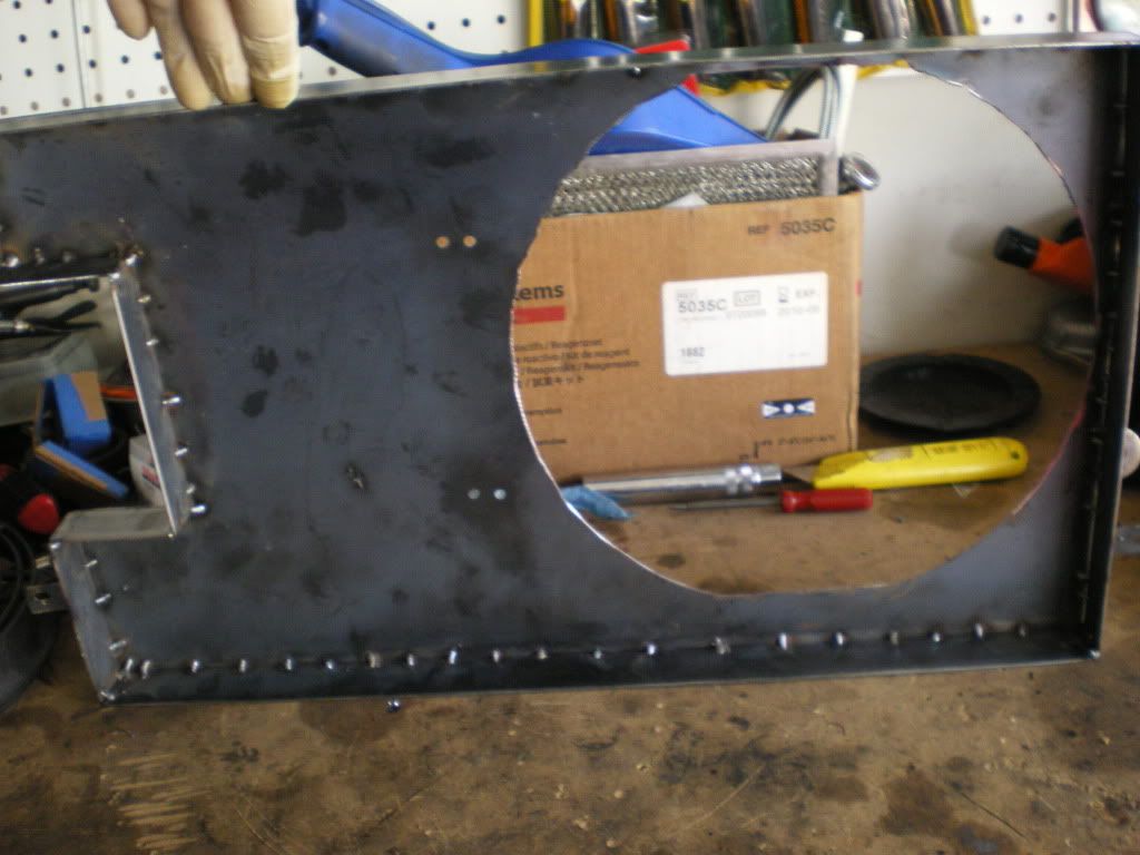

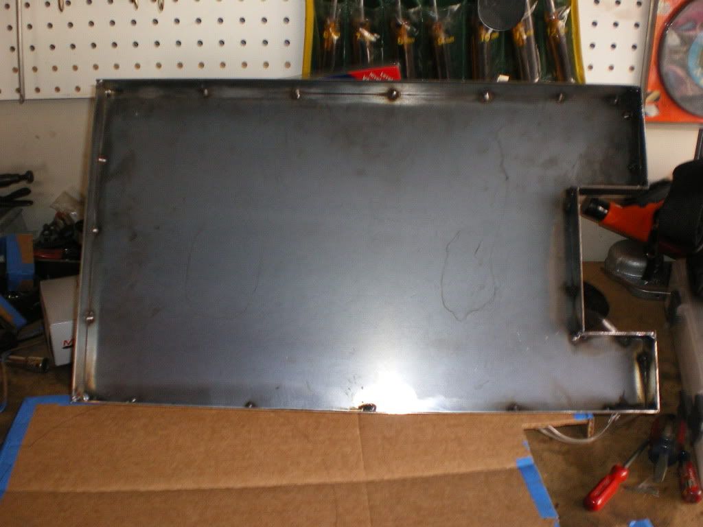

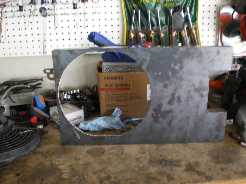

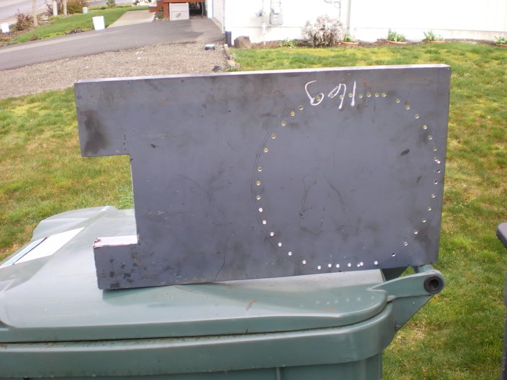

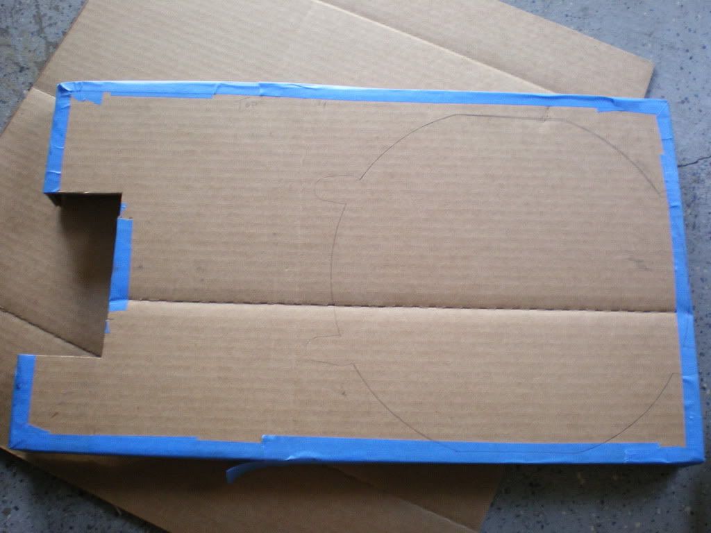

Well had the last 2 days off with nothing to do so I decided to tackle the radiator fan shroud. I had to build one to make it fit. It never over heated but I know once summer gets here its just gona get heat soked and I will then be fucked. After doing a some tuning some street tuning I was seeing some 205*-207* And thats more than I want to see as its only 50* outside right now. So here are a few pics.
As it sits now.
Here is a pic of the crappy ebay fan on the right and my revcore on the left

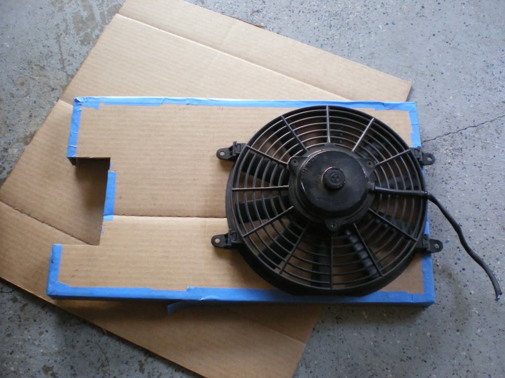

Cardboard for mock up

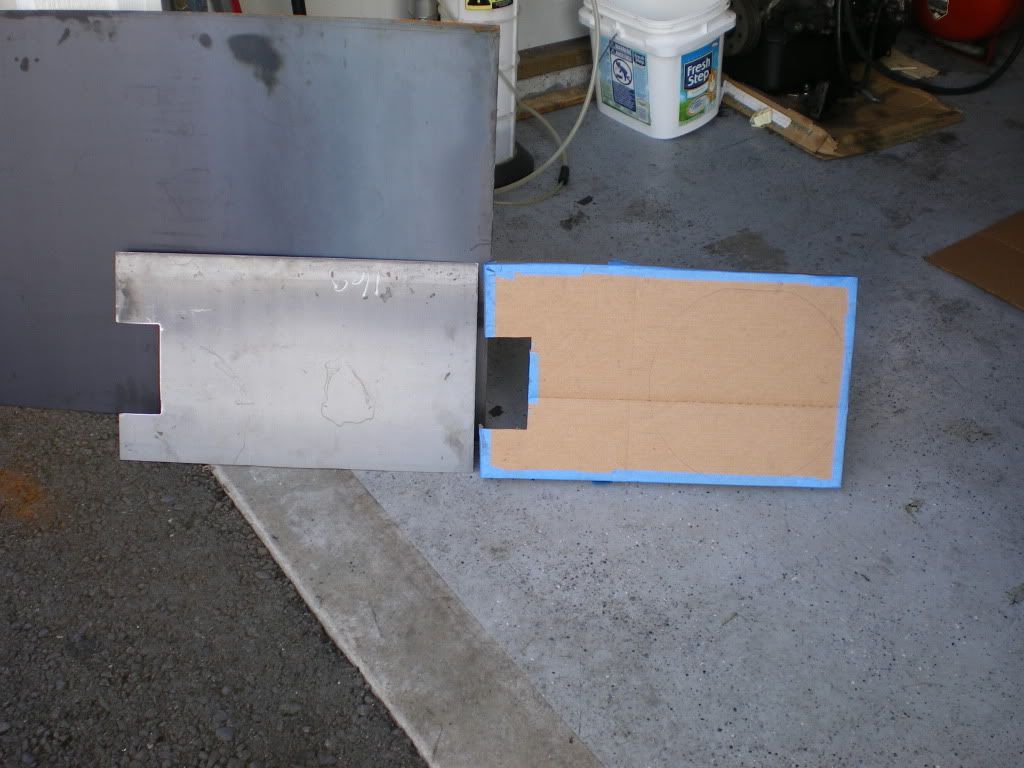

All cut up and here is what its gona look like
Here is a pic of the fan shroud in the making
And here is a shot of it just held in there

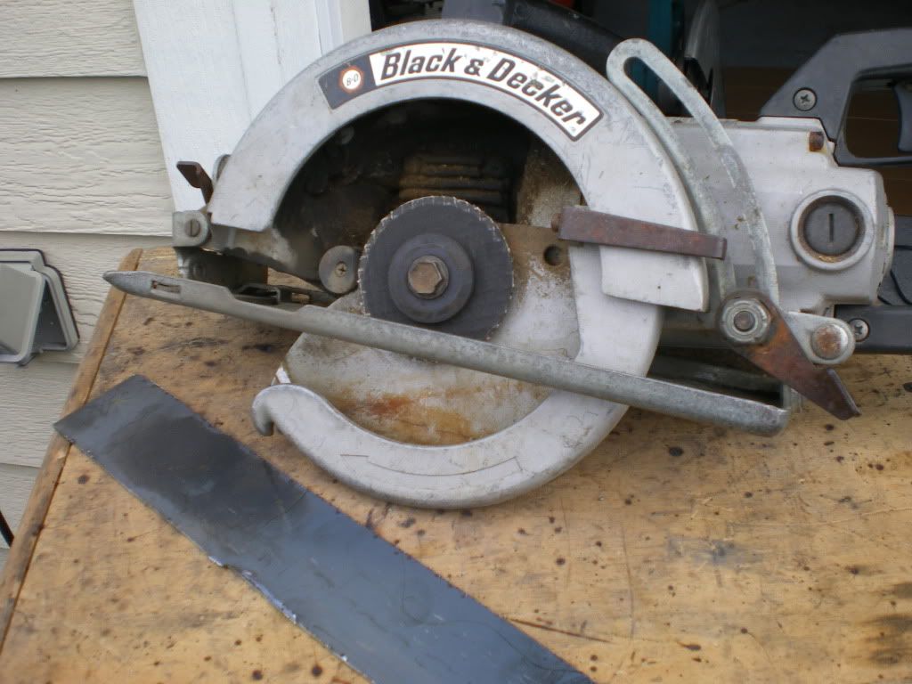

So after all the metal cutting this is what my blade looked like.
So here is is all tacked up

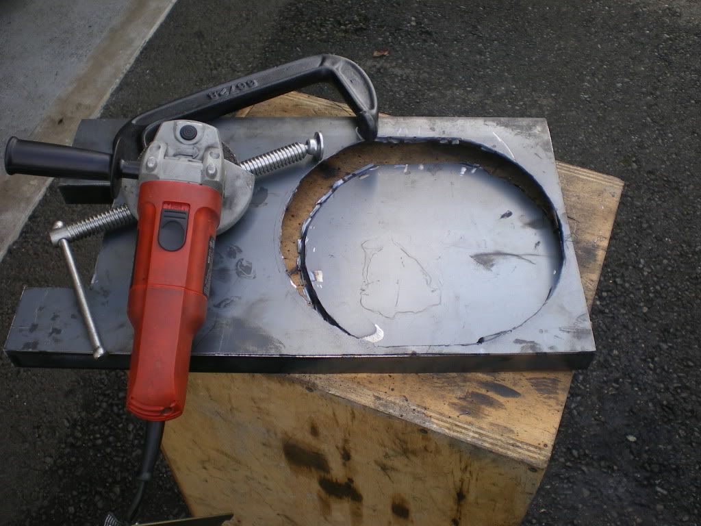

So I drilled a bunch of holes and used the angle grinder to cut the hole out.
Added a bunch of extra tack welds
And put some calking on it to seal it up.
Here it is all panted and ready to drop in. Just need to put my screws into the shroud that hold it to  radiator.
Put some paint on it and put some weather stripping on the radiator and some on the shroud around where the fan buts up to it. I have yet to install it because I ran out of time today. So It looks like I will be hitching aride to work tomorrow.  :-[ Once its done I will post up some final pics and let you guys know what it dose to my temps.

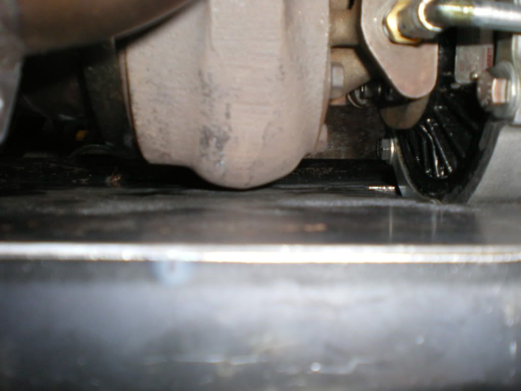

Well i just did one last test fit with it attached to the rad an it fits fucking perfect. Also got the air filter on the turbo and it fits good as well. I will snap a few pics and put them up later on once im all done.
