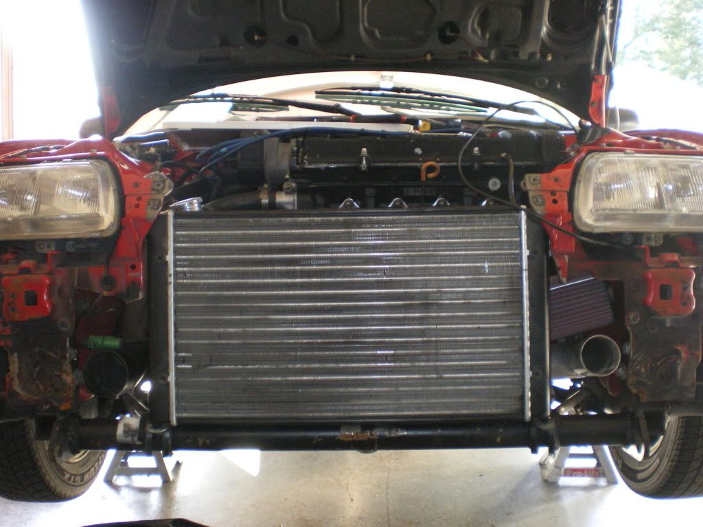

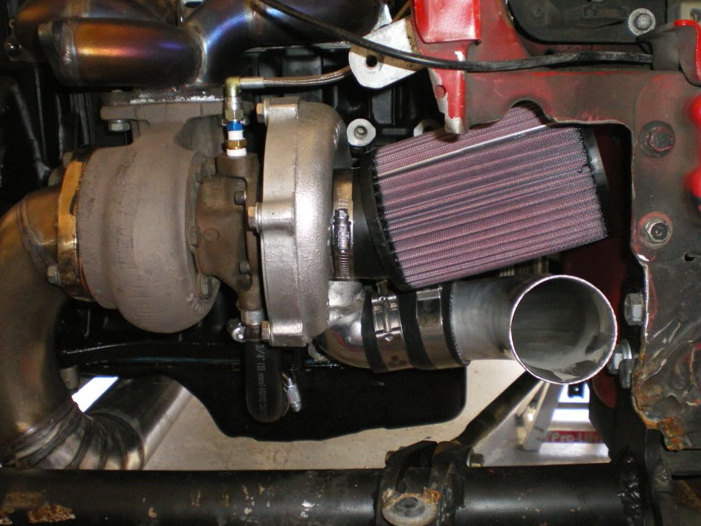

Well Got it done today :D  Fits great, looks good and better yet, it works O0
So It took about 20 min for my car to reach operating temp with the fan hardwired on like have had it, b4 it would only take about 7min. This fan is totaly kick ass, Its like a damn wind tunnel when its on....lol
On to the pics
Look what showed up in the mail today from another local nw NIG O0

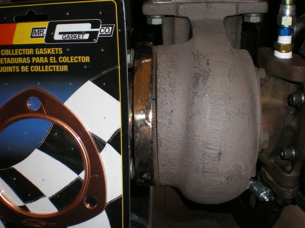

Figured while the rad was out it would be alot easyer to replace my dp gasket with my new copper gasket.
this it what it looked like after I pulled the bolts
And My new K&N filter installed
Here it is installed
All in all I will say it turned out greeat.

fuck ya man, your shits badass. now get the can on and call the black man for nog boost racegas dirty 3rds fun.  :noel:   thats a big filter :o

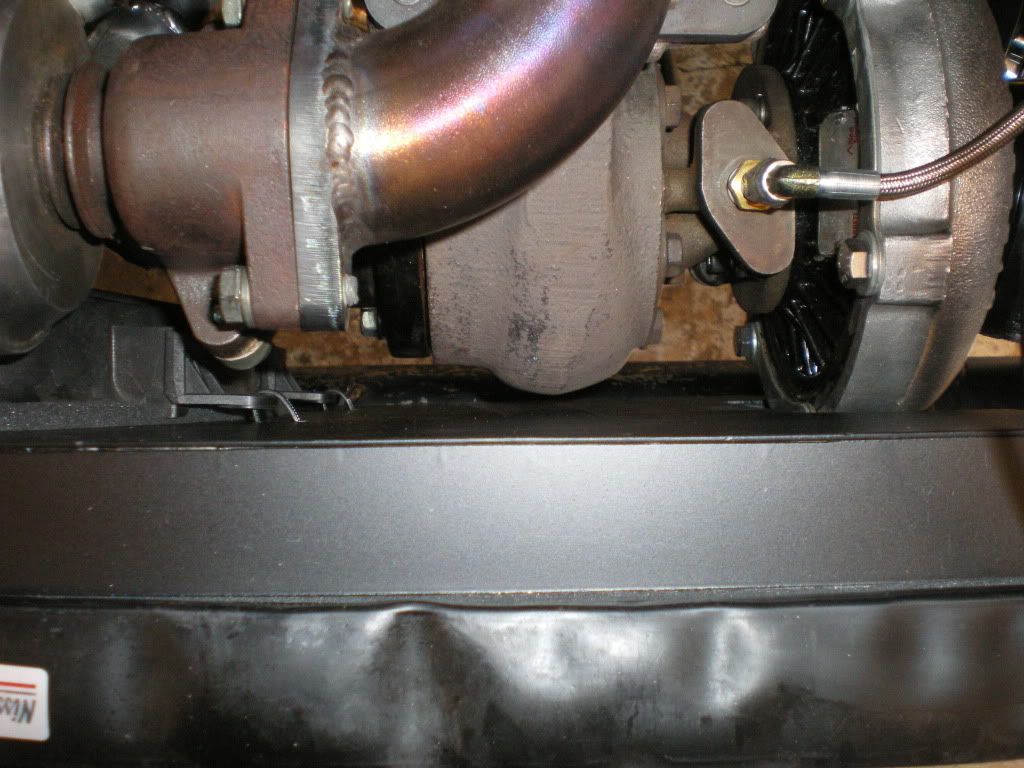

What adapter is the brass on your feed line? The standard 12x1.5? My feed line is leaking from that gold adapter
I think its 1/4"npt to 1/8"npt. I think that your holset is sae, and not metric. But im not 100% sure on that.
its metric

Well it looks like the getting hot issue is over. I couldnt get my temp above 186 today. It was pretty cold out. It was about 40 outaide today. I did about 5 or 6  2nd and 3rd gear rippers in a row and couldent get it to go above 186. And when i was just cruzing it was at 180ish.

 :o That aint cold, it was almost that warm this weekend and it felt like fucking summer!
Kickass shroud, glad to see its workin for you. I think I'm gonna have to steal your radiator idea for the ED eventually...

Mine only "overheat" (little over middle of stock gauge) when I'm in the traffic for a long time in a sunny summer day over 25C. I just press the fan button and it cold down to normal. It's an ebay slim fan.
My car is black, it doesnt help in a sunny day. (no racist allusion)
Good job sir. Full length radiator FTW! :P

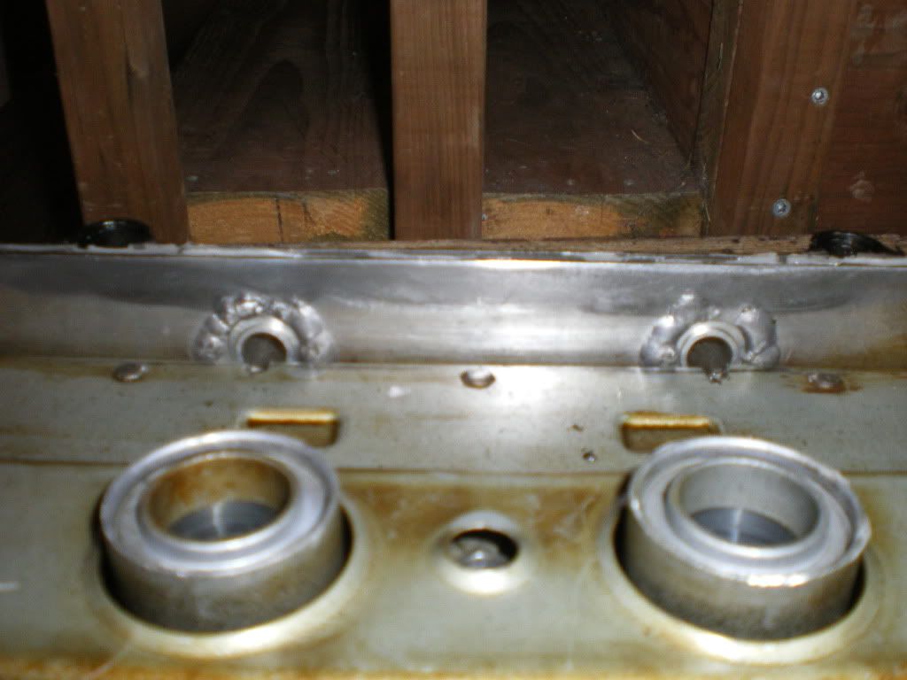

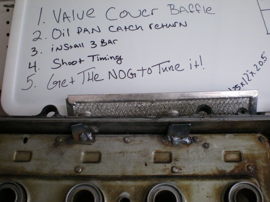

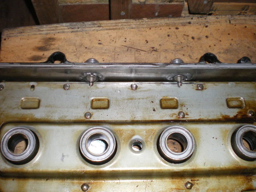

Well only have a couple of things to wrap up with this thing and it will be on to the nog setting. So here is one thing I can check off the list. Got the baffles for the valve cove done today, now im just wating for me 90* an fitting to show up from speedwaymotors.com for the oil pan.
Here is the setup b4
And here is what happens when you dont give a fuck about how it looks,
Gona work out great!!  ;D Just needs a good cleaning!!
Throw that trick slut on and get to the dyno!
Fuck man not ready for the dyno yet. As you can see in the background of the last pic I have 4 things left to get done b4 It see's the dyno. It will see the dyno on the dyno day for sure. Hopefully b4 that too. But we will see. I might just do a street tune with dave and then tune the high boost runs on the dyno. Its not easy to tun by myself while driving and trying to not get tire spin.....lol WHHHEEEEEE!!!

is that an overhead fan filter for a oven?..baffles look great!
Is what an overhead fan filter for an oven? I have not used such parts on this build, but its not a bad idea ;)

air filter? don't think I've ever had one of those connected to a turbo  ???
Well I was just gona say fuck it and not run one, But with my luck I would suck up some gravel going down the road and it would fucking piss me off! :hotrex:

So things to do.

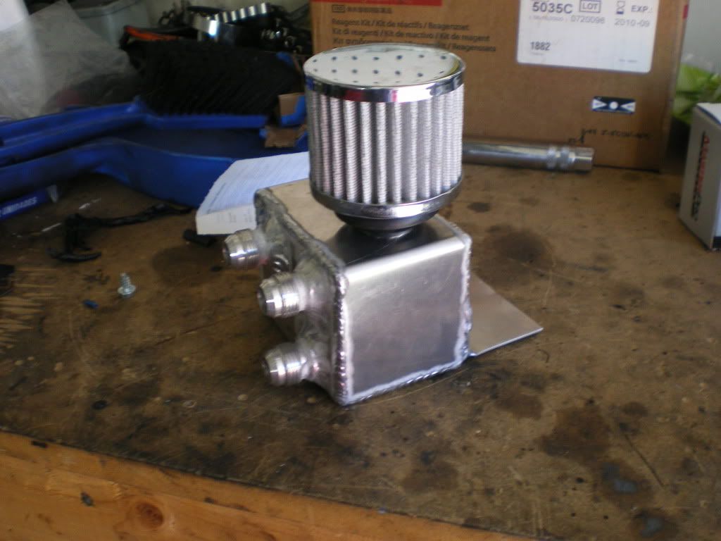

1. Drill my extra oilpan for catch can return
2. Drill my catchcan and wash it out and mount it. \
3. Wash my valve cover out, and my newly drilled oilpan
4. Put my 3bar in and street tune my car
5 Talk to the nog and get a little tuning

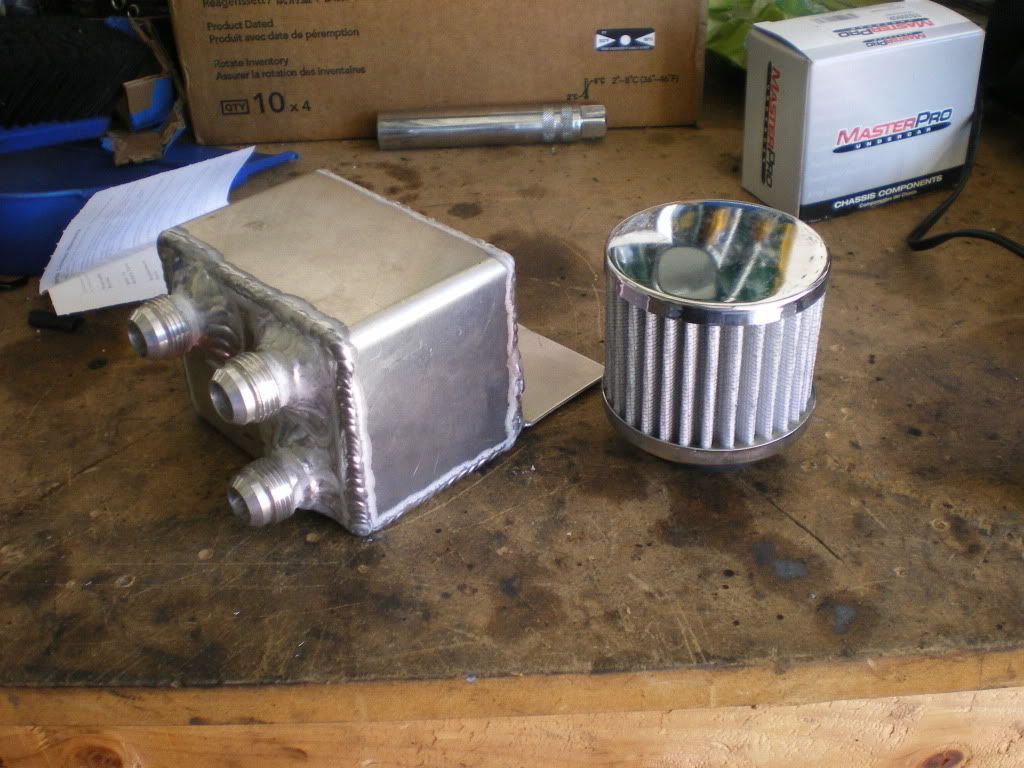

Well I didn't get any new pics of the can setup, but it did turn out pretty good. The only thing is I need to go get a different filter for it. One thats sealed with a barb coming off of it so I can run a hose off of it to under my car so I don't drive down the road smelling of oil vapor :-X. I also need to get some different hose. The garden hose just isn't going to cut it. It gets way to hot sitting right above my turbo mani and get super squishy. I will get pics of this thing tomorrow. Cam battery is dead.  :'(
