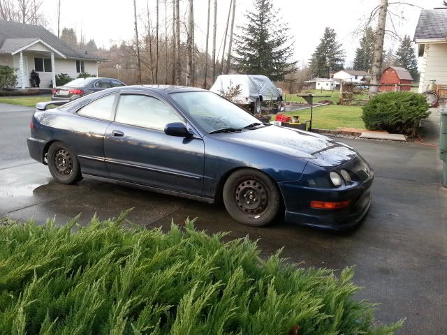

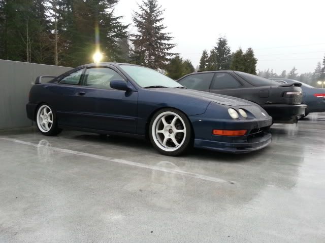

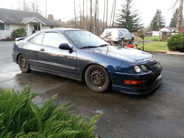

1998 Acura Integra LS

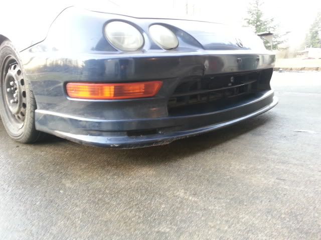

i hate this lip... looks ok i guess.. fucker needs to leave. NEED OEM ITR LIP!!!

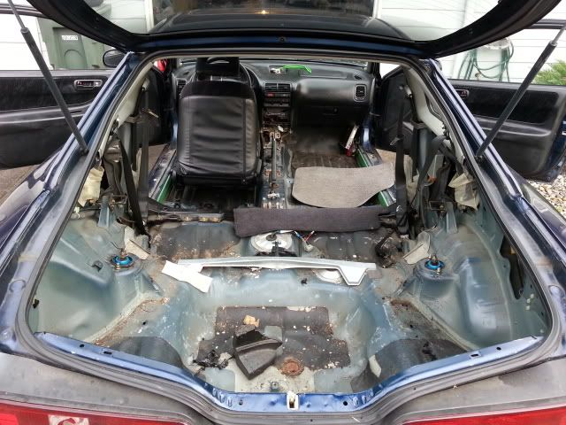

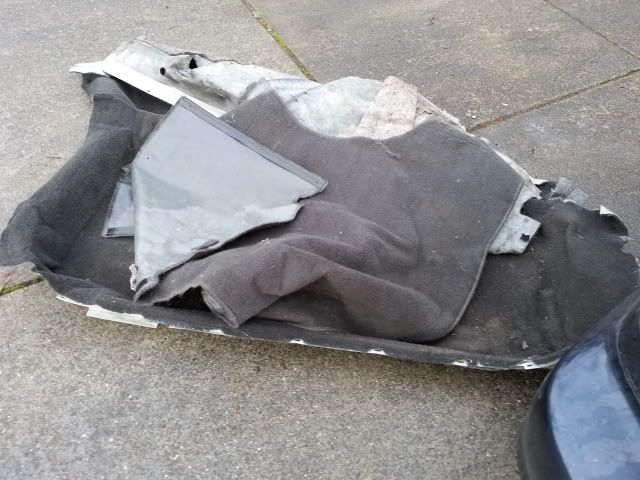

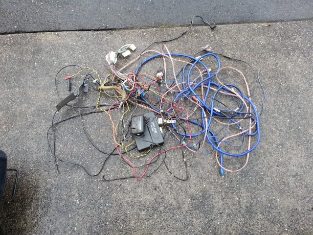

"extra parts"... old ass cira 98 Alpine alarm. couple sets of RCA's, lots of random wires in that piece.

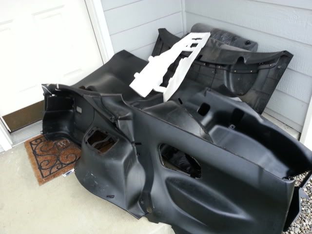

car had a smell. so i pulled the carpet to pressure wash.
think i had the car a day? when i did this lol.
omg...

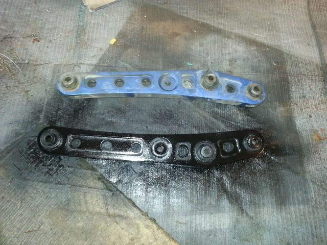

so these are FUCKIN GARBAGE! they where on the car when i got it... they are Blox LCA's. 4 of the 6 bushings are SHOT. and well they are blue. so i painted them black. also i have 96-00 Civic coilovers, so the shock bushing needed narrowed....
...then i notice that the fuckin swaybar wont bolt to these things. i threw them on anyway, i have since picked up some OEM arms with swaybar mounts i still need to throw on.

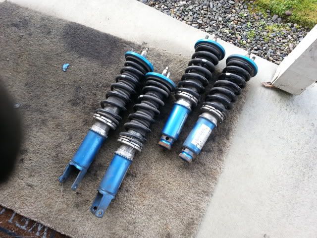

ahh my Cusco Zero-2 coilovers.  :Jew:

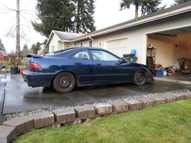

so i swapped those on to get rid of the ghetto reverse rake....
think i did all that the first or second day i had the car. interior is all cleaned and reinstalled.
how she is right now. i kept my wheels (17x7.5 Advan RG1's) off the Civic obviously. was planning on a new set, but these look better on the Integra than they did on the Civic. so im gonna roll them till the engine/turbo/etc is sorted out i think...

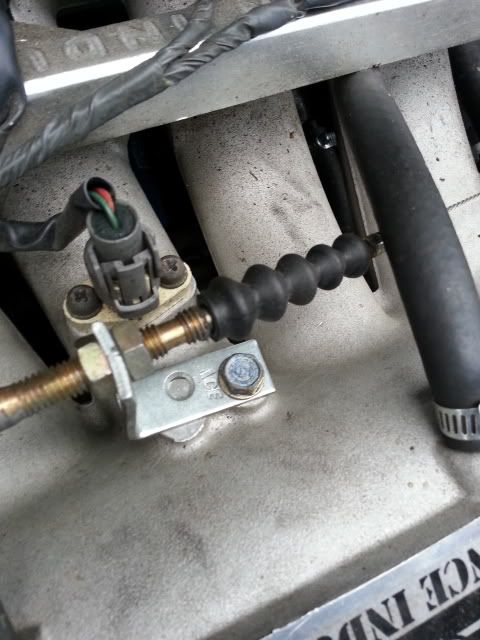

i always hate this, just buy the right fuckin bracket... but this one was pretty solid, and parts supplied by ACE hardware. so, cool.
oh this is the fuckin scariest.
omg. seems solid though. but always wonder when its gonna go up in a ball of flames.  :-\ :-X

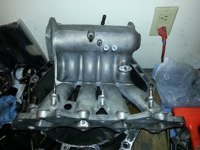

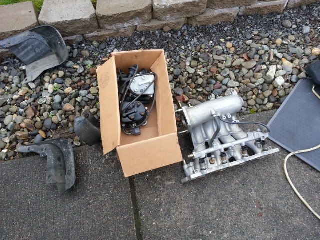

couple non-vtec distributors, obd1 p75 intake with fuel rail (i needed these things for my swap)
got stock air box/tube, and a OEM accessory moonroof visor i promptly removed (not sure i like it?), also has OEM door visors, and painted ITR rear spoiler (i swapped it on as you can see above), and of course the OEM accessory spoiler.

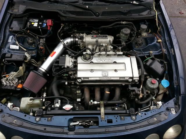

oh yeah, here it is:
all 155whp and 106ft tq.  ::)... this is NOT saying in the car. i might put it in a Civic im getting. havent decided.
B16A3 bottom (stock)
P72 head w/B17A1 cams
Blox intake

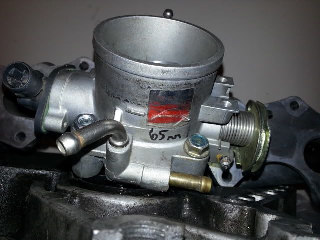

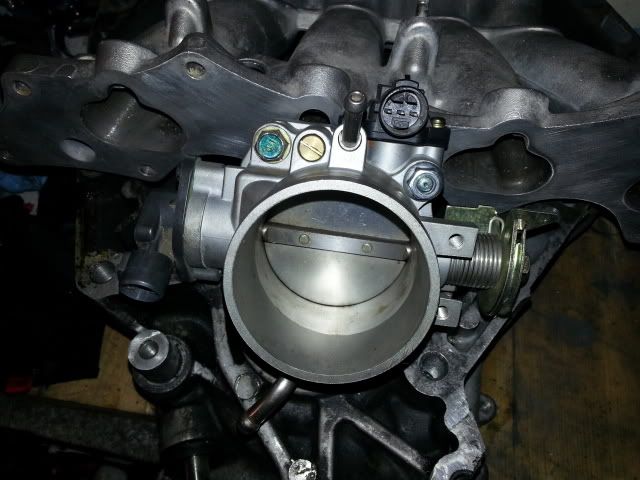

Skunk2 66mm TB?
Benen fuel rail
china header that makes subi noises
K&N intake

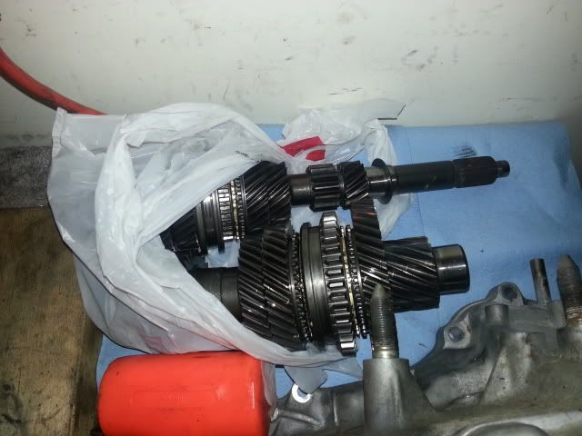

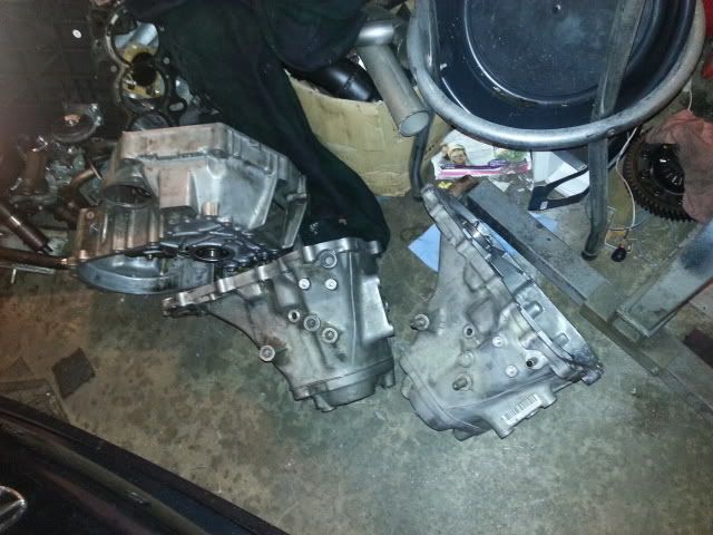

JDM non-LSD B16A trans
P28 tuned by a guy Nate here in town.
i really think its a parts bin motor. like he called around and this is the shit he found for cheap.
as you can see it still has PS, AC, CC, washer resivor, etc, etc. think he was too lazy to start hacking shit out like most guys. i plan on keeping it all.... maybe not the cruise control, havent decided on that.

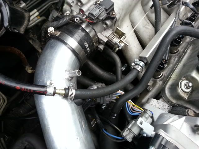

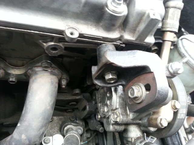

I had a car catch on fire with that same fuel line shit loooooool
being 16 and trying to tap into a dry rotted ass ed6 fuel hose for a pgmfi conversion.
fix that shit asap

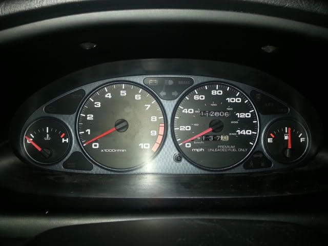

buddy said this was broken, fuel gauge stopped working again. found him a cheap cluster, jewed him slightly on this.
then i took both my old cluster and the "new" 98 ITR cluster apart and made one perfect one, one pile of junk.
so yeah, working ITR cluster for deals...$100

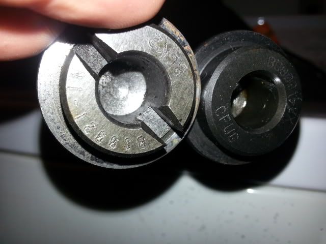

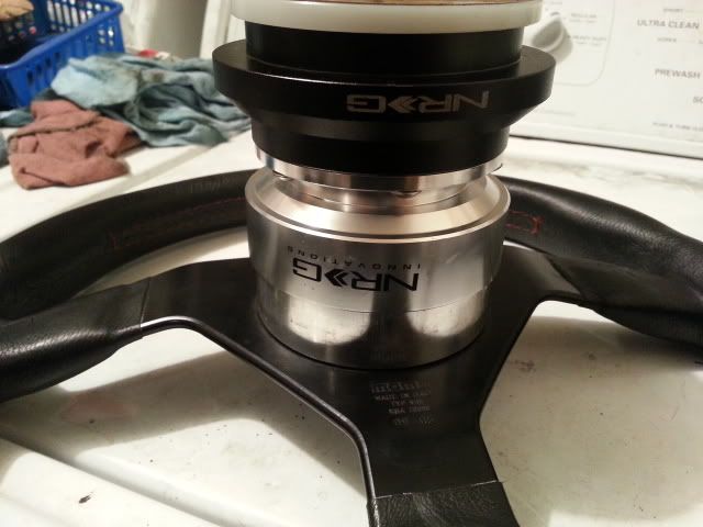

this is the reason the cruise control stopped working lol. normally i wouldnt buy NRG anything, nor a quick release... but i got the short hub and release for 40bucks? so yeah. ok.
and im sure no one here cares...

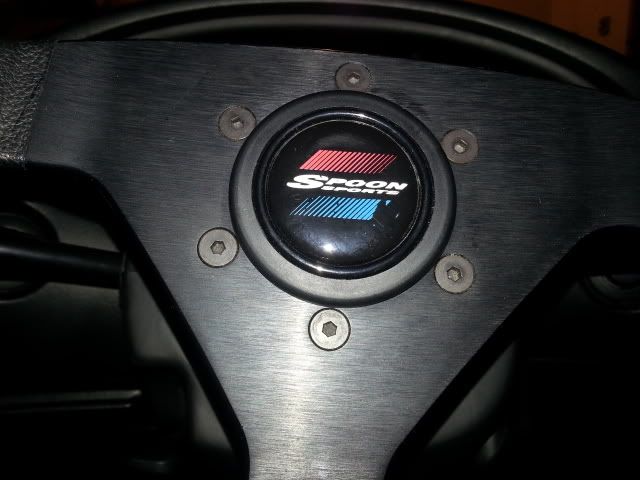

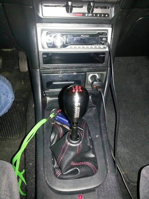

but i bought another SPOON wheel. i was kinda disappointed with the MOMO Tuner i had in the EK. it didnt have the quality of the SPOON wheel ($230 vs $465). this one is used, but in nice condition. just broken in. and i love it. so fuck off.
$200 for those who are counting. its jew deals, but i didnt even jew, he said the price, i said MINE!/SOLD!
ITR boot was in there when i got it, Skunk2 knob was stolen from EK on trade, love the weighted shift knob.

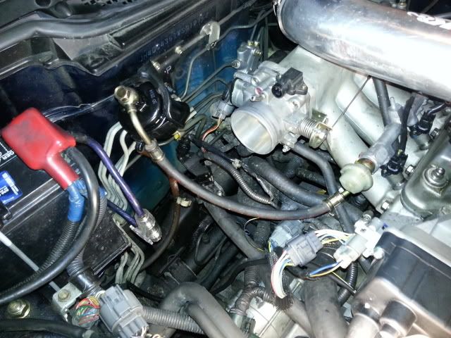

so fuel line. fuck.
i dig around and find a line... ehh wrong one... find another... same. shit... another!?! perfect! good legnth, right fittings and angles, etc.. take the B18B rail off its intake. swap injectors, replace an o-ring..good right? FUCK, i checked to make sure i had everything, even found the 2 washers i needed.... i dont have a fuel dampner cap fucker that goes on the end of the rail!!!  :evil:
call a buddy that i know has one, suppose to go to his place anyway... but he was in the superbowl mode, and didnt call back...
head to buddies to help on his project, and steal extra from him.... and some other parts for my project, ill post up that shit later. mostly misc shit.

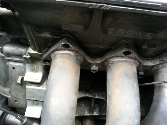

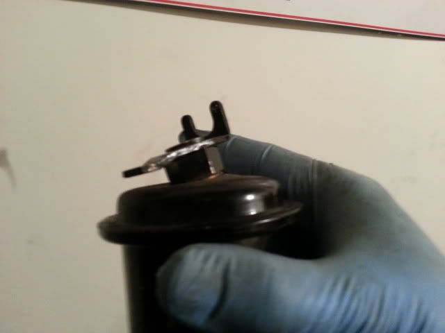

then i noticed this....
oops. fuckme.  :-\
so i work at honda, no big deal, i guess im replacing it like i probably should have anyway. bottom fitting was of course a bitch too. but i was careful this time lol.
yup...2 days later? lol.
fell a LOT safer now though. so its worth it.

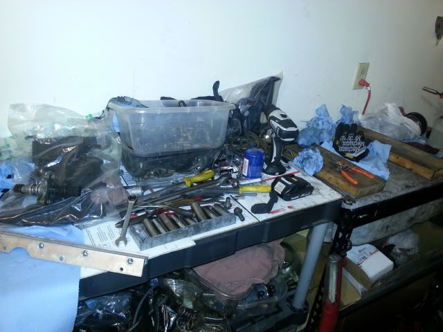

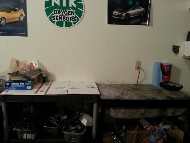

ok, so my place is a mess. really should spend a day and dump run everything that doesnt bolt to a car i currently own...
but i cleared all this space that was full of junk and bolts/hardware. so i have a good place to work from. see how long that lasts...  :-\
after i got a clean space, i filled it back with shit lol. actually i gathered up all the parts i was going to use.

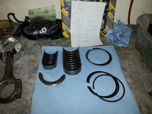

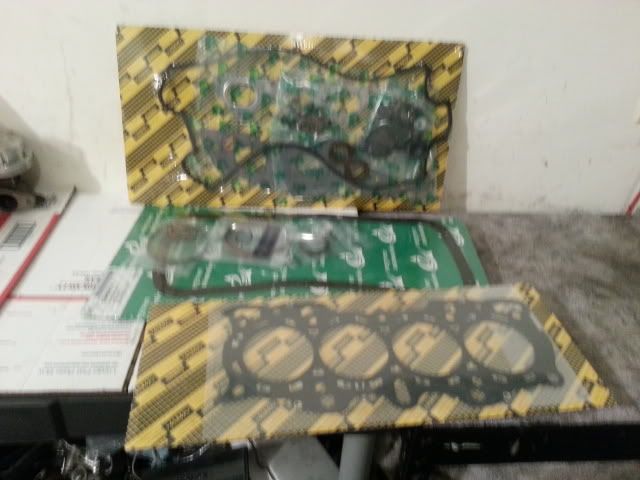

once again i got a gasket set from Mizumo Auto on ebay. actually i got pistons, bearings, rings all from them. good deals.
ahh, there they are. looked for like 10mins for the thrust bearings, fell behind the bench there. fuck.

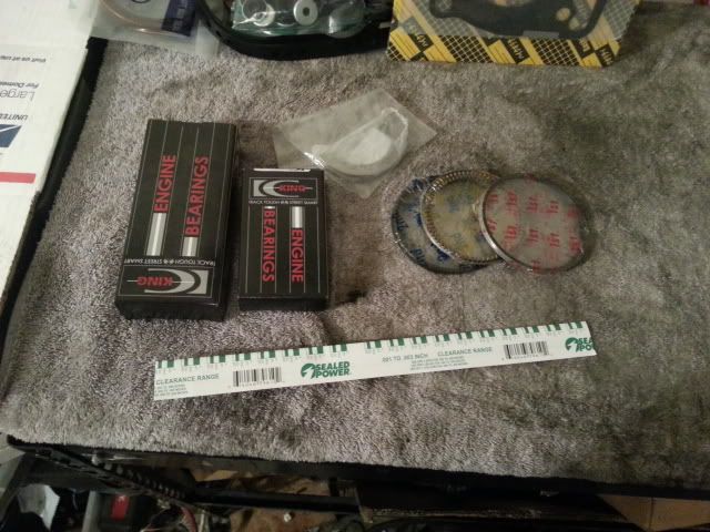

also got some more GREEN plastigauge. i only had red, cuz you dont use it for a honda? you need GREEN for mains/rods on a B-series.
King bearings, NPR rings.

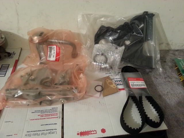

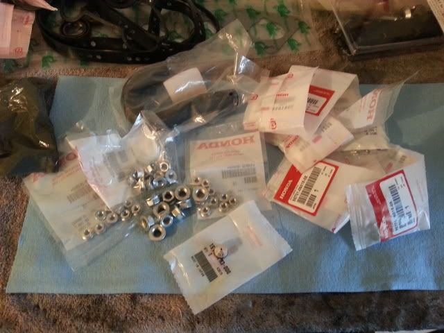

one of im sure a couple Honda orders for this motor. new "ITR" oil pump, pump pickup (motor are a bearing, didnt wanna risk it), gasket and oring for both those. new thermostat also. new timing belt of course (well i did reuse one last time i guess lol) and a new lower cover, cuz the crank pulley was cutting into the last one.

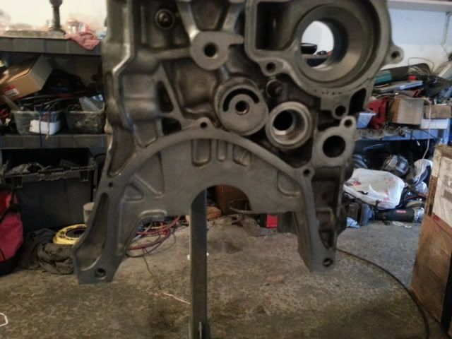

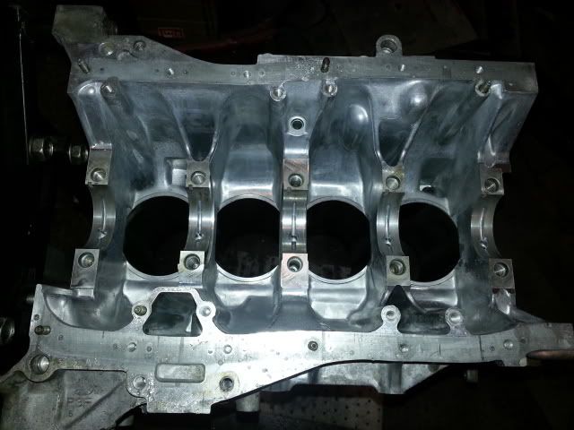

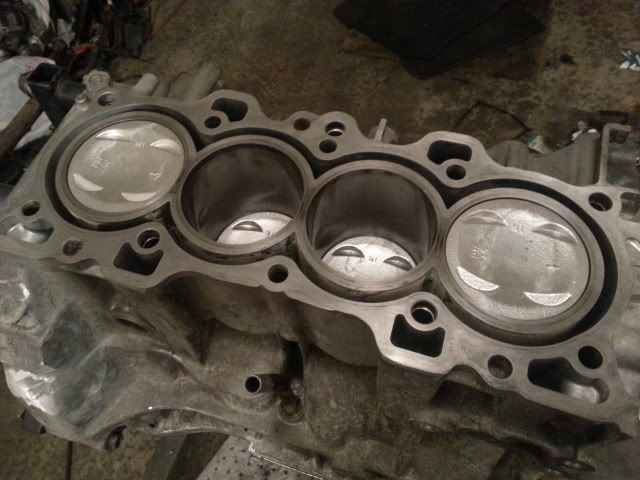

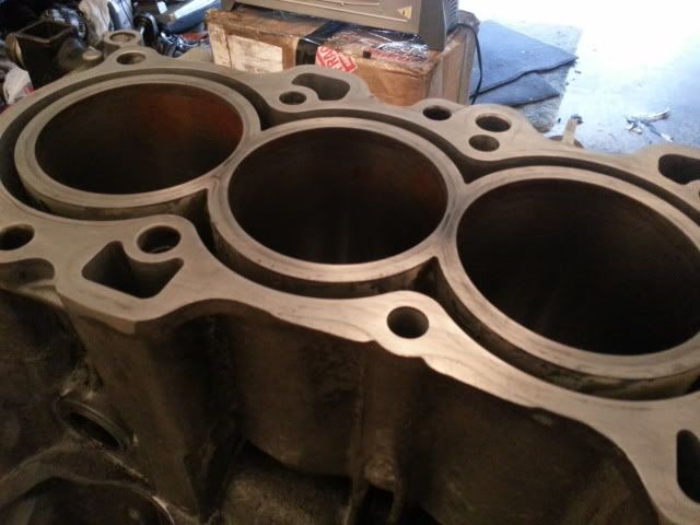

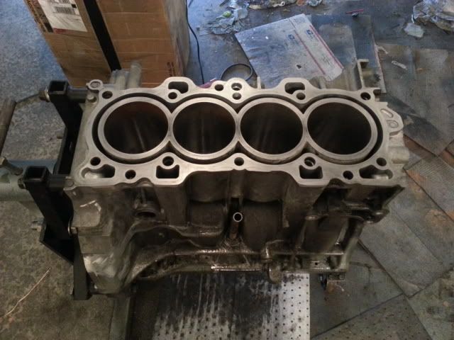

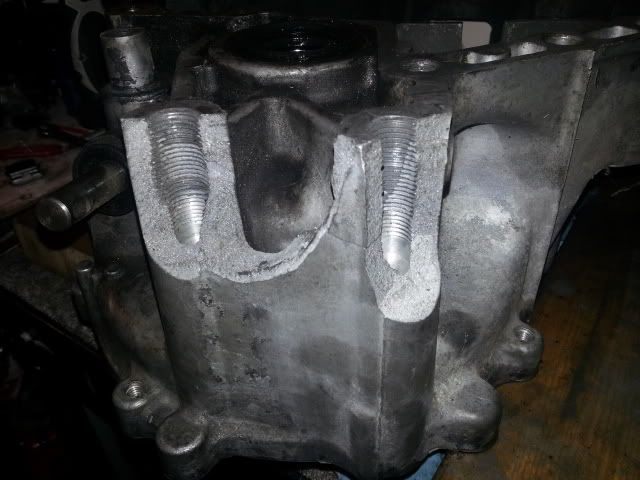

block all cleaned and prepped.

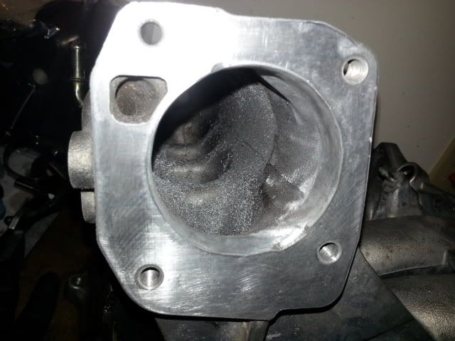

it should be said that i honed this block, and cut it for the turbo (ill post better pics later), then it spent a good while in the parts washer. then pressure washed. with both main oil galley plugs removed (better pics below). to get a good cleaning (spun a bearing before, im paranoid)
then i emptied 2 cans of brake cleaner here to make sure everything was spotless on the inside!
deck all clean

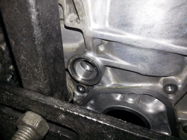

front oil plug pulled. its between the tensioner and oil pump hole.
goes all the way threw the other side to this one right above the rear main seal.

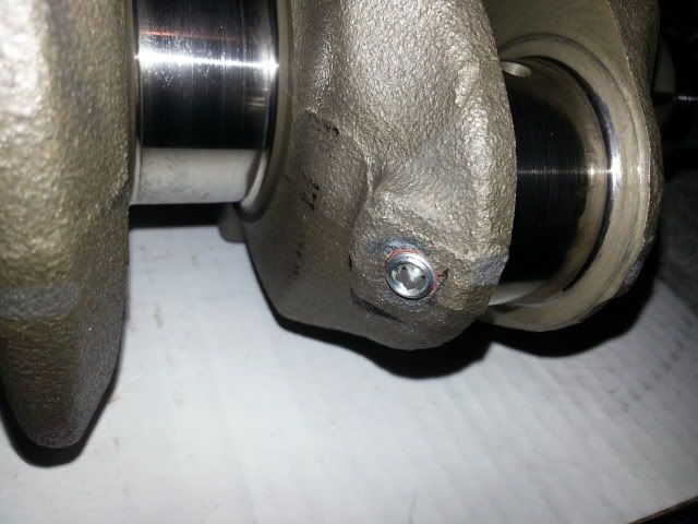

i cleaned the shit out of that path. and to the oil filter. up to the head. and to the mains/crank. i got a set of brushes from HF.

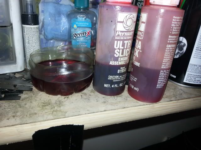

assembly lube.
i have a couple different mixes here. dark one is off the shelf. the lighter one is 50/50 with some oil, and the little cup is mostly oil.
i use the cup for headbolts, cam bolts, etc
lighter shit for cams when setting up lash
dark stuff is thick as shit and sticky. put it on the crank/rods, everything else if its gonna sit for a min before starting.
there is some ARP lube back there too... but no ARP hardware in this motor, so it didnt come out to play...

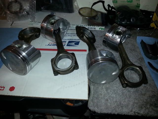

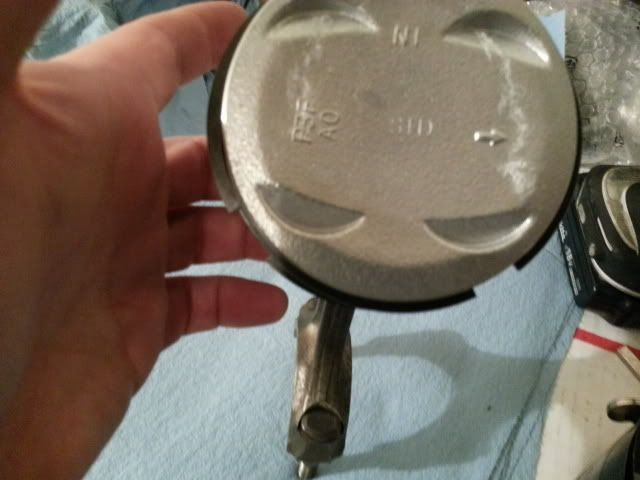

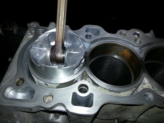

brand new pistons... went with stock P3F-A0 pistons... didnt really research like i should have as Jeff pointed out, ballz low compression with these pistons. oops, whatever. CRX moved with them. also  :Jew: cheap.
all staged up. got my specs written down in the back. id post it up, but im told my writing sucks, so look that shit up yourself. download a Helm/factory service manual.

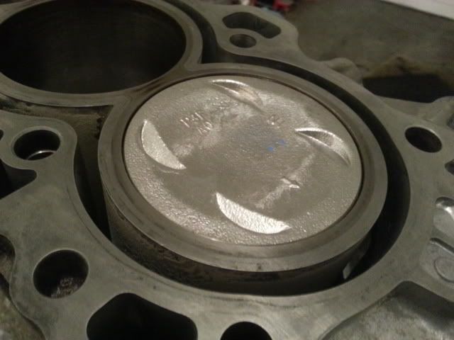

setting up for ring gap check...then filing to spec...well beyond spec cuz im gonna beat on this shit.
freshness

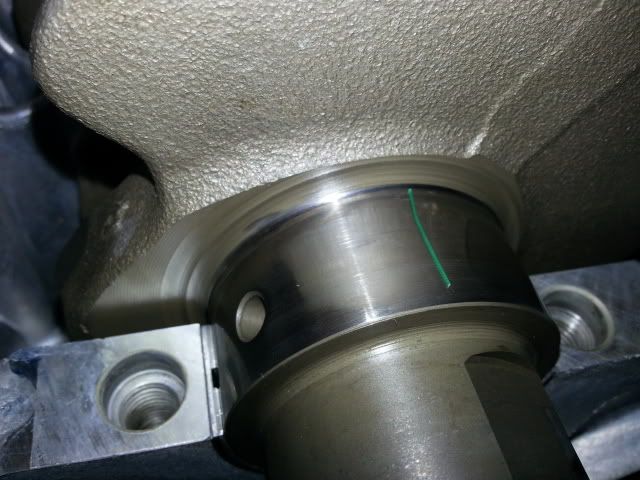

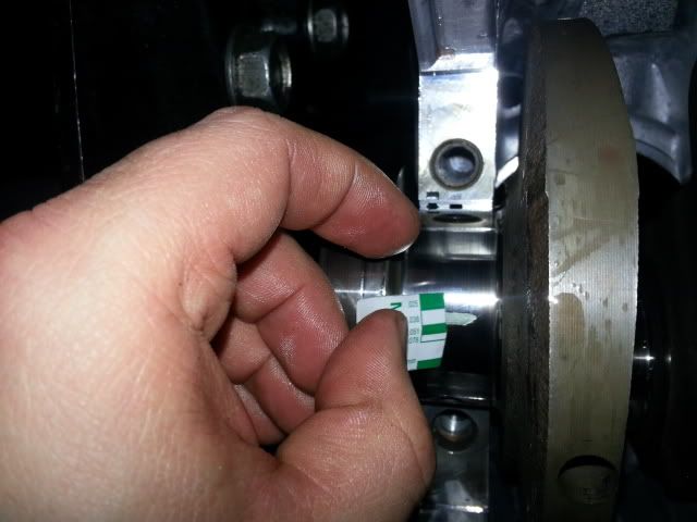

so there was some talk about this on another forum (GVR4), and i have heard about it before, never done it. they drill out/remove the pressed in balls, clean the passages, thread in allens and locktite/stake them. decided i would like this motor done pretty baller. so had it done. im happy. plus he said there was a TON of shit behind those plugs...
hey look

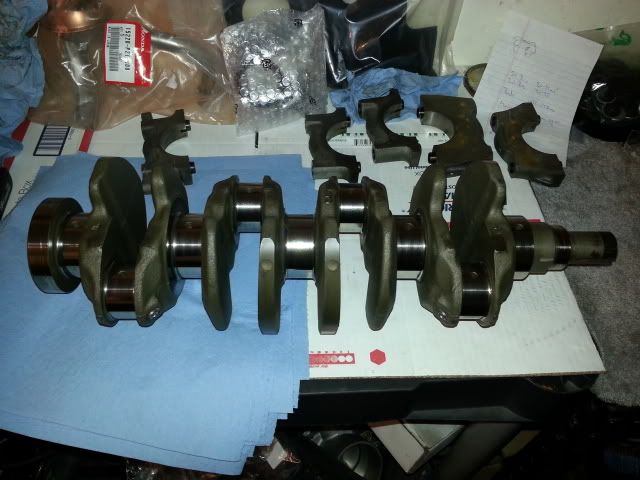

im plastigauging a motor!   ::)  i dont do this shit anymore. but like i said. i want this motor nice.
look
waste of time...  ::)
all mains/rods spec'ed out perfect. then i did it my way, and crank spins over minty smooth. so piece of mind, and proven working....
and this his how turbohf clocks his rings. oils are somewhere on the top.
i always do top ring on the right, 2nd ring on the left.... but thats me.

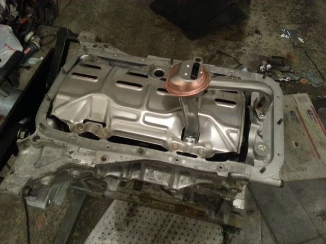

rear housing with new seal, hondabond, new oil pump with some hondabond, and new pickup... ready to rock...

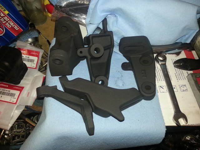

looks like i ran out of pics. must have been done? i bolted on a couple accessory brackets, tensioner, water pump (nice used one), and some other misc shit... got pissed i cant find my upper alternator bracket i swiped from someone. then gave up for the day.

machine ~ $130  (crank polished/clean/replugged, hang rods)

PARTS!
found these on my doorstep when i got home...

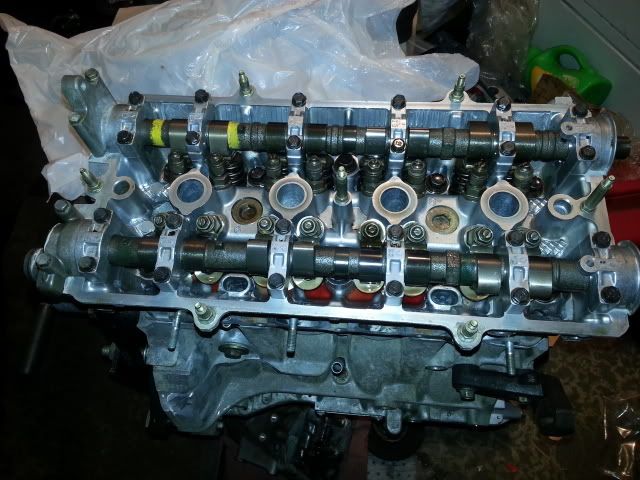

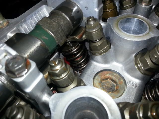

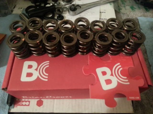

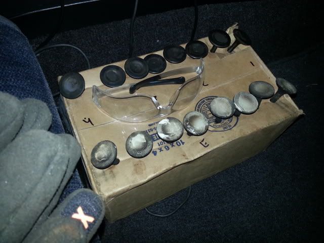

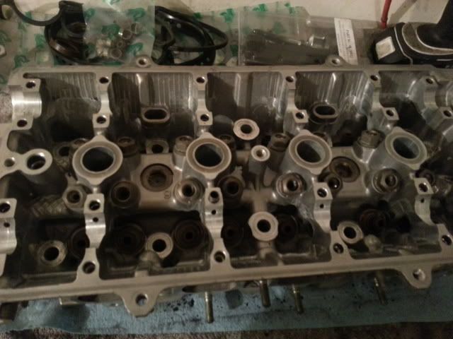

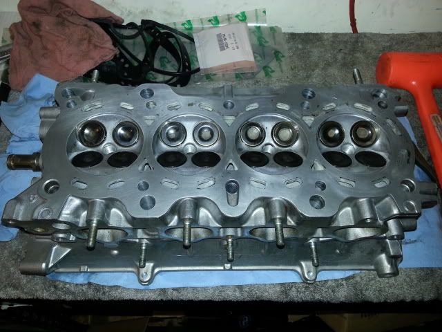

i tore the head down. did little more cleaning. then forgot to pull the valve seals. i hate them. i really do. maybe tomorrow.
all loaded up, with safety gear 8), gonna bring them with me to work and hit them with the wire wheel to make them minty again.
springs where $200
head was free? it came with the block.
see working up to around 1200bucks for a B20 non-VTEC... little bit further...  ::)

opps. went to post some shit up and looks like i forgot to update this shit wiht a couple...
bunch more Honda shit... mostly just hardware. i cleaned a lot in the parts washer, but missing a lot of oil pan bolts, nuts, etc... so i bought an assload of 10mm headed nuts, 12mms, and 14mms. always seem to need more, and spend too much time looking. and looks like some 10mm (actually they are threaded like 6mm) bolts for the pan also.
what else is there... oh oil orifice thing. threw the oil on away, was worried there was bearing in it. new bypass hose.
like $30
got the head together.... look at one of my other posts (ek) and it has me using the Euroxport valvespring tool, lapping valves, etc. same deal.
Brian Crower "BC0021" cams. stage2 turbo cams... thats the reason i spent the extra bucks on matching springs.
think i won these on ebay for like $235 shipped
double springs. bigger bumpsticks.
all ready to rock.
 :Jew:

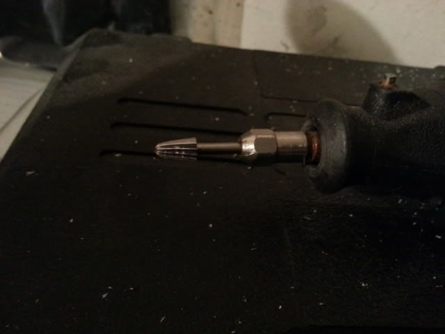

i dug around for my cheap knock off dremel...fucker didnt work. dug around for another still a knockoff, but craftsman still iffy (why i bought the other one i think) but worked ok. used a couple different bits, but this one was cutting threw pretty nice. then i hit it with a 80grit flap wheel (both dremel brand)
cutter
checking my work...
after a finish pass with flapper wheel... also made a pass or two real quick up the runners.... but the craftsman was getting really hot.
oh right...

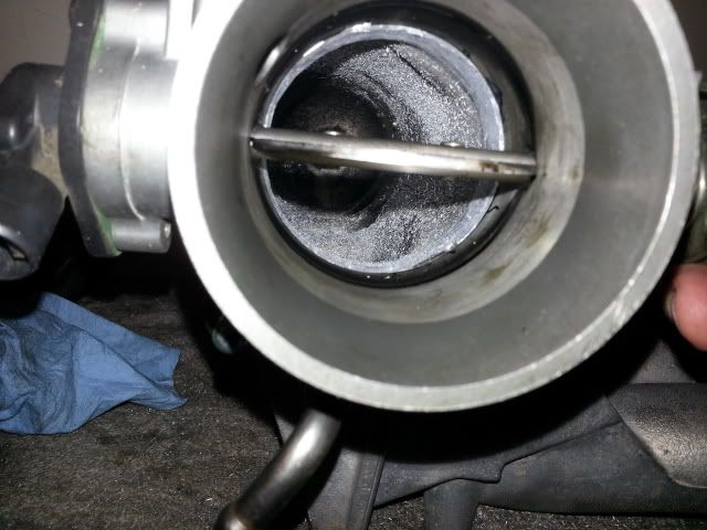

this is what im porting... OBD1 P75 intake manifold... i bought this on a package deal, sold it to this kid, then i made him give it to me when we traded cars cuz he said he still had it (took sensors and shit off it)
so this was $free$
need to port the manifold cuz...
Professional Products 65mm throttle body. went to help a buddy buy a turbo kit, he bought a new intake/tb/etc. and when i went to help him install it he gave me the old shit as payment? whatever. turned out to be this...
so...$free$
so didnt do much i know. but i think im gonna get this ready to throw in soon. might not be boosted... it may be... not sure yet... working on some life details...

so i think i have collected all my engine brackets...
so i cleaned them and painted them all the same color. some had OEM coat, some had nothing/slight rust.
i will be running AC and PS... so i hope those are the right brackets, i bolted them up, so should be legit lol... P54's on both if anyone can confirm?
oh yeah ,so i dont think i have pictured of all this, but i have been looking for a transmission for this car. back and forth on pulling the B16A trans from teh car (perfect condition). but i wanna have the swap 100% ready to swap in. and was hoping to run an ITR LSD...or maybe MFactory. looks like im going ITR though.
buddy says he will sell me his parts tranny, he is all iffy, back and forth, no price, etc...
another friend of ours tosses the diff out of his case. some back and forth, he buys a tranny from a friend. he kept saying he was going to "rebuild the tranny".... yeah, right, you said there "where gears in the road"...no rebuild.
told him i would give him nothing for it, that i wanted it, i would pay for his time. i finally got it...
talked to my other buddy, got a price range... oh yeah, was told that the tranny was "probably a B16" and that it was missing one gear, maybe grinds, idk.... anyway took that one too.
got them home, took them both apart. counted the teeth on the ring gears... 64 teeth, BOTH non-vtec transmissions.
FUCK  :evil:
says he has another tranny, has no idea what it is... take it apart, lmk. we will work out a price....  :-\ :?: :evil:
i go there, take it part right there. 66 teeth = win...... had broken case, i told him i would give him 50bucks, so he just sold it to me for $100... then he jewed me on some engine mounts (ill post later).
long fuckin weekend of transmissions being pulled apart...
S80 B18C1 GSR gearset  :noel:
yeah, broken... i have the pieces, but have decided against welding it for now. im gonna use case from trans #2...
good 94-95 inner case, 94-95 and 96-01 outer case.... gonna bring them to work to clean. then i think im going to mix/match them for my trans. the 96+ has mount studs and the 94-95 is missing vent tube.
why not? im gonna have to re-shim everything anyway.

notice anything odd on this one? i had to do a double take.
What kind of fucking idiot cut that bracket??
Oh well... me  ;DDD but the ramhorn is front so it's not the same.
Re: build #249.....DC4 > EJ..... MOTOR BUILD IN PROGRESS!!! :)
« Reply #22 on: March 18, 2014, 01:30:49 AM »
well boost is more important that that stupid bracket... but he just didnt even look for hte right one? boost > vtec....
« Reply #23 on: March 18, 2014, 08:36:13 AM »
I can't disagree with that.
But you know, it seems like there's a lot of stupid people working on cars. Like on my Eclipse GT. The guy installed some headers, ebay's I guess, and the ports of the headers doesn't line up with the port of the head. Result? 1/4 of the exhaust port was in the way of the flow.
You can install cheap stuff sometimes, but at least don't loose power when you do so...
