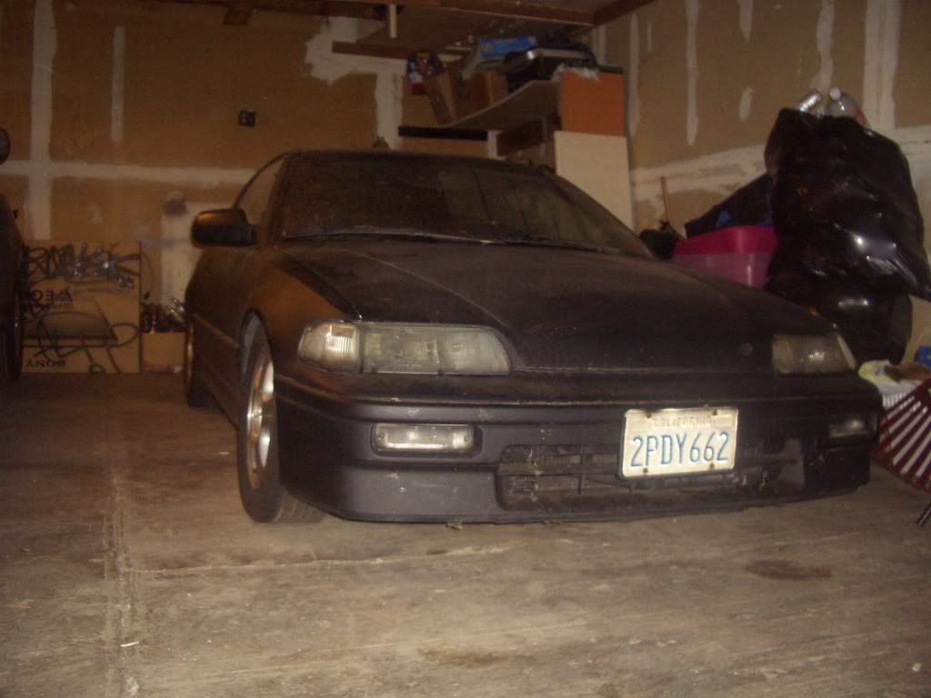

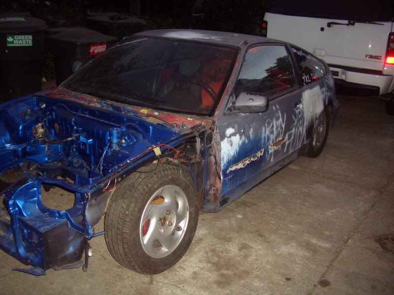

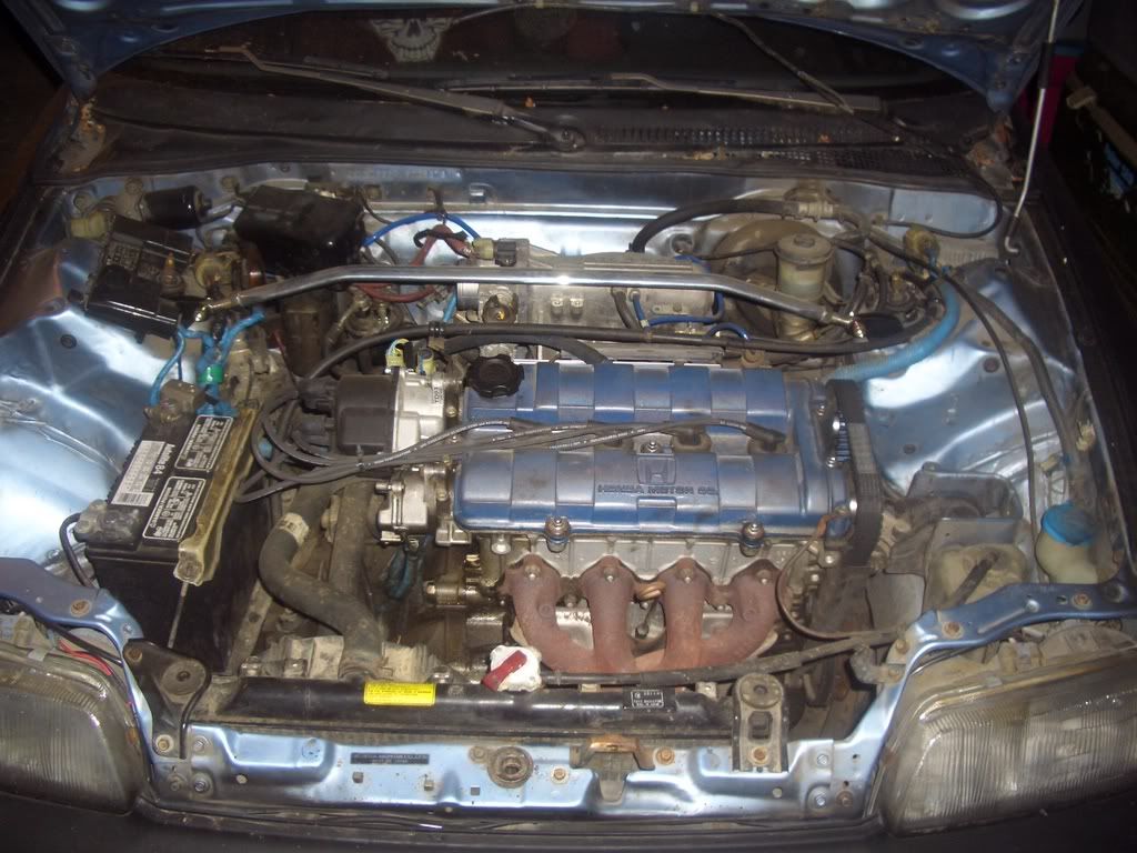

here is the doner vehicle.  I bought this shit all stock a long time ago for $300
thats how it sits right now.

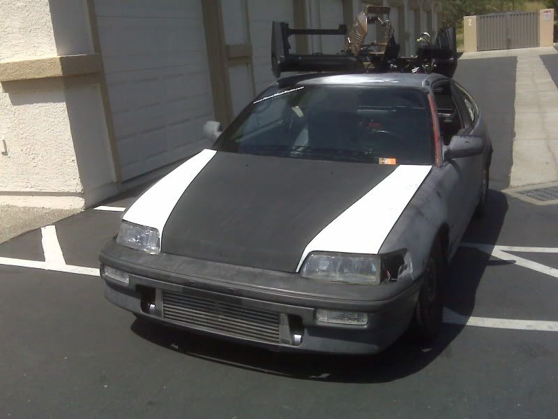

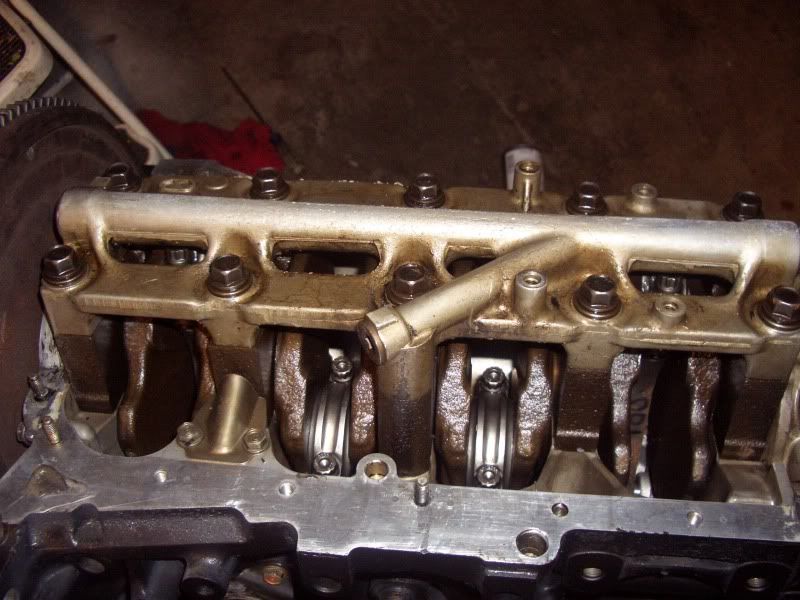

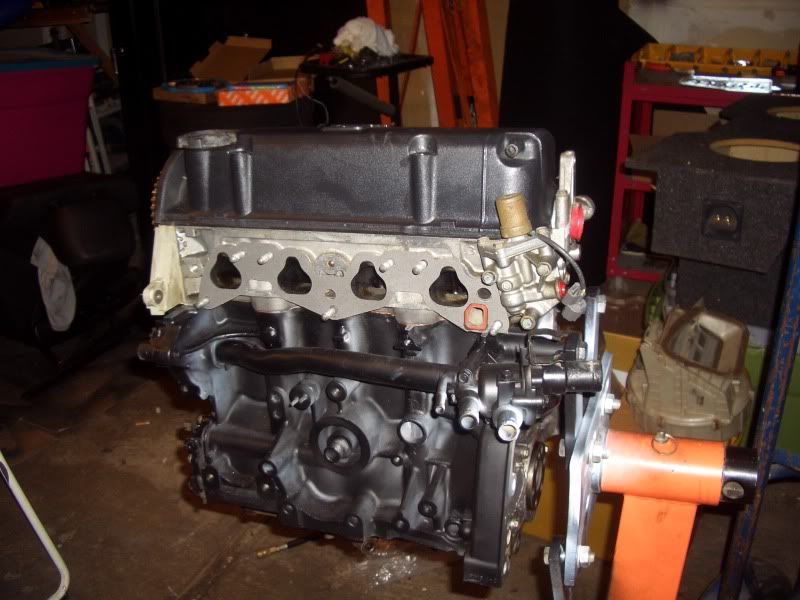

here are a few pics of when it was last running

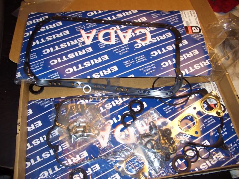

the e bay gaskets

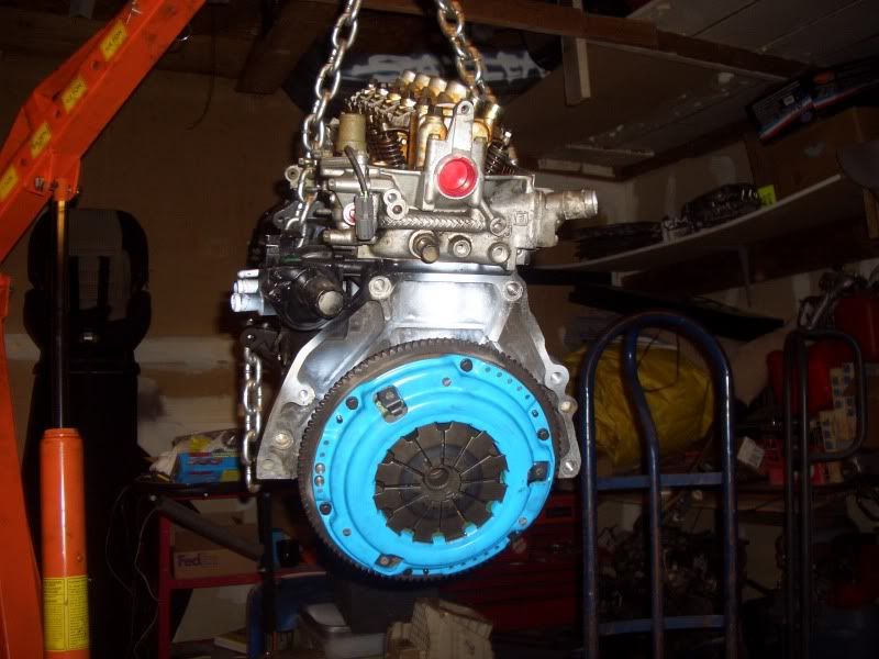

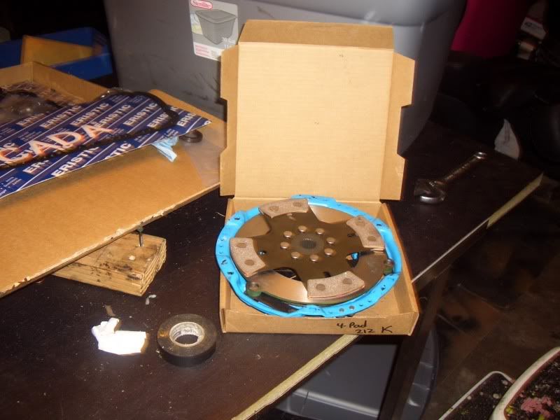

Galaxy disc with pluto pressure plate

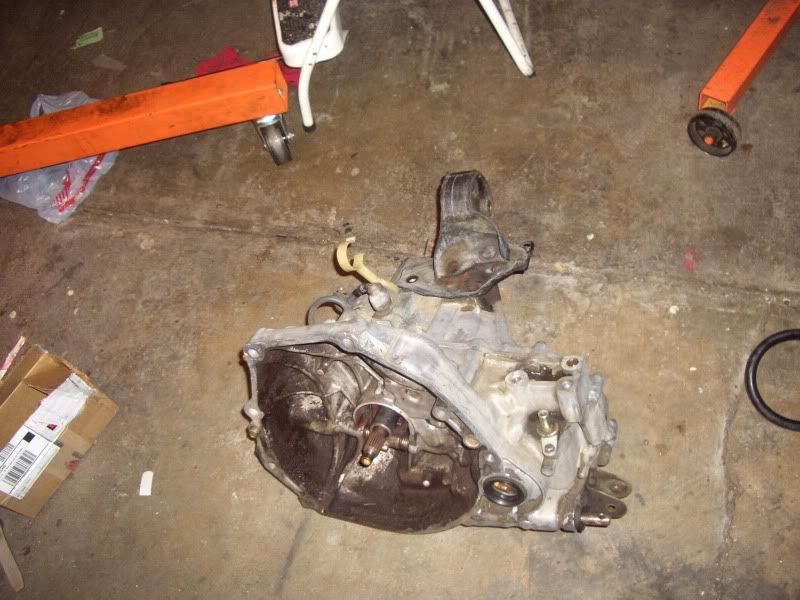

88si trans i scored from chris for some tasty lumpia that i cooked for him.  i even got personal delivery.  This nog is top notch

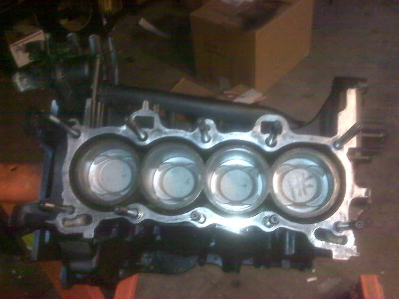

vitaras in FJT I beams compared to stock

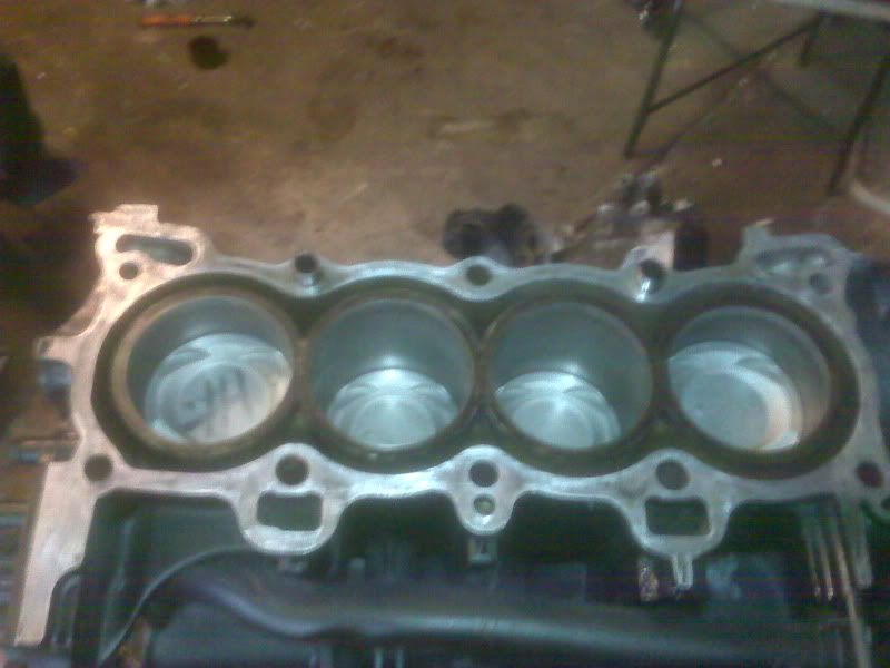

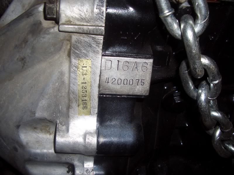

the a6 big block!
rods look good

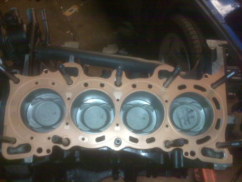

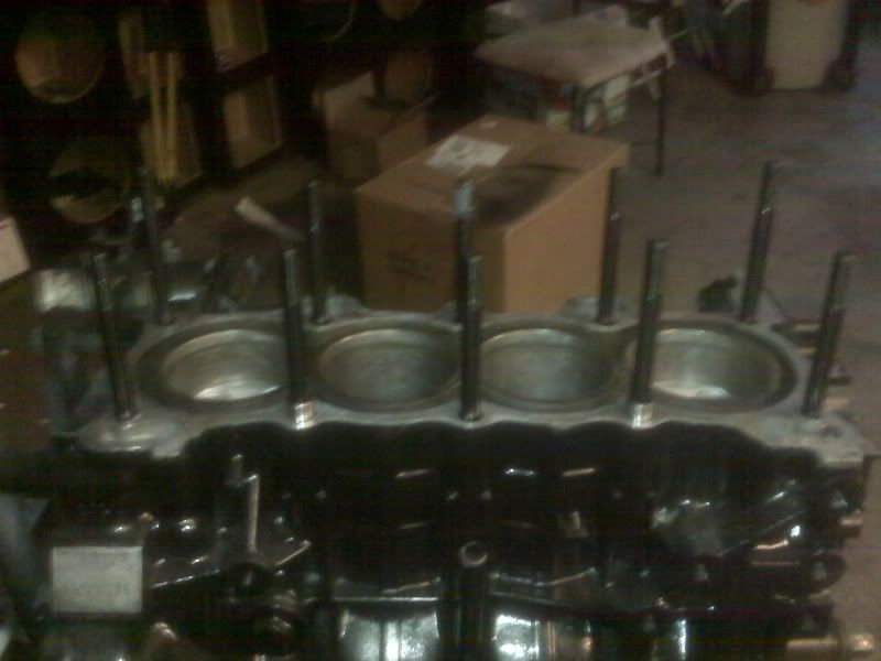

copper sprayed hg

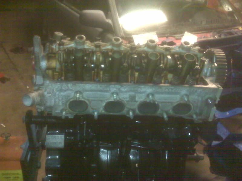

y8 meets a6

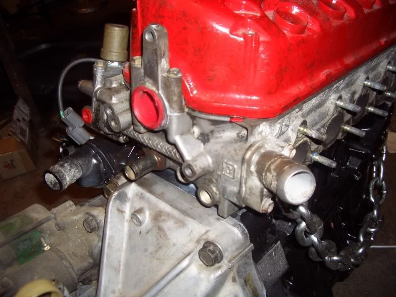

pic of vtak solenoid
clutch on
misc pics

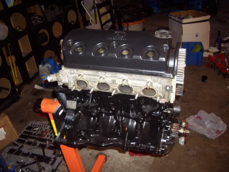

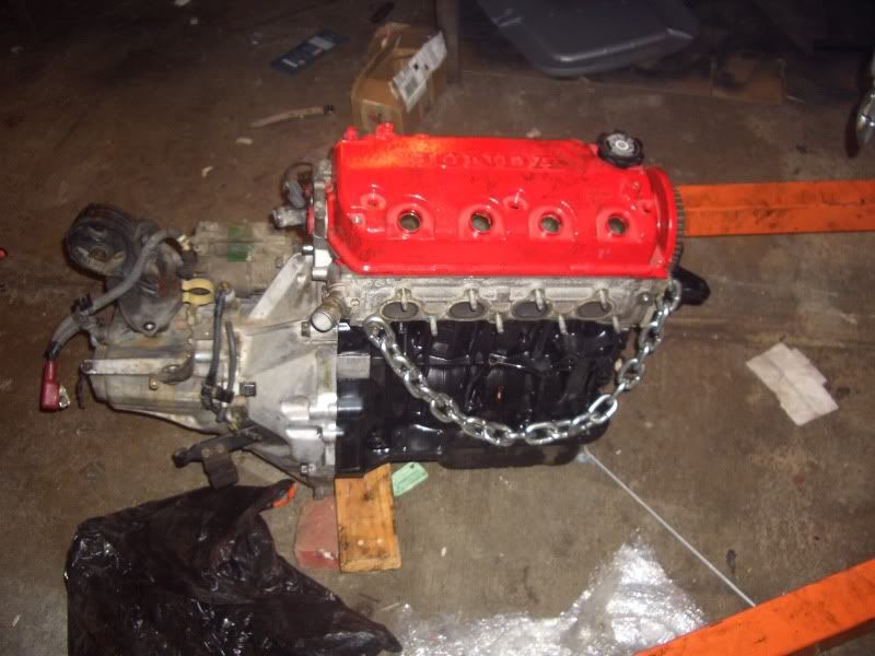

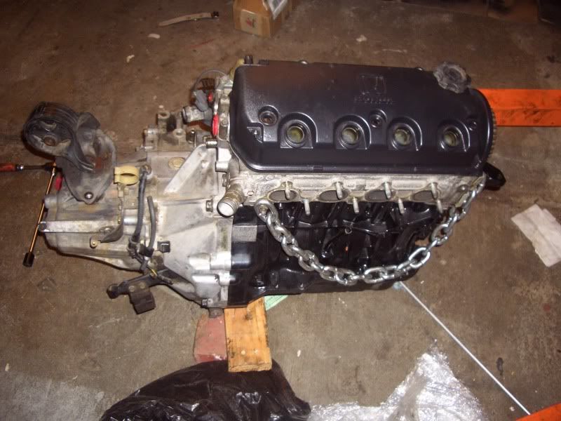

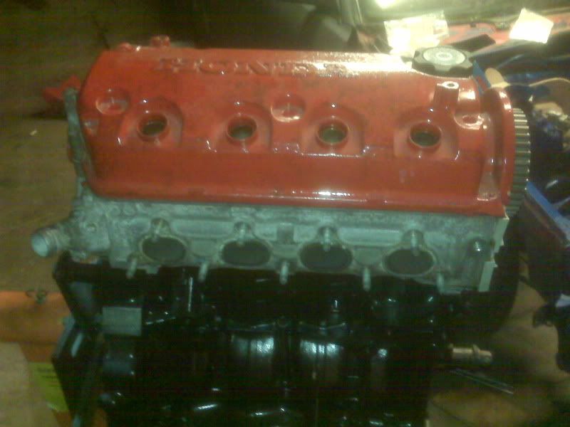

poll will be up about the next 2 pics.  which valve cover should i use?

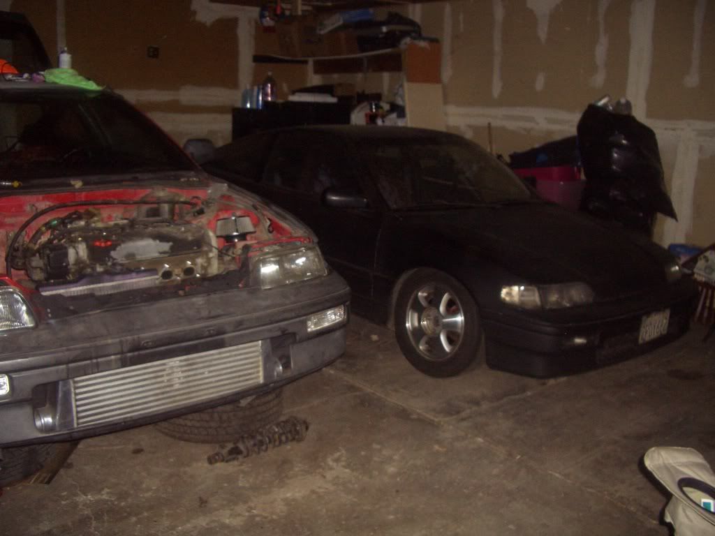

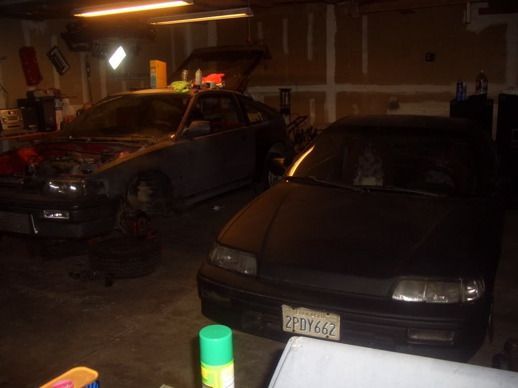

the garage before

Looks good. ZC
Looks good. ZC

gangsta.... black cover wins
Word. Shit is ganster. Send me the motor? :)
You should paint the whole car black. Rattlecan that bitch. And Fuck your stripe  O0
« Last Edit: May 30, 2009, 06:41:02 PM by glustic »
90boostdaccord
  • Posts: 4637
black cover.  shit is looking good.

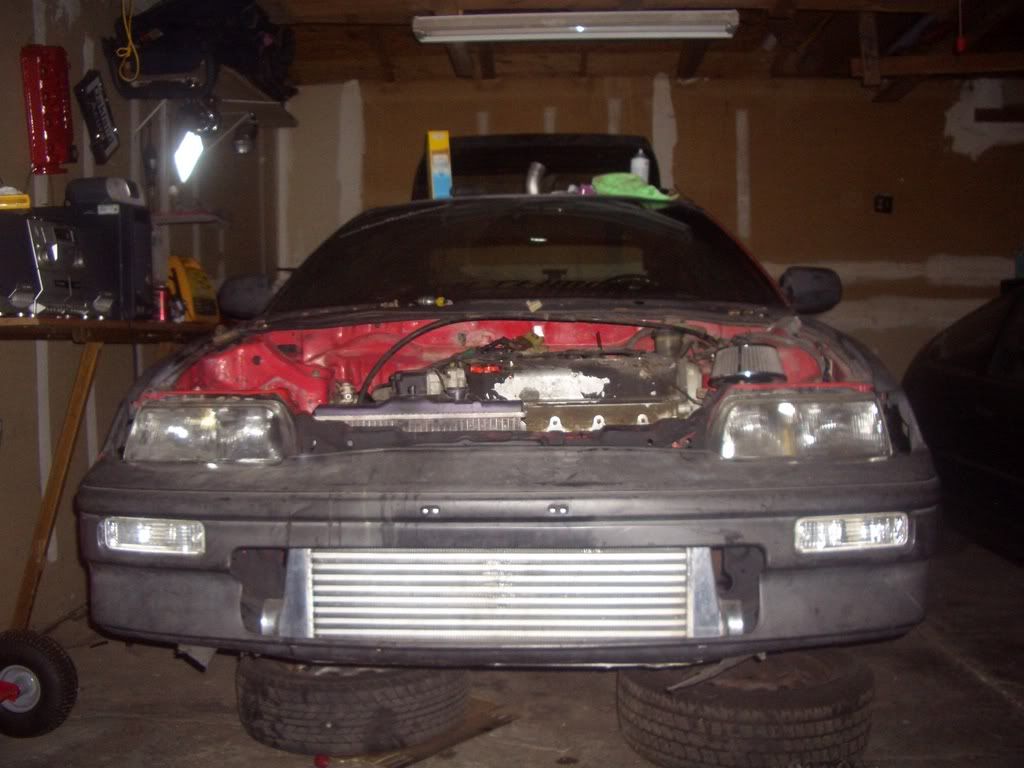

alright motor is in.  intake manifold is not on.....im still debating on using the y8 intake mani.
i just need to order a log now and a few things here and there...

the intake mani gasket that came with the kit didnt fit too well and the ports on the gasket  were screwy and blocking the ports partially on the head.  I just had to order an edelbrock intake mani gasket for a y8 part number 15005 from kragen for $6.  looks like a decent piece.

I like how the car has about 50 different colors of paint on it. True  O0 build
thanks.  we used it as a grafitti wall for a year.  the body work will be situated after everything is finished.  Paint will be flat black.
isnt the paint under the hood sexy?
Would have been if it didnt look like widebodys dash....
