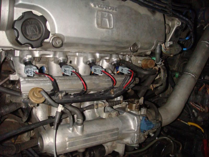

these came in the mail today :)  somehow the 4bar map didn't make it, but i'm sure it won;t be too far behind.

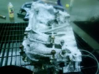

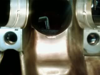

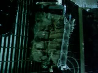

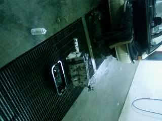

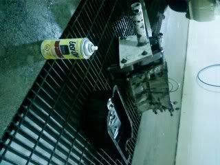

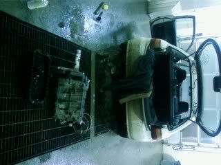

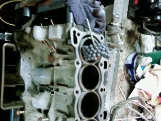

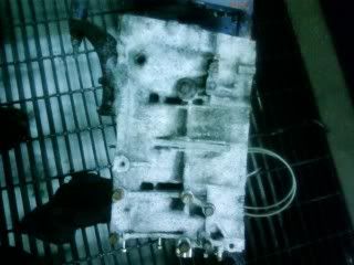

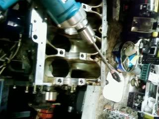

found some pics of the ball hone and carwash hot tanking
oven cleaner does wonders
I think this notch was opened up a little more yet... but that's close

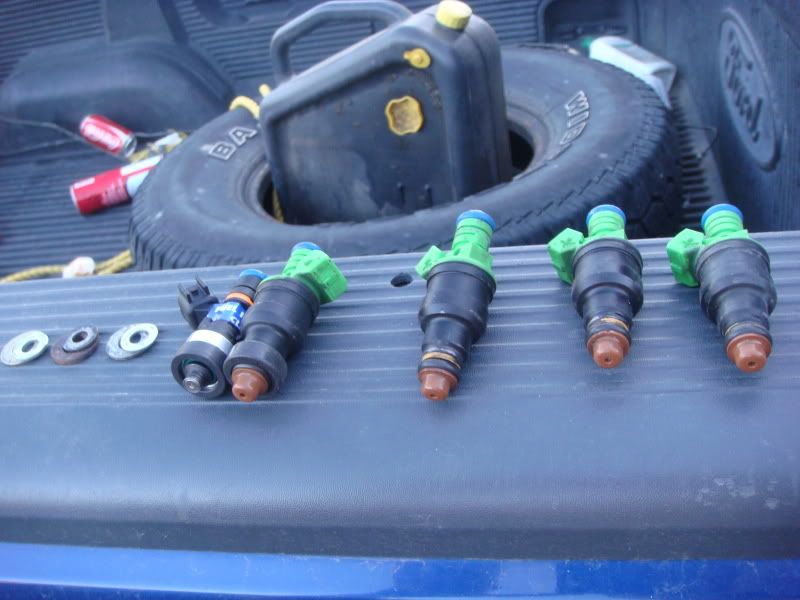

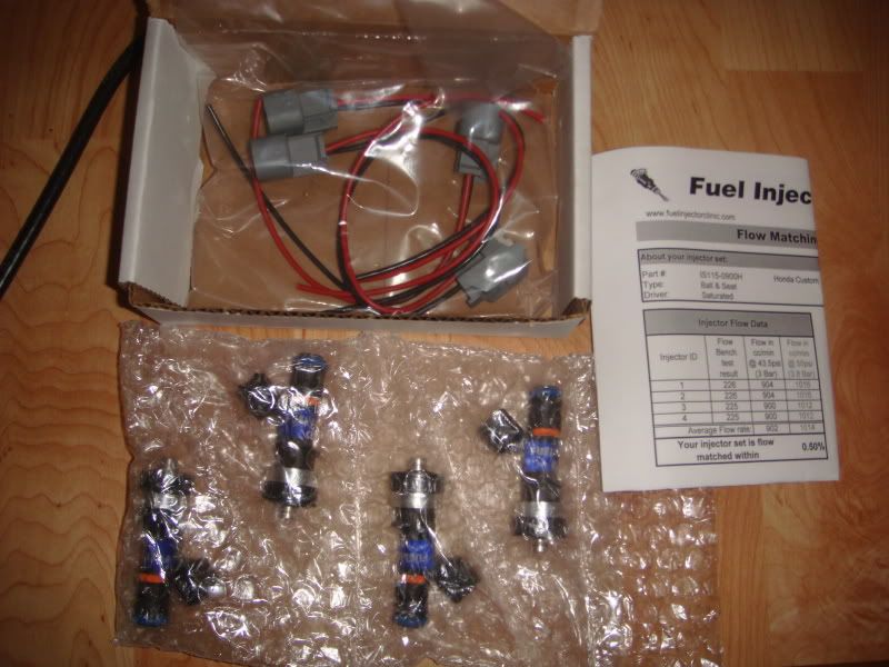

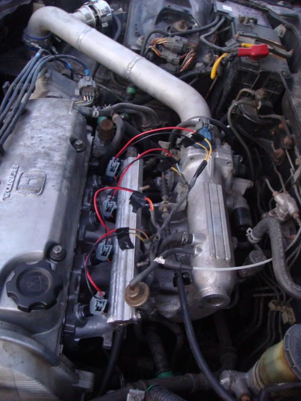

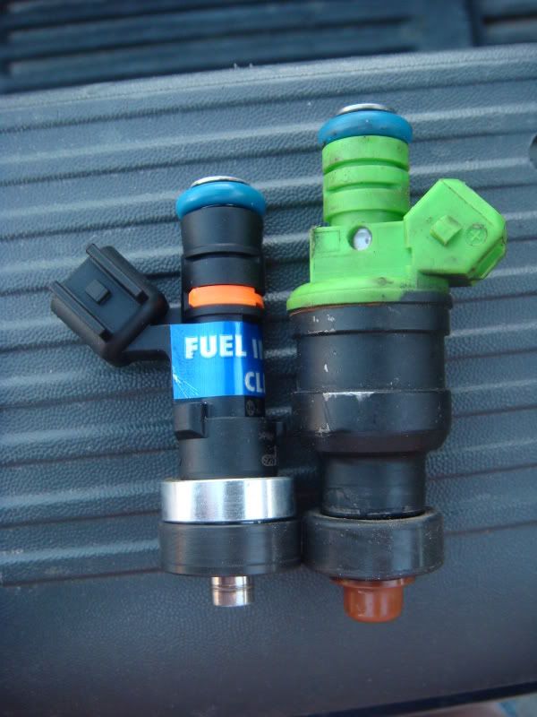

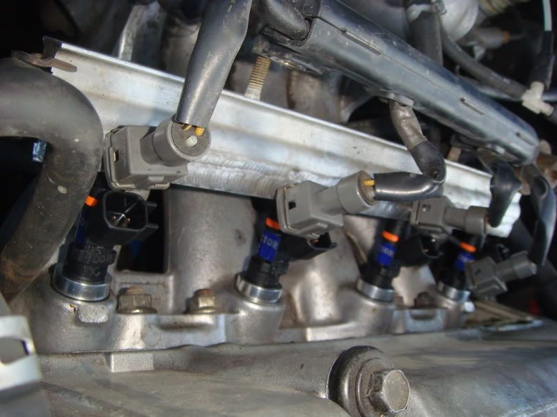

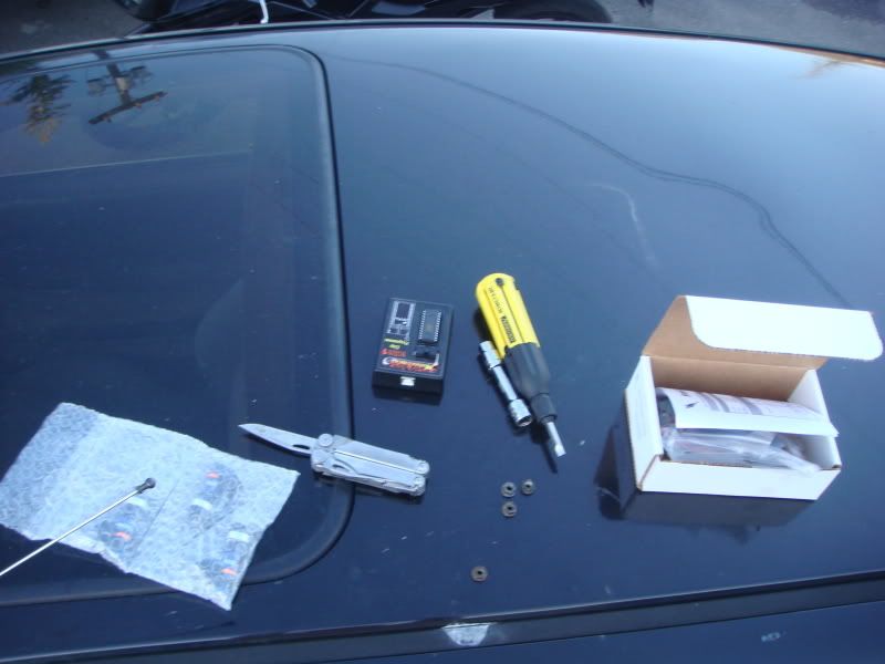

well got some time and since the DD is now down with a wounded trans, shit may as well put in the new injectors ;)
injector comparison... id 1000(i think they're actually more like 900 at stock psi) and bosch green tops
Tools
Temporary ugliness

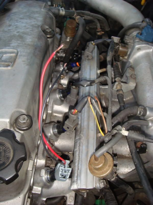

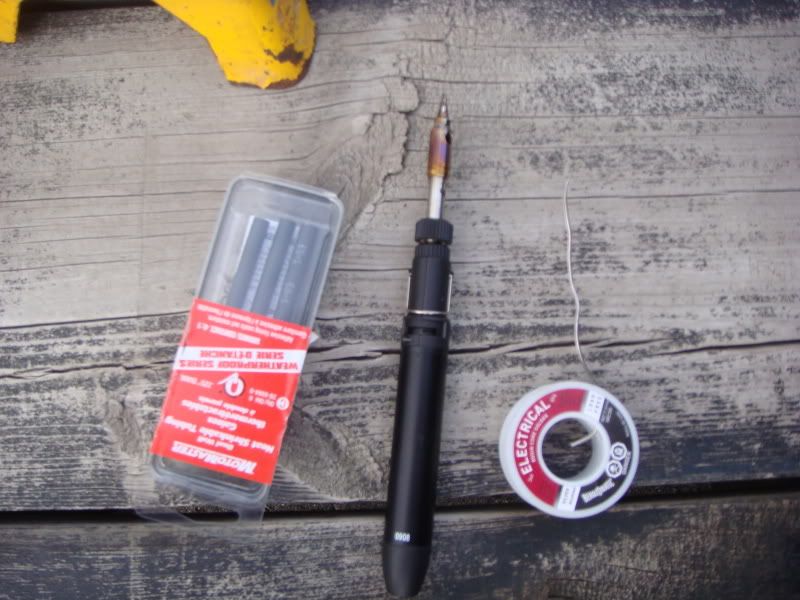

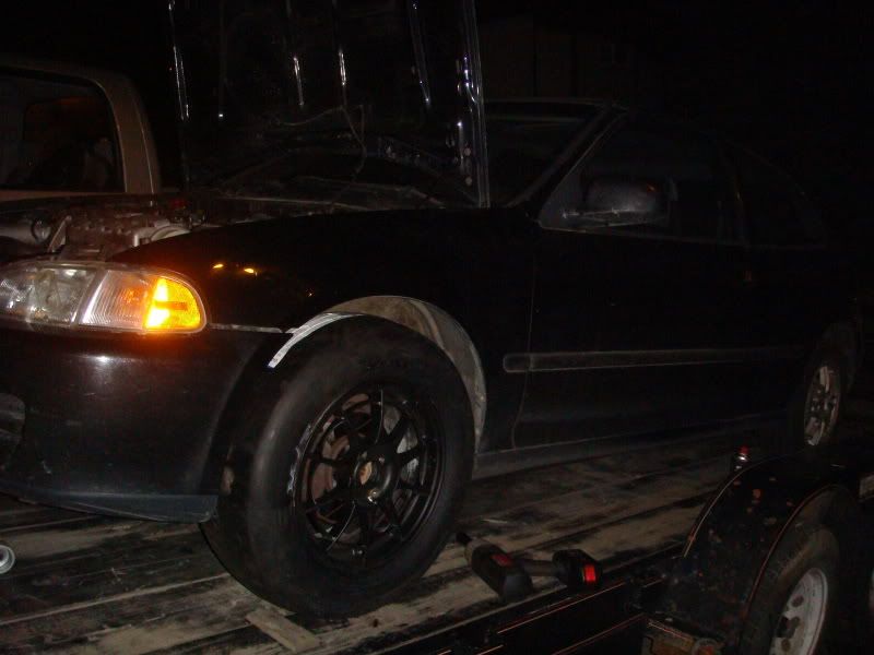

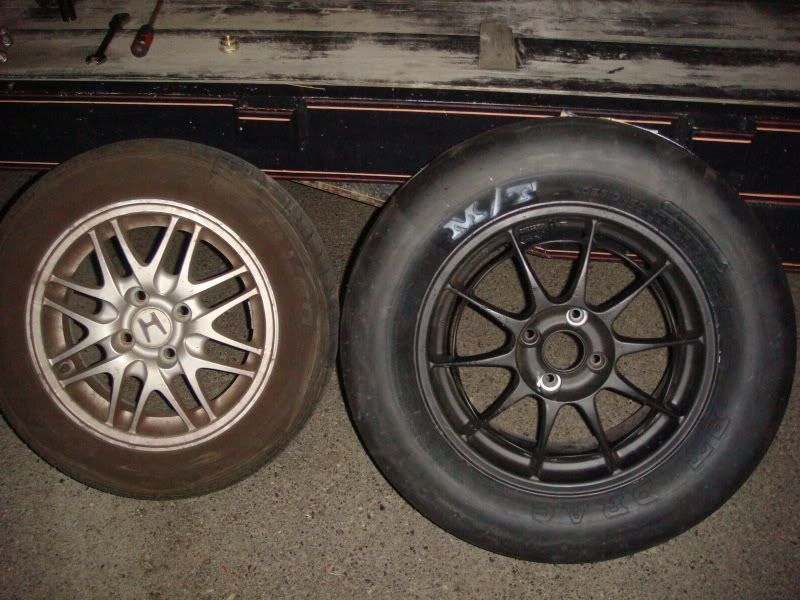

- injector wiring to final install state;
- slicks mounted and test fitted;
- axle out for use as alignment tool (see below O0)

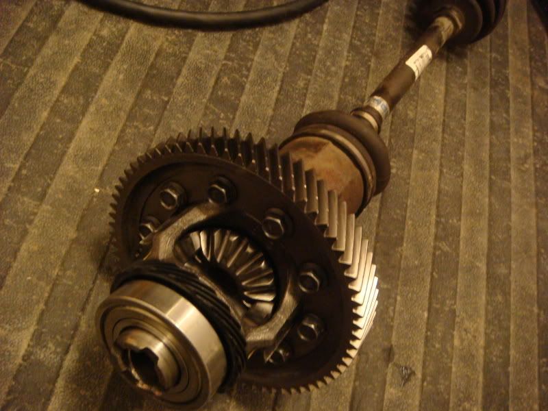

then went inside and did this
Re: Trevor's Canadian D Build saga now with ID 1000's :D *updates 7/27/09*
« Reply #76 on: August 11, 2009, 12:28:46 PM »
What exactly are you welding in the diff.?
I assume this would make both axles full engaged at all times.
This car only being used drag racing or are you planning to DD this?
Wouldn't you be going through tires when doing a lot of turns?
trevor72
  • Posts: 467
  • trevwhore
« Reply #77 on: August 11, 2009, 12:38:22 PM »
spider gears together and spider gears to housing.
