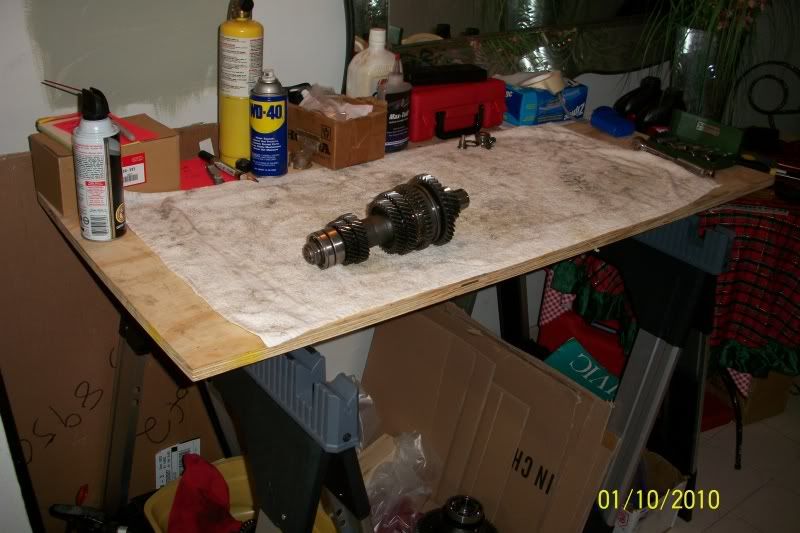

« Reply #95 on: January 10, 2010, 07:52:51 AM »

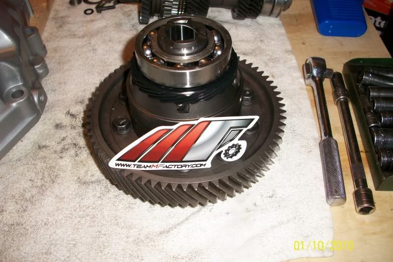

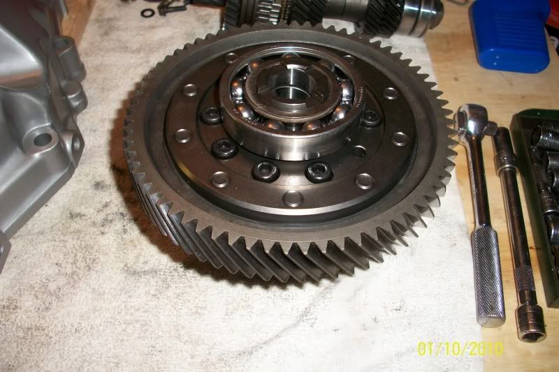

My work table in my warm basement.
Im a neat freak
MFactory LSD OEM bearings

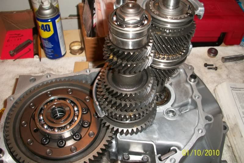

« Reply #97 on: January 10, 2010, 11:36:08 PM »

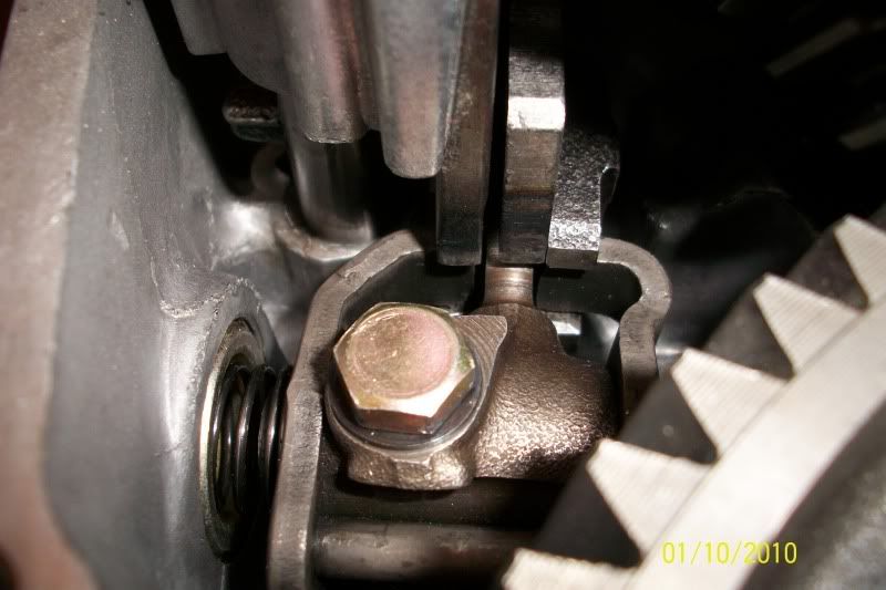

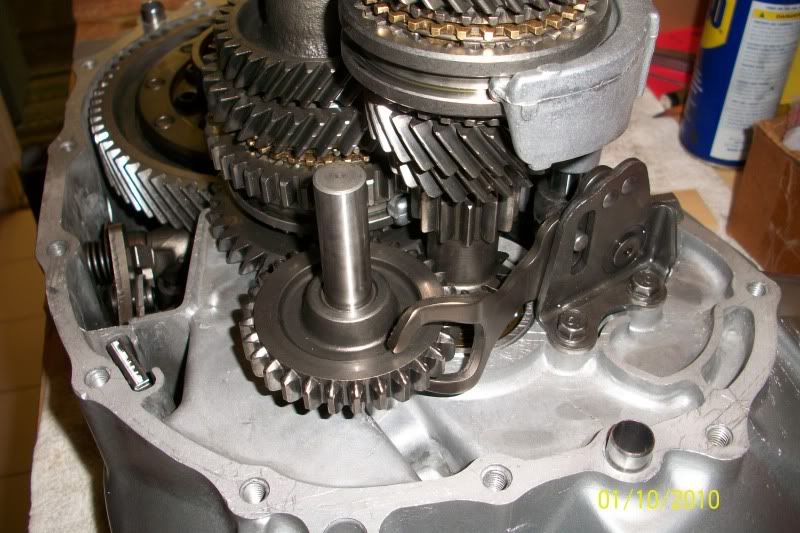

Mainshaft and Countershaft installed
Reverse Idler gear installed
Interlock positioned and torqued

I cannot seem to get an accurate reading for the mainshaft shim.

Ok Im back to work on the trans, all is good. In error I was trying to install a spring washer and a thrust washer on the mainshaft giving me an incorrect reading. the 1989 trans I am using only uses a spring washer.
