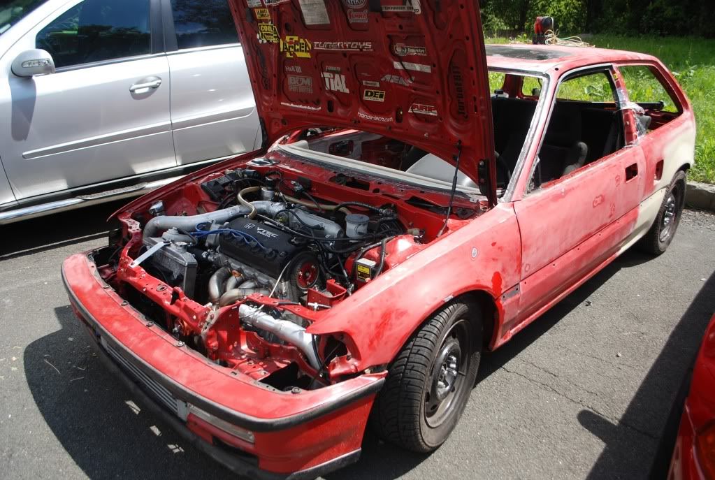

Dynod 360hp at 20psi with the Precision 3431 turbo. 2.5 Bar MAP limited me from upping the boost. Pics to follow.
Dude!  Just make the last scalar really rich and go for 25!

Now that is a sexy mess of a shitheap.  I love it.

might come across as a "shitheap" now but i bet that thing will be PRISTINE shortly

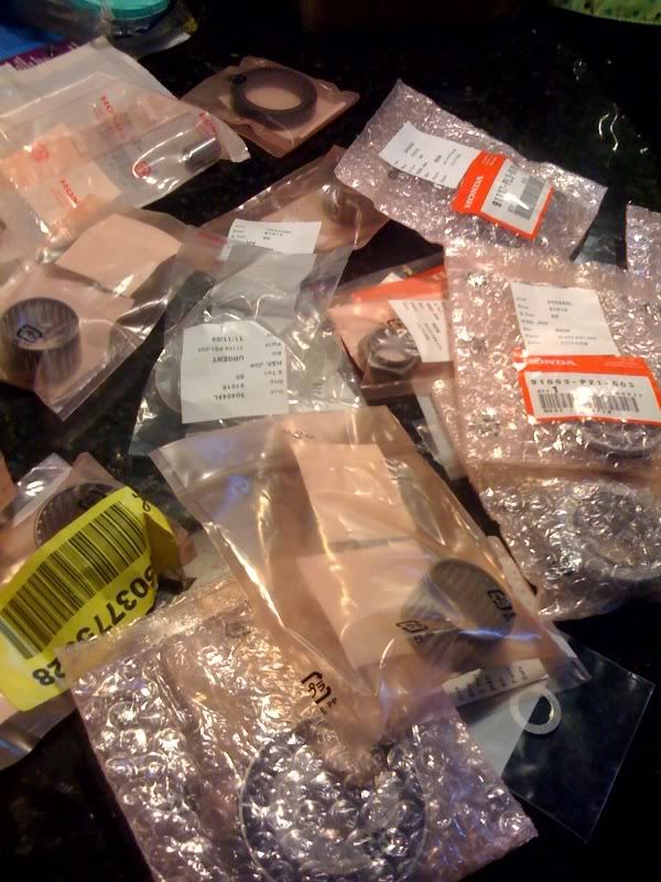

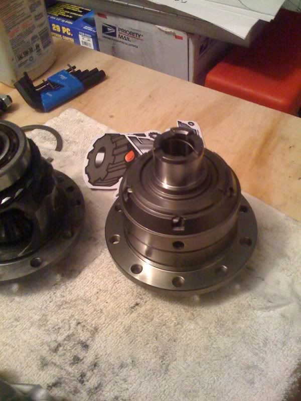

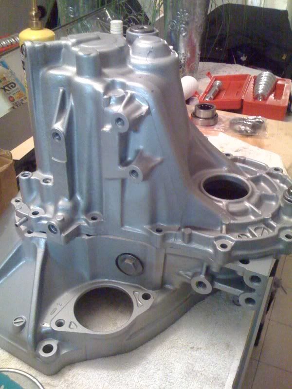

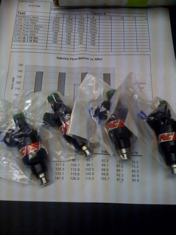

So far I picked up a set of RC 750s and had injector rehab clean them.
I also picked up a used Si trans to rebuild and install a MFactory LSD.
I'm going to get back to work on the body now that it's garaged for the winter.
MFactory LSD
I'll keep updating the pics.
« Last Edit: December 01, 2009, 04:05:11 PM by 1991civicsi »
I'll post pics up later..
How big where your old Rc?
Re: 1991civicsi build thread
« Reply #79 on: November 13, 2009, 01:26:38 PM »
550cc

how much did they charge you for the injector cleaning? Have a set of dsm 450's I need to have checked out.
« Reply #83 on: November 16, 2009, 12:52:36 AM »
nice times!  all these sohc motors have been making some nasty power and pulling so pretty nice times at the track.
Congrats on a well done build thread
« Reply #84 on: November 16, 2009, 10:02:04 AM »
$54.00

  After receiving the diff. I wanted to check to make sure the cover bolts were torqued to spec, so I emailed MFactory.
I received a response to contact Whoopee Doo Racing, which is MFactory's authorized installer. After a conversation I learned that the cover is torqued and thread locked. I was told that some upgraded shift forks are in the works as well.
