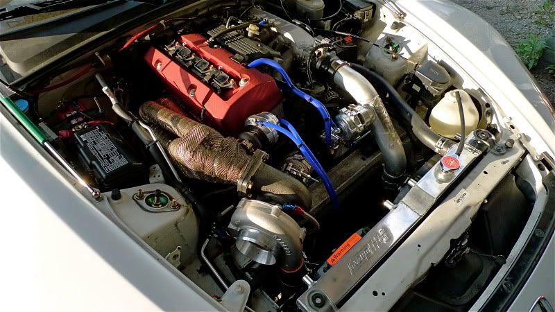

quoted from the owner off another forum:
I pieced most of my kit together some local parts others from the states... ems' are going for a good price these days. My manifold was custom but Aaron @ Weirtech he is a local member he kept the jig of the manifold to build others. No oil relocation kit needed.  Then i had all my install done at Advance Power House and couldn't be happier.
Brian is very knowledgeable with S2000's he has his own turboed one also. He has also has an in house dyno. One thing i really recommend  you get, are the Injector Dynamics Injectors my car idles like stock runs like stock absolutely amazing.
I'm currently putting down 422 at 12 Psi on a stock block never touched, with my exhaust restricting a bit. Over the winter I'm going to pick up the Inline Pro 3 Inch and retune should net my hopefully 440-450 at the same psi. We reached 487 at 14 psi but because of the exhaust felt it was safer to run at 12 for now.
 Brian is an amazing tuner/installer he owns the shop but does almost all the work himself and is extremely patient.
Heres a pic of my engine bay

« Reply #12 on: October 01, 2009, 10:20:57 AM »
Fitment is nice. I would be concerned of warrantying the wrapped mani though.... :-\  That is asking for trouble.  Not so much the welds but the material itself. I have seen wrapped sch 10 crack in the middle of 90's when the EGTs are clearly through the roof! I guess if the tune is on it may not be an issue. Making nice numbers! Having demand for the S2k stuff? Nice to have a jig so you can bang them out. Once those S2k guys see that set I would imagine you are going to be lining them up!

« Reply #15 on: October 01, 2009, 12:09:14 PM »
yeah, i asked him to take the wrap off.  i'd like him to come back so i can make a support brace too.

« Reply #20 on: October 01, 2009, 06:24:58 PM »
Curious... DId ya brace the WG dump somewhere???
no.  it may break down the road.  if it does, i'll fix it.  i fixed my first broken one last week off a jetta, but it was mild steel.

does the wrap really do that much harm to a manifold??
either way awesome work!

« Reply #29 on: October 02, 2009, 04:25:40 PM »
yes it does.  it holds the heat in and overheats the material to the point of structural failure.  ceramic coating will do the same thing if it is not coated inside and out.  corky bell talks about it in maximum boost.
