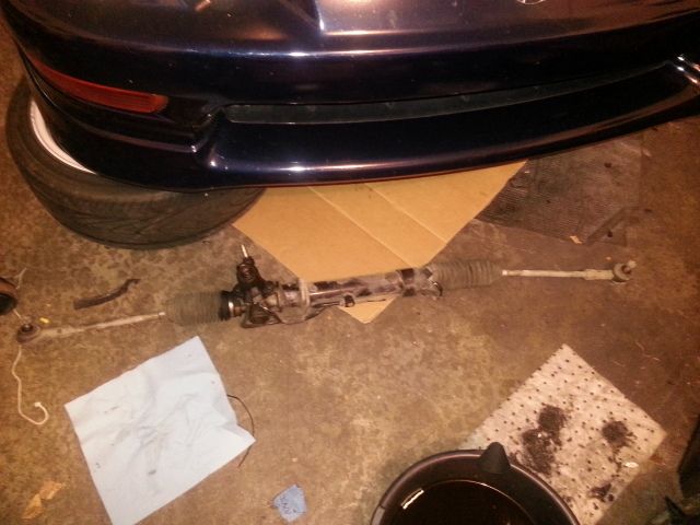

« Reply #164 on: January 21, 2015, 12:26:47 AM »

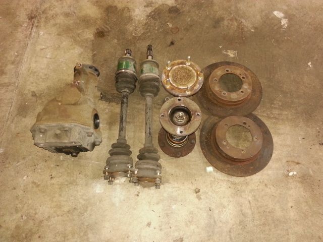

picture update...
rack since mine is leaking...

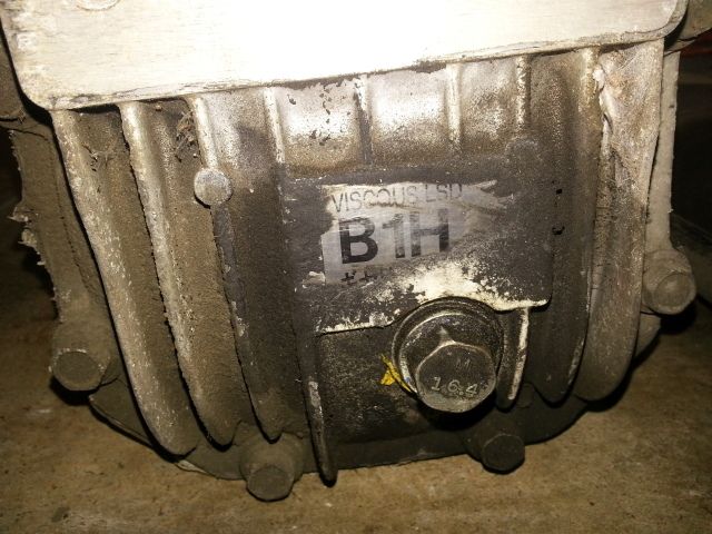

"4bolt" rear axles = stronger that the 3bolts in my car
LSD rear end = spin both tires, duh.
5 lug rear hubs/stubs/rotors (gonna turn the rotors at work) = EVO wheels.

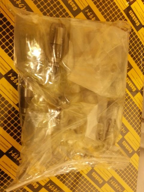

new "revised" style lifters... mine tick and shit, these are suppose to be better
ECMLink v3 = SLIDERBARZ!

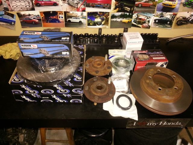

MORE PARTS!
thats my buddies work bench btw. mine is covered in misc H22 Honda parts at the moment.
Centric 5lug front rotors
Hawk HPS front pads
5lug front hubs
new bearings and inner/outer seals
freshly turned 5lug rear rotors
Posi-Quiet rear pads
couple of oil filters from Mitsu cuz i had them on the phone.
i also tried cleaning up the rear diff...isnt show quality shiny, just less dirty.
so i need to order some fresh oils for tcase/diff/trans... (engine only has 1000miles on its oil) i got some washers at work to seal those up. and waiting on my coilovers, and buddy to get some tires for his EVO so i can steal his wheels...

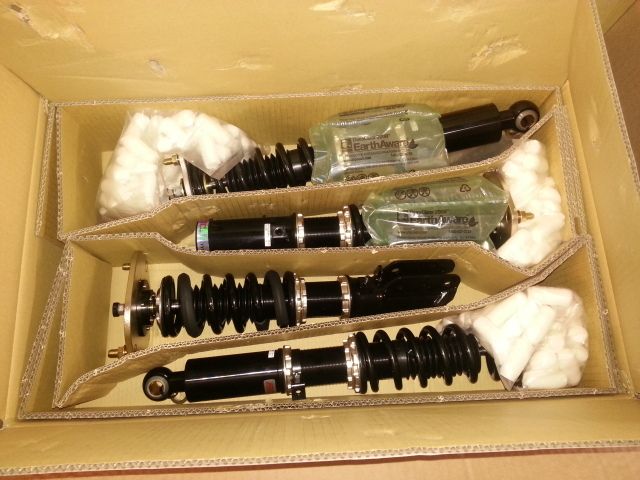

I was so excited did a little unboxing on my desk at work. boss was blabbing about some shit, wasn't paying attention, i was on lunch :P
fresh new set of BC Racing coilovers

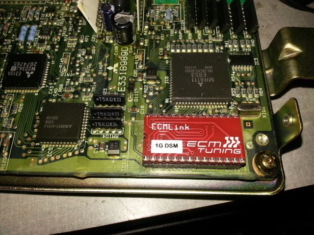

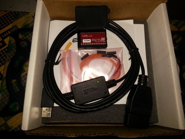

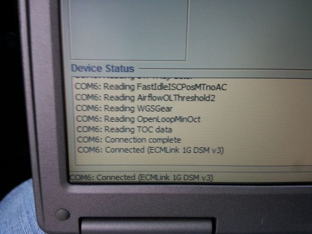

finished chipping ecu. what a bitch. ecu was coated in hardened jizz. I hate removing factory eproms. Weller solder station is giving me trouble and had to finish it off with backup RadioShack unit.
sliderbarz working!! fucked around with it a little. then pissed me off cuz it won't display wideband values, just a grayed out box. anyway cranked right over once I zero'ed the stupid maft box. need to build a speed density harness for it still.
I have a 4bar map sensor and air temp sensor also for it.

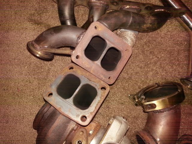

Magnus divided T4 manifold w/44 v-band
T67 T4 .84 P-trim divided turbine
V-band O2
V-band downpipe (probably gonna cut this up)
dump tune for v-band 44mm wastegate

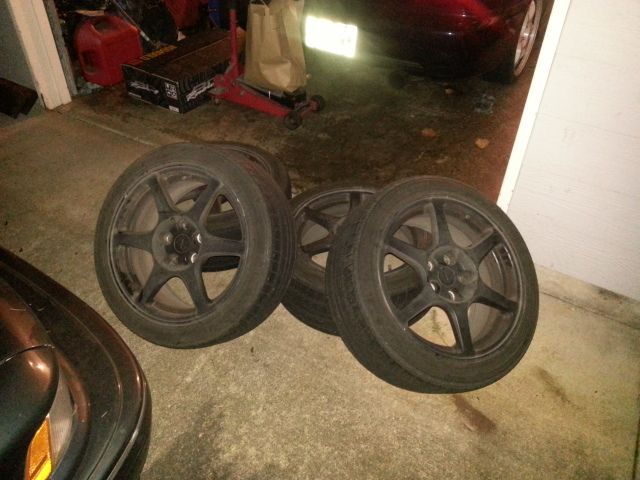

yup, just keep dumping money into this car... see whats up with the evo8 wheels again this week, if i get those any time soon, i wont be touching the turbo stuff for a while. still want evo9 wheels though...

now how do i remove this garbage plastidip shit off my wheels? dont say it peals off, cuz it doesnt. got 20-30mins into 1 wheel, and maybe got 80% of the face done. shit isnt working.  :'( :evil:
Re: 1991 Galant VR-4....forged 2.4L, AWD, etc, etc... NEW BUILD IN PROGRESS :D
« Reply #172 on: February 14, 2015, 05:15:44 PM »
Plasti dip needs a ton of coats for it to peal off. Other wise carb clean blows the shit off quick haha
« Reply #173 on: February 15, 2015, 12:19:31 AM »
I don't want to fuck the finish up on the wheels. I don't like refinished (rattle can, dipped, powder, etc) OEM wheels. so I need to preserve the finish on them.

id the finish is anything like my evo 2 and 3 wheels the carb cleaner wont hurt. they were a factory powder coat type of finish tho. aircraft stripper was the only thing i found that hurt the finish.

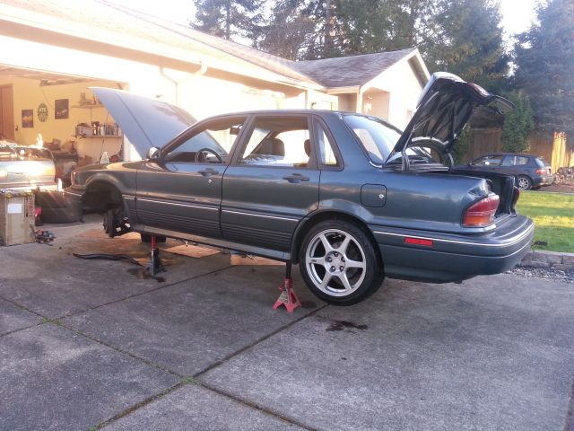

ok let me just say: im glad im only gonna have to do this once. what a pain in the ass its been. the rear suspension has just been fighting me. and thats with not even a single spec of rust.
thats the side that fought the most.

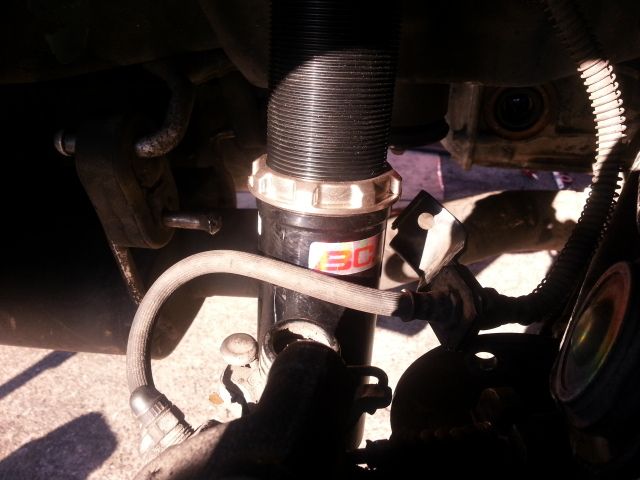

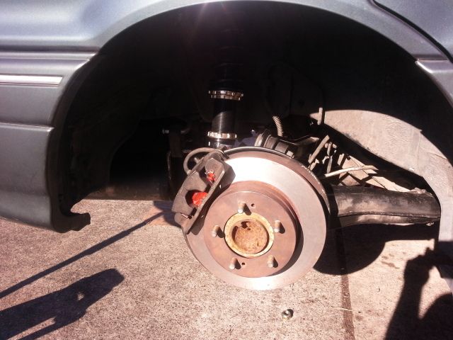

rear is all finished up... 3bolt out, 4WS shit out (annoying), 4lug out (bitch), 4bolt LSD swapped in, 5lug in, fresh brakes, coilovers in, un-ghettofied EVO8 Enkei's...
i tore into the front pretty good before giving up for the night. probably gonna bribe someone at work to swap bearings/hubs for me.... still need to pull the 4WS front rack. then put it all back together again...shit.

ok, front went ok. did get in a little fight with the steering rack coupler. and a HUGE fight with some wheel studs. threads must have been fubar'ed from when the hubs where pulled?? or just to begin with (couple have M's stamped in them). so i antisiezed them and ran some spare random lug nuts (look like steel honda hub cap style) down all them to make sure the threads where good and that they where fully seated in the hubs. ran to the junkyard (yup, it was closer) and snagged up a few and a power steering tank that i now need a cap for.  :banghead:
didnt take any pics of my working, i was too busy working. lol. maybe ill remember to take a couple pics tomorrow when i pull the wheel off one more time.

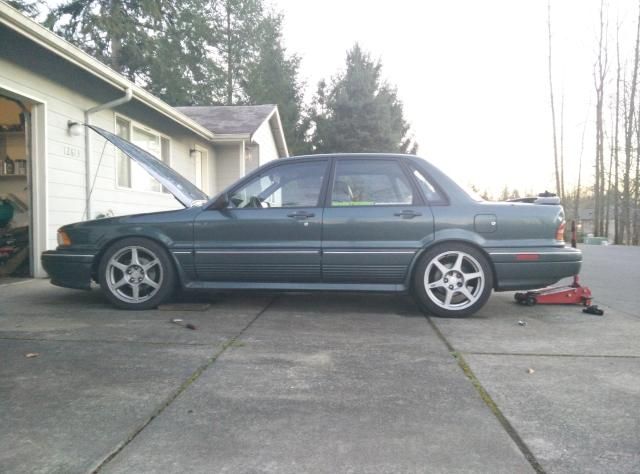

thanks. that was the plan. it is probably a little lower than i imagined, but its got more ground clearance with this wheel/tire setup also. think this has turned out great.
i got her full of vital fluids. went to the JY and snagged a couple cool items, most importantly a PS cap and filter. took her for a little spin around the block, bed the pads in, seems good to go. gonna head up to get her aligned. maybe a wash, take some fresh pics.
steering wheel is WAY the fuck off. lol. like 90* out. sure the alignment guy will love that.
