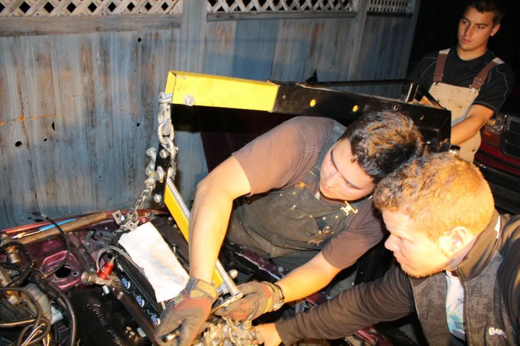

i have been working like a nigger.

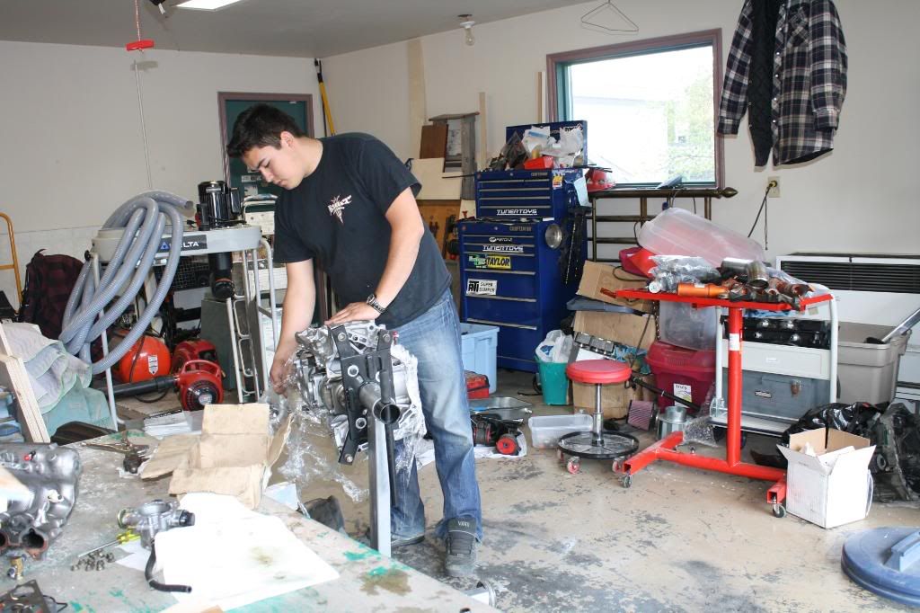

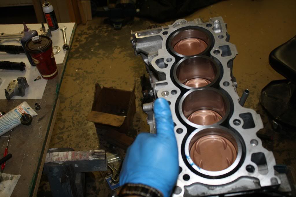

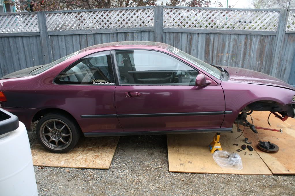

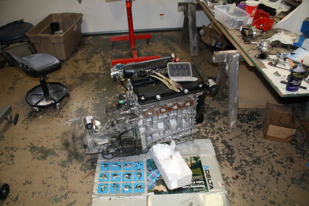

had 2 hrs sleep last night, went to class at 9-10:30 peaced out early then went to go buy some odds and ends. started working on the thing around 12:45. Shit is going good nigga. Prob need some help tonight to throw the thing in the car. Who knows I might man it up or get rachel to help me. I think i jacked up the rear end of my car too much. It went from rally rake to sand dune buggy rake
pics

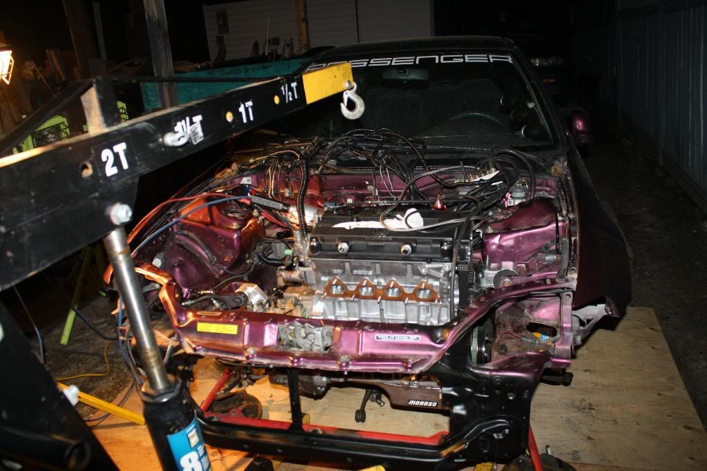

top fuel dragster rake
from this to this in 24 hours
and last but not least

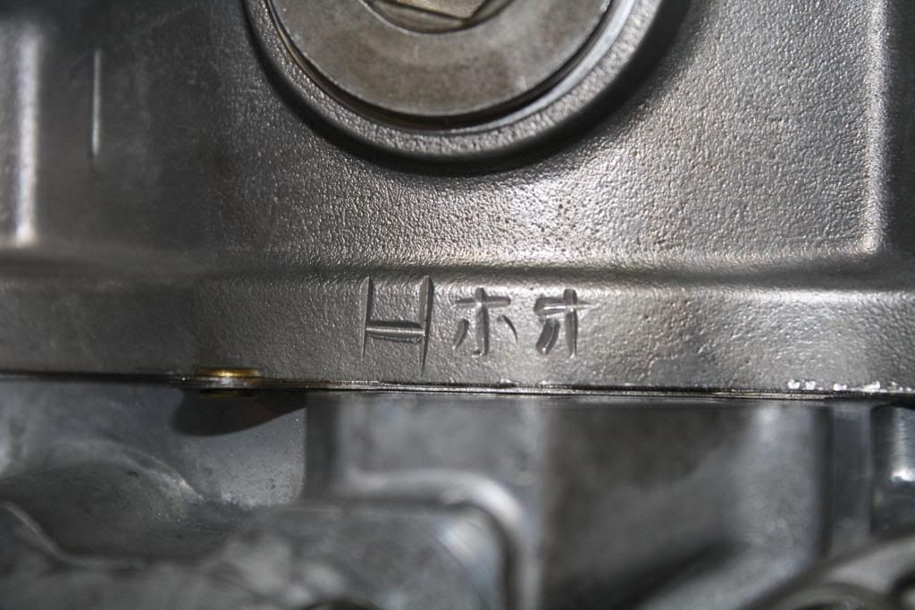

I am so JDM, even my head yells JDM language - Ke Ho Sa maybe?

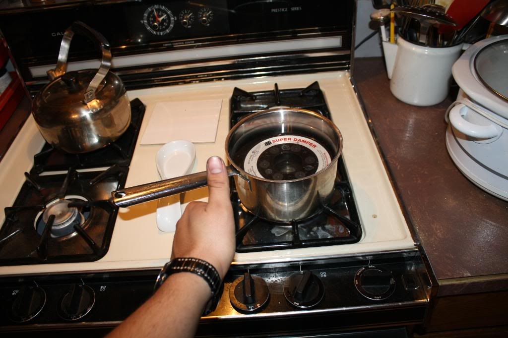

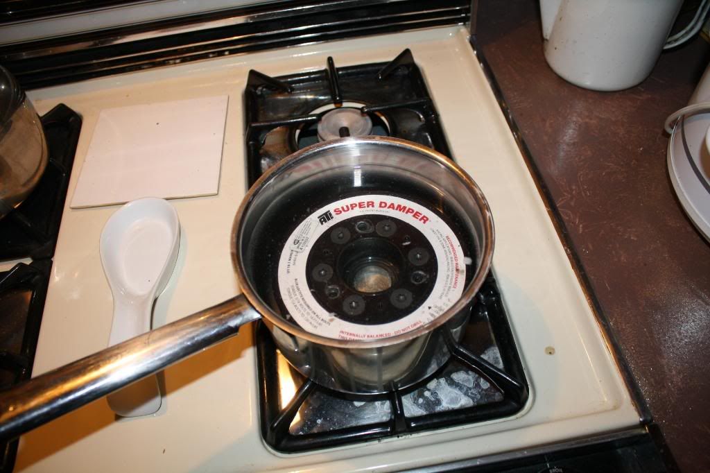

Why was the dampener placed in water?
Re: Urban Indians Re-Rebuild on the HX-52/2.0L GSR - block & head done
« Reply #99 on: May 26, 2009, 02:55:58 PM »
It needed watering, it looked a bit dry.
no just kidding, it was boiling so that the metal would expand to fit onto the crank(press fit turns into hammer fit)

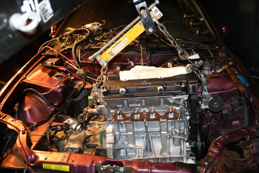

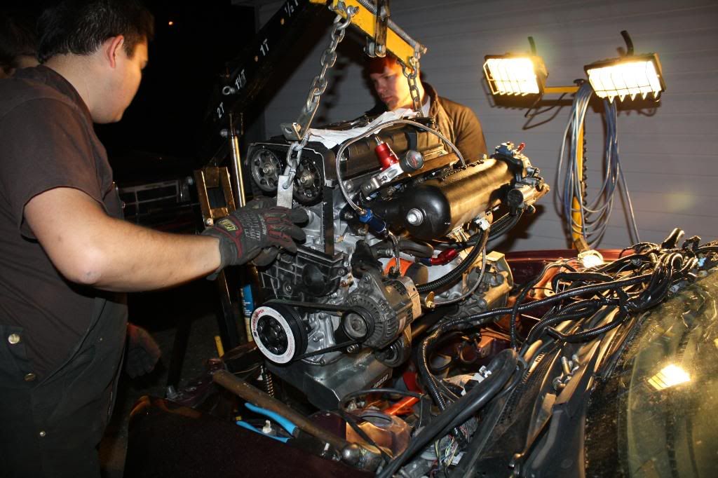

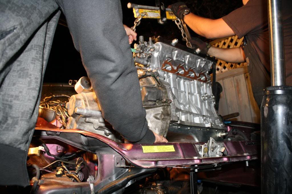

and I am at work till 5 so after that I have Pistol, benny, and lloyd coming to help me. Rachel is picking up parts when she gets up around 330. So that means it SHOULD be running tonight. Persistance is key, everything seems to have went together smoothly thus far. Putting the motor in the car with these mounts was a cunt though.

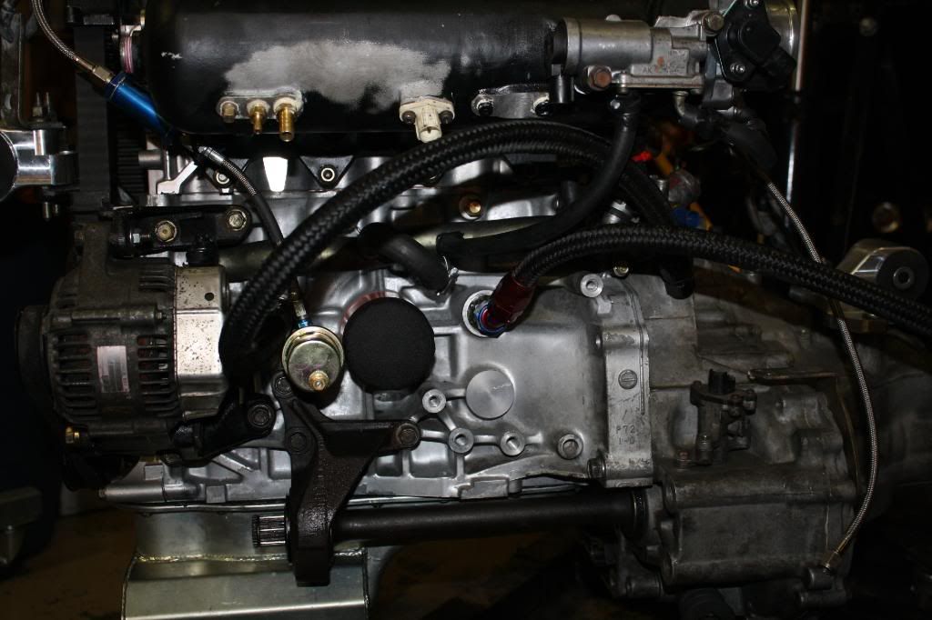

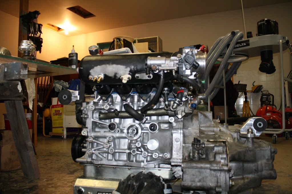

Pics show progress... i'm impressed dude. Good work.

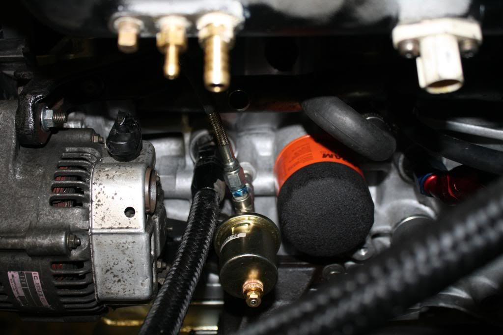

  • Posts: 165
your oil filter tells me you don't know shit about fuck
its my cheapo break in filter, will be on there for 20 minutes.
I run K&N
fuck k&n, fuck fram. get a ams oil or napa gold (wix)
OEM oil filter for the win. If not that then a napa will do.  no fram :-X
the new oem hondas are built by fram  ::)
Does Bosch not make filters for hondas?
Yes they do ive run one
the word on the street is the "new stock" ones are now made by fram and are junk.
negative on the OEM = Fram.
Genuine Honda filters are made by Honeywell (and they make fram, not the other way) and we have been getting mostly Filtech filters. same manufactor as the S2000 filters.
15400-PLM-A02 = Honeywell
15400-PLM-A01 = Filtech (they can and will supersede numbers as they feel like it)
the word on the street is wrong  ???

just got home from levis. made some more progress. biggest problem was trying to figure out how dave got the wastegates on  :somb: but then after levi got the axles in and new spindles bolted up, realised the calipers dont fit. so back to stock axles he goes i guess
one side stock axel is in there. The caliper spacing needs to be another 1/2inch. I got owned after I thought i figured it out.
all but 2 vaccum lines are hooked up, all wires except for one random plug, the distributor is almost totally wires. the wastegates and dumptubes are on and hooked up to vacuum lines.
now need to get 1 brass fitting, 1 platic tee, 1 dizzy screw and find that snap ring off the stocker teg spindles so they can go back together with the stock axels. finish ghetto rigging my radiator then put fluids in the fucking thing. Just got tired of working on the fucking thing in the cold.
good to go for morning
PS got fuel pressure and checked for leaks and I think we are good to go. no leaks !!!!!!
