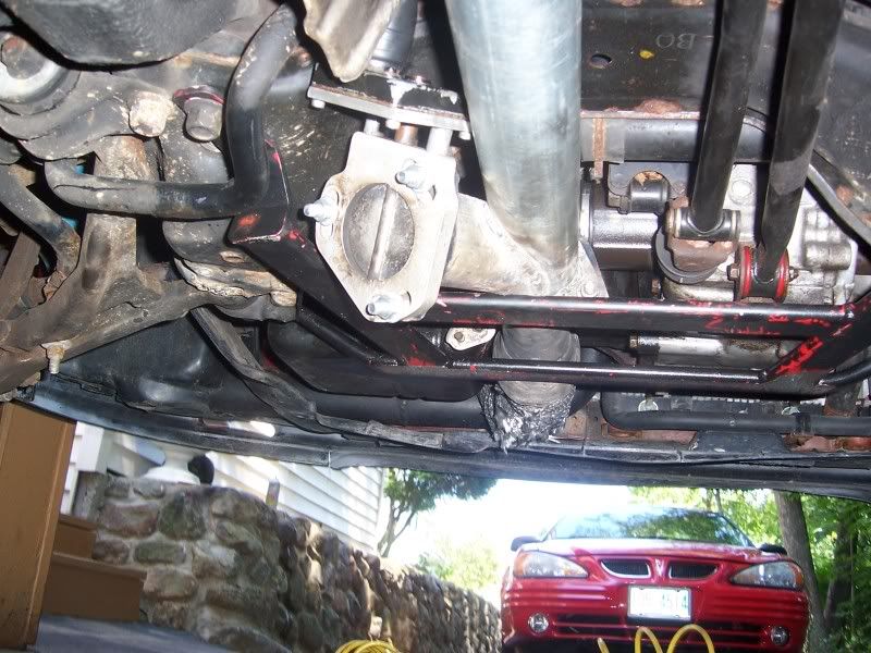

got the bitch lowered and done tonight, small leak in the exhaust :(
helicoiled the cast mani and all is done and holds well, now the DP is leaking :-P gonna tighten the piss out of the bolts.
but anyway here are some shitty pics for the night. better ones going up in a day or two.
the lip is a little low but not to bad. i like the drop. has one finger gap between tire and fender, juuuuust right

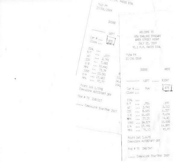

finaly got it to the track, not sure how well you can see but night started with a 2.7 60 and a 15.6 run :-P not impressed, but didnt expect much better since its been raining in NH for the past month.
got the numbers down some at the end
2.3 60
14.8@94
ran into issues thoug, the DP is leaking by the turbo so couldnt log any of my runs, tune consists of 1.15 ignition retard per psi and 185% efficiency, 440cc at about 90% duty cycle at 7000rpm, fully loaded 4dr with spare,jack and extra qt of oil, stock PCV, tire pressure whatever you get from tires sitting in the garage over the winter
ordering some flanges from wier, redoing the DP, removing the super restrictive twin glasspacks that are about 1.5" on the inside and adding and e-cutout
porn to make up for my slow ass times
hope i can knock them down some with the new DP and a half ass tune

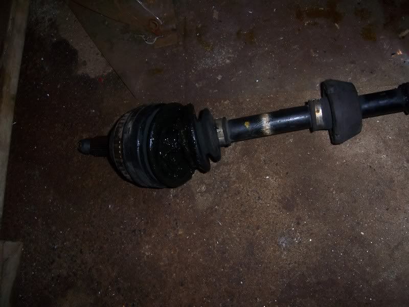

first victim of boost, axle on the pass side. luckily i had extra sets from my other civic
