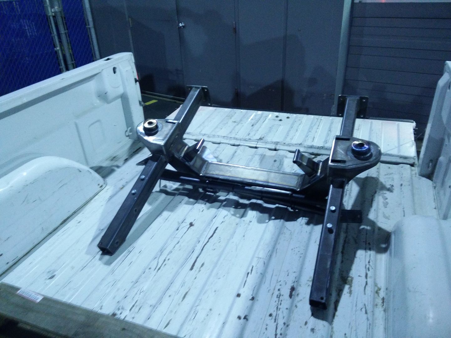

so I had to throw in a special order/request. so my subframe looks like it will be a couple weeks out. oh well. its cold, and I'm a lazy procrastinator. I have to work a weekend coming up... so plan is to maybe tear into her the weekend before Christmas, then I'll have long weekends on Christmas and new years to get her mostly together.
I might even be able to afford most all the parts I need (for suspension) before the end of the year...maybe lol.
Re: 1966 Chevy Nova mordor project...
« Reply #154 on: December 06, 2015, 01:53:18 AM »
so update:
subframe - i asked for motor mounts to be welded on, they are waiting for new mounts or materials or someshit. told them i needed this before christmas.

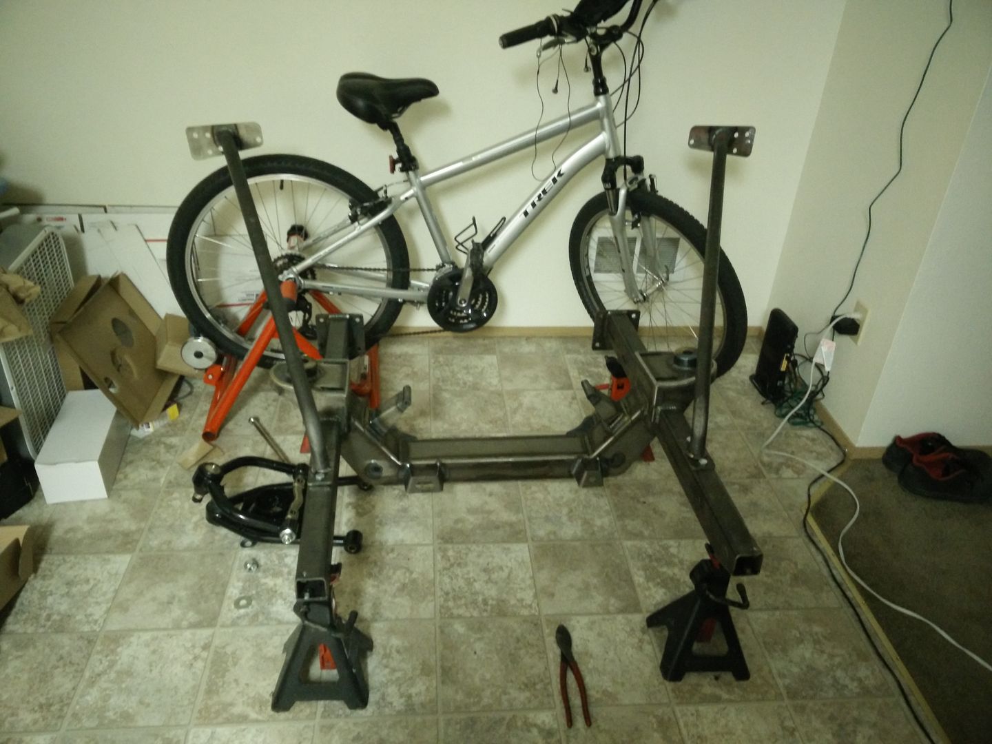

had to set it up, gonna dry test fit everything. the paint it all black, and the suspension shit that isn't black already.
failed to take pics of the suspension...and its all sitting 2 feet to the left of the subframe lol. but its pretty much all the same shit as AJ bought. I have drop spindles and going to be using power steering rack.

oh yeah. so i have been tinkering around and test fitting shit. and the rack has some major clearance issues with the motor mount stand. i have been in contact with Lakeshore and he is going to be sending me new rack mounts out monday  ;DDD  i have been thinking about this like nonstop, and it looks like they are just the wrong mounts, they are suppose to have more of an angle on them. was thinking of just cutting them off and trying to put more of an angle on them and reweld, but me and angles dont work out so well lol. sure Kevin's solution will be much cleaner.
also need to trim down the lower control arm mount just like AJ had to. no big deal.

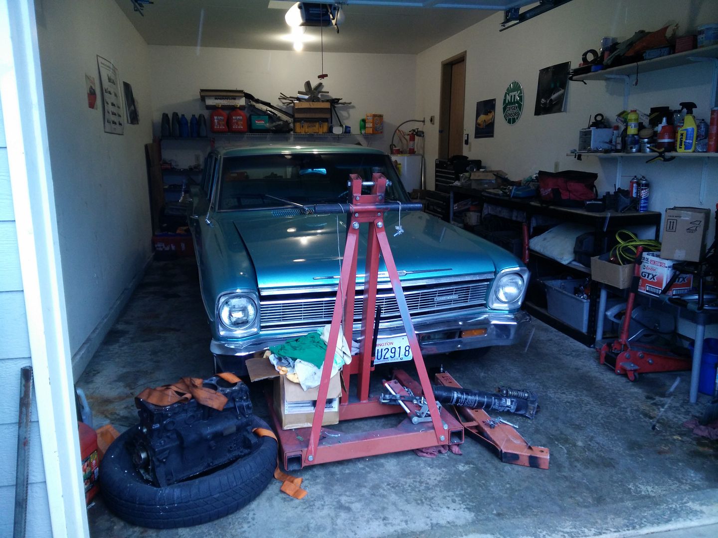

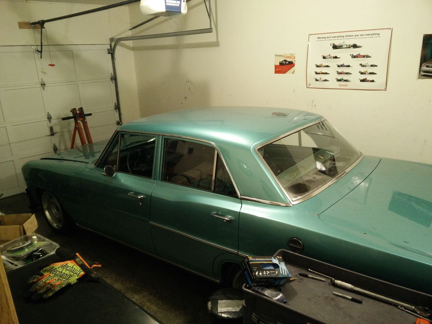

new rack mounts on a jig. and my PS lines.
garage cleaned up, mostly organized, and nova turned around. i have a couple feet between bumper and door.
plan is to open garage door to pull swap, and just roll it into driveway out of the way. then side it to the side of the car out of the way. if i need more room i can just roll shit out in driveway to piss off landlord. lol. plus i can just pull stock clip off and throw it directly into the back of the truck to throw away.
the engine there is the 4g63 out the galant, its sold.
