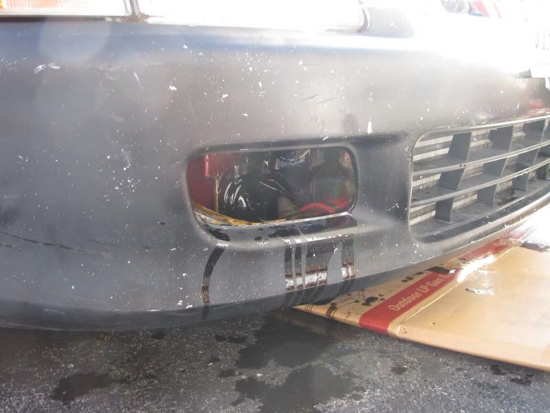

The damn oil feed line came off the fitting and rust proofed the ENTIRE engine bay.  That oil has less than 200 miles on it.  I'm pissed.  However, I messed up the oil pan gasket when I built the motor and it leaked some previously, so I guess now is as good a time as ever to go ahead and fix that seeing how there isn't hardly any oil left in the engine.  Too bad they don't sell brake clean in gallon jugs.  The good news, I have a solid mid to low 13 afr from 2k to 6k on the low side.  Gotta clean up the mess and then jump on the high side.

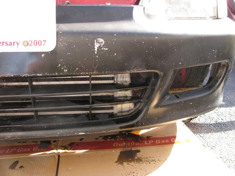

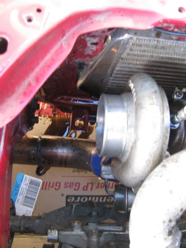

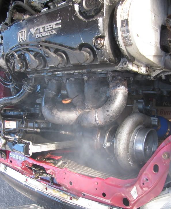

I've been taking care of a bunch of little shit to get it ready for the trip to Asheville and back.  Pulled the oil pan, installed new gasket, fixed the small leak on the drain of the turbo (shitty gasket again), Fixed the oil feed line to the turbo so it hopefully won't come apart again, got something rigged up for the PCV that should get me there and back, finished an exhaust with a glasspack muffler so it exits at the rear of the vehicle instead of just behind the firewall, installed a 25 psi boost gauge (hoping to use most of that), and I still need to swap out an axle after a cv joint boot exploded a while back.  I ordered a camshaft with 3 day shipping from crower this past weekend, and it still hasn't got here.  If that gets here in time, I'll throw it in.

It did.  Thought of several bad things right of the bat, but once the low oil pressure light came on while making the trip back to the crib, I knew what happened.
Car is running great since I 'fixed' all the small stuff.  Shit makes 8ish psi with the waste gate arm unhooked from the flapper, on low side of the cam only.  Can't wait to see what JD can do with it!

lol you got a dirty engine bay :P Nothing broken hopefully.
Re: 350 or Bust - Love me some D: Getting a tune
« Reply #136 on: December 15, 2009, 01:03:06 PM »
Nope, just oily.
