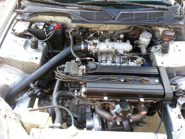

you had 72# injectors, i have 680cc... im running a stock 1.7bar map, you had a 2.5bar. so i changed the map sensor. that fucked with the tune. only like 7.5* timing at top? so i copied the last vacuum column, thne pasted that all the way across. then ran the boost comp thing for like 1.5* retard per pound. its like 20* for the last column i think?
there is like a 5% diff in injector size? and 30% diff for 92oct vs E85... so i guessed around 25% i think? and added that to the hole map lol. started on like half a crank the first time.
idles great with the BC turbo cams in it. sure that has some to do with your map. these should be bigger cams.
anyway. in the next couple days i hope to get the exhaust on (still probably needs some fab). and finish off one of my chargepipes that just needs a cut, and a couple welds.
need to clean the garage forsure. then swap to my wheels. car looks like shit. but it will have some baller wheels. lol.
cant wait to get out on the road with this. kinda excited. :)

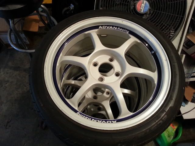

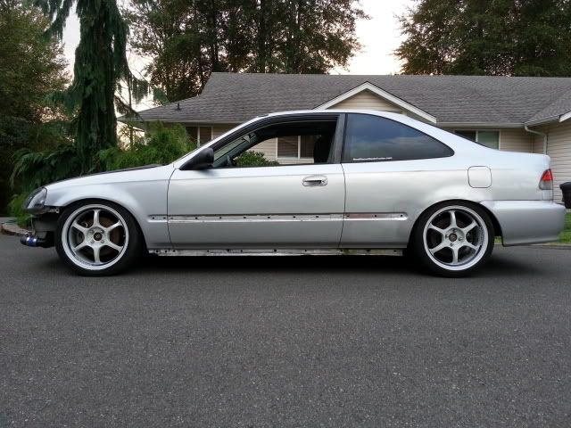

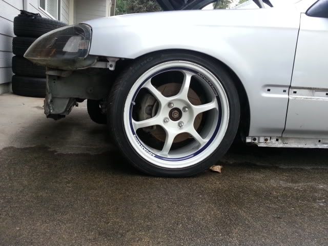

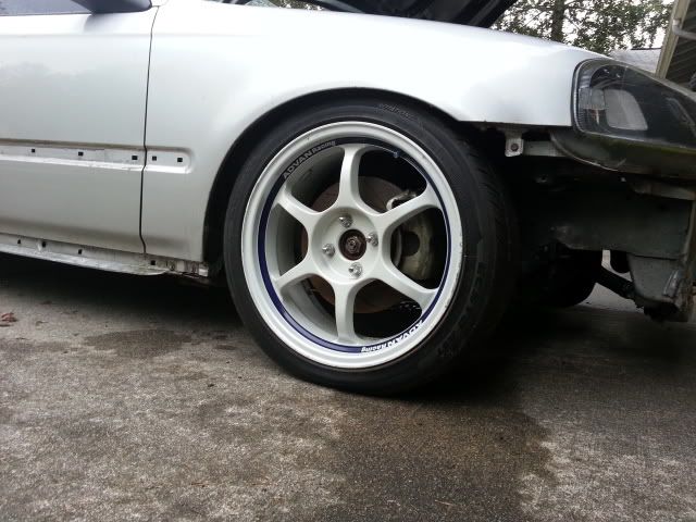

lol. forgot about the wheels pics...

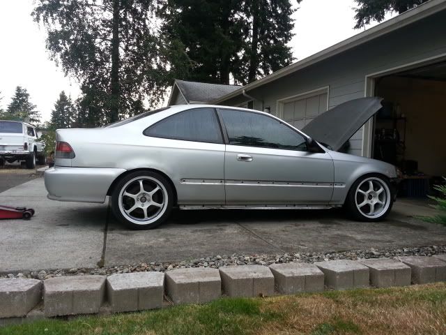

Advan RG  17x7.5" et43 205-45-17   :Jew:
still havent pulled the rears off the car to extend the hats and lower it some more... maybe this weekend. got 3 days....

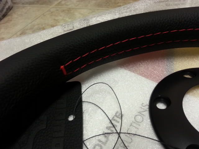

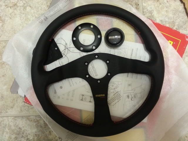

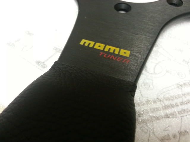

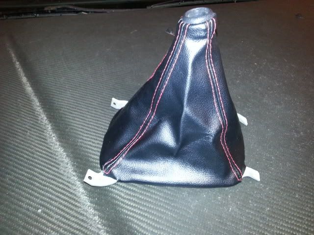

oh yeah, bought this too...
OEM black one was nasty. so i stepped up for a CTR red stitched one.... ok this was a $20 one off ebay. but pretty decent. think i used the same one for the CRX also.

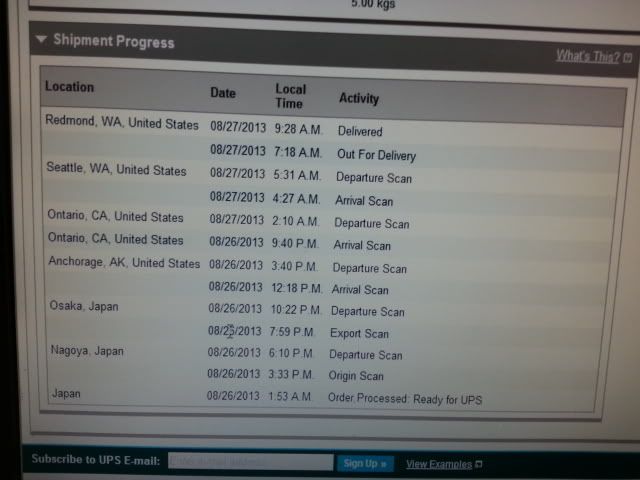

thats right, OVERNIGHT PARTS FROM JAPAN  :noel:
got a call from a big wig saying, "your critical backorder part blah, blah...shipped from japan... youll have it tomorrow... would you like a tracking number?" YES! lol

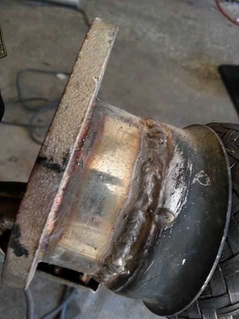

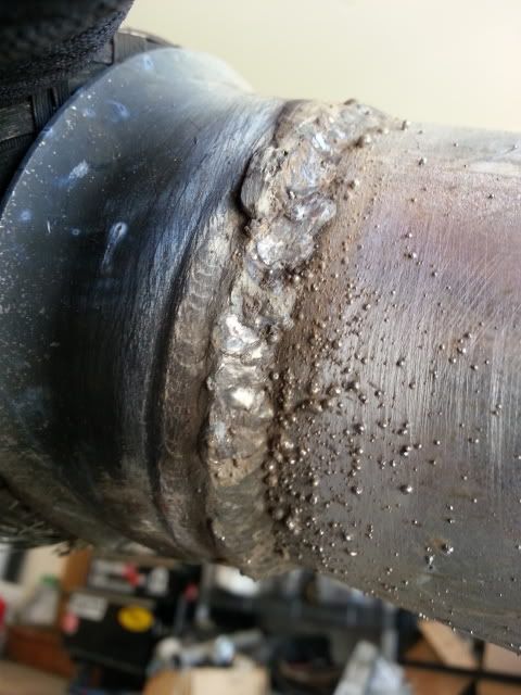

flux core!
scares me how good i lay this down sometimes.
fillin gaps lol..
I HATE EXHAUST WORK... i dont even like the fab of chargepipes. but at least its not under the car with flux and spiders/webs and shit...

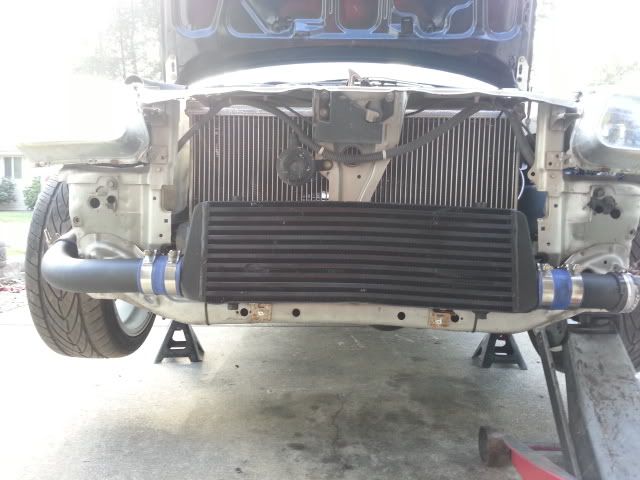

maybe/hopefully final assembled.

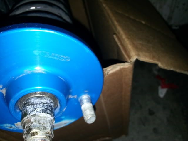

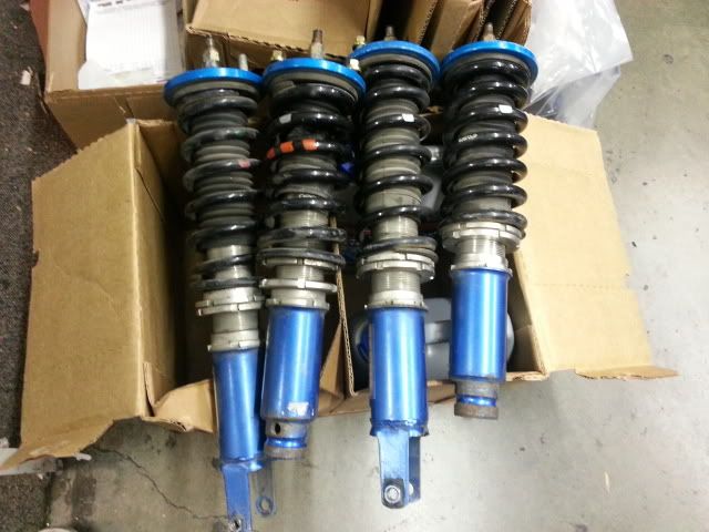

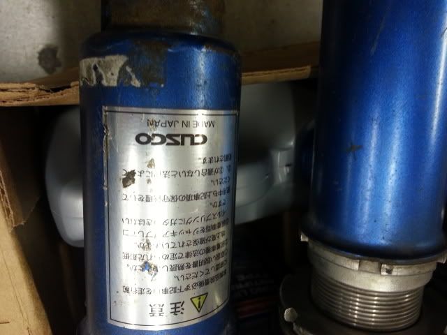

so i search for some shocks....
ok... not very RHMT or probably jewish... but i did get them for deals. but still cost money...
i decided i wanted something quality and stiff. my TIEN RE's (cost x2 what superstreets) on the ITR even with like a million miles on them, road awesome. even the CRX with some over sprung coilovers (10/8k) did.
so yeah. these have shorter shock bodies and all. i only installed the rears tonight. i lowered them a little more than what i got them at. just spun the mounts up/shorter (springs are just lightly loose on perches)
leveled it out. little tuck in rear. WAY STIFFER. probably not as much as the CRX was tho. RHMT setup still in front for now. ill put them on this weekend after it stops raining.

Looks good. How much were they?
Re: turbohf presents: RHMT PROJECT JEW EK
« Reply #100 on: September 04, 2013, 11:44:25 PM »
thanks. $800
oh yeah, they are Cusco Zero-2's think he said the spring rates are 8k/6k
« Last Edit: September 04, 2013, 11:45:58 PM by turbohf »

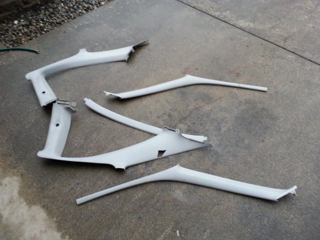

oh this car NEEDS PAINT... LIKE ASAP!... looking for the missing/busted body pieces (if anyone knows local?) and a Si lip/grill combo... if someone knows someone local thats legit to paint/bodywork on this fucker... for legit price... doesnt need to be uber jew or anything, i plan on maybe keeping this car for a long time (lol 2 years?) so i would like a ok job i wont complain about everyday and be the reason i sell this car...

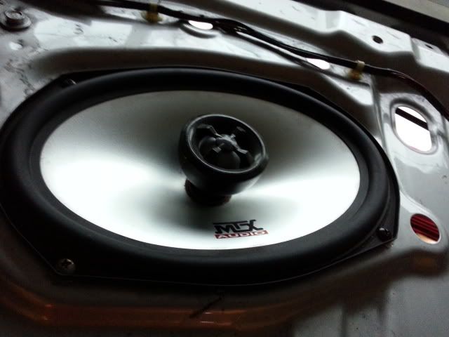

some 6.5" 3way Pioneer front speakers.
i found out last weekend from my buddy when i was trying to swoop some speakers off him that i had 1 MTX 6x9 and 1 6.5 Focal in the rear deck....why? it was some stupid story. upshot is i swiped the other MTX before i left.
note to self:  rear shelf buzzes like a mofo...and sub isnt even installed.

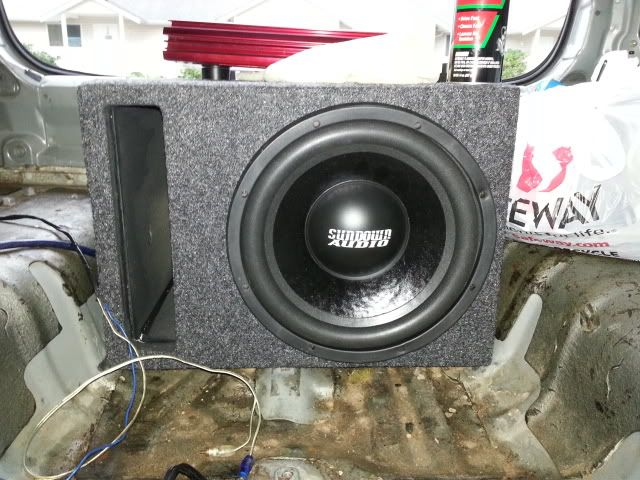

i bought a subwoofer box. its under the speakers in the pic above. ill try to remember to get a pic. its an RT Enterprises ported prefab box. they say made in USA. feels pretty sturdy for a prefab.
box is big. doesnt fit where i wanted for several reasons. and no spot to mount the amp.... oh and i cant find my box that the amp came in. has tbe book (found online tho) and the mounting brackets. fuck.

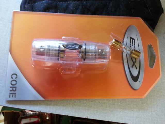

so i dug around for wire. found 3 lengths. 10', 12', 15'... 15' was 4ga. so no problem. used about 18" of some 5ga from one of the other rolls for ground. got them all ran and wired to plug for amp. oh yeah. i dont have lugs to hook to battery or ground. fuck  :-[
also spent too long trying to figure out where to mount the sub box and amp... not 100% happy with where either are, but should be fine, and ill live im sure.

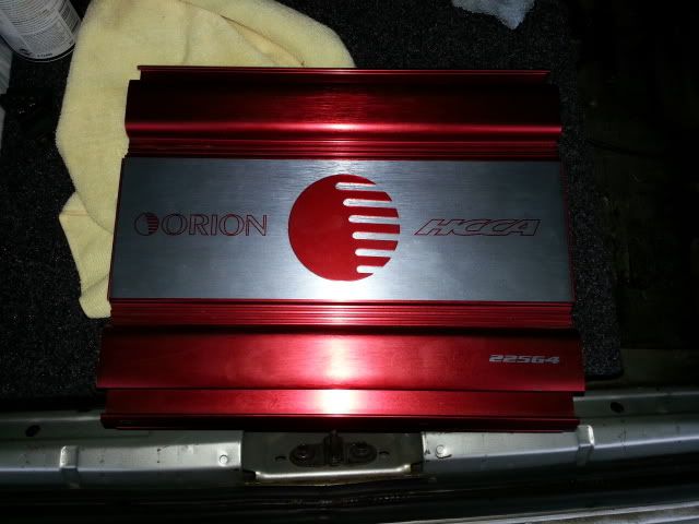

oh yeah, this is the amp im using...just some cheap amp i got off ebay a couple years back  ::)
its gonna bump this.
like i said before. its a Sundown 12" dvc 4ohm....wired parallel, bridged at the amp. RT Enterprises box.

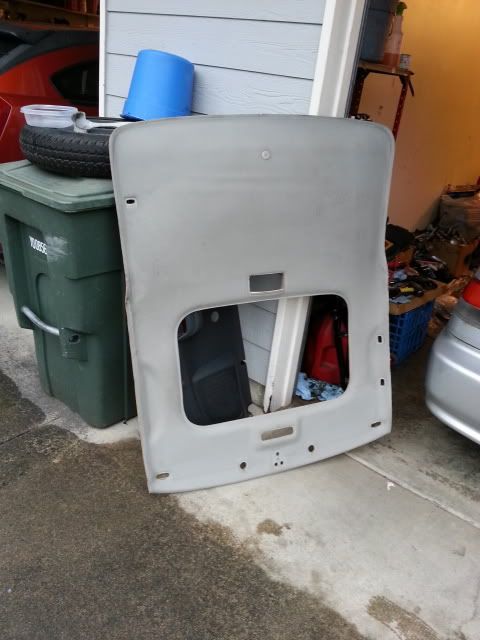

headliner is sagging....like the WHOLE FUCKIN CARDBOARD... yeah cardboard. anyway, need to get a new one to replace it. looks like a broke one of the plastics also. shit.

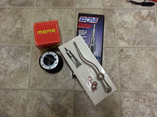

installed the B&M short shifter the other night. forgot how much i hate swapping out shifters. btw, now i wish i wouldnt have bought this stupid thing. but couldnt find an OEM shifter in the time fame i had, which ended up getting fucked anyway...
yes it is too short, yes it hits the exhaust  ::) :-X :evil:

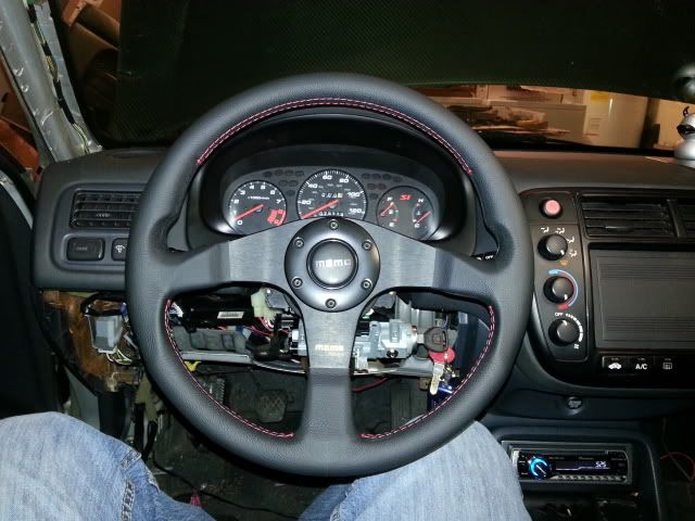

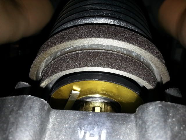

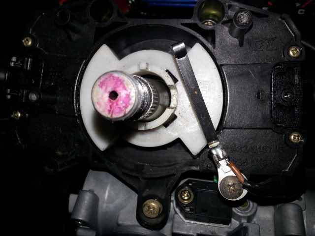

so when you swap in an aftermarket steering wheel into a 96-00 Civic (and others?) you loose the horn cuz all the contact shit is inside the SRS reel. with some searching you can find some write ups, most are shitty as you imagine. but the idea is to go oldschool. 88-91 Civics had a copper wire/spring thing that makes contact on the back side of the steering wheel... same idea (and if you wanted im sure you could use those parts, but im lazy)
i used a metal clip from a pen (seen someone else do this before) and a wire connector, crimped and soldered it all up for insurance. then your run the middle/brown wire on the gray plug that you unplugged when removing the SRS reel. BEEEP BEEEP  :P
*btw, this is by no means a writeup. my car didnt have a air bag to begin with. be sure to disconnect your battery, put your car on jackstands, and read your OEM Honda/Helm (not fuckin chiltons garbage) manual, etc...
still need some clean up, but you get the idea.

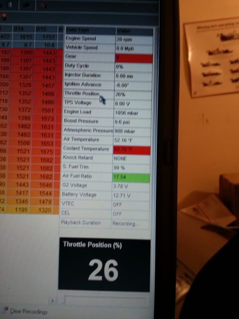

finally got my 3bar map sensor. put that in. tweaked with the map.
took some work, but got the map ironed out in cruise. not really good/quick at tuning. especially with this wild ass guess base i worked up lol. solid 800rpm or so idle. cruise is drivable. didnt get into any boost. but looking at the map after some cruise tuning, it looks like it will hit a fuckin wall of fuel and probably not like it.
think the turbo is fucked. still smokes. i assume im passed the burn off phase.... and its leaking little oil from the turbine housing.  :-\
WTF IS WRONG WITH CROME?!?!  just like before in the CRX, its not logging/tracing the last column or 2 of vacuum and nothing in boost.

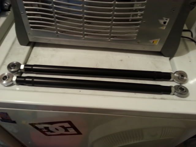

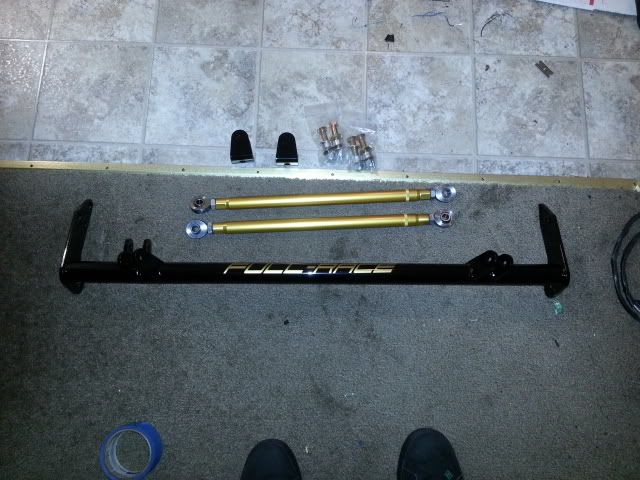

so i bought this.
Full-Race Prostreet? traction bar. looks like its upgradeable to add the engine mount. these things actually went down in price. think i sold my old one for this much...
oh, and..
i painted those homo gold rods black... cant stand that shit... all of them. why do people thing they need purple/gold/polished/whatever bars and arms that dont do shit for them? well i guess this one is actually useful... but whatever.
didnt install this for several reasons. fedex sucks. its pissing rain. im lazy. and realized i dont have bolts, couldnt find any either. ill look again tomorrow, or just order new ones from Honda...
btw. my car has stock upper/lower control arms front and rear. no subframe braces. no beaks bar. no homo cross braces in the trunk/windows. no strut bars.... shit i dont even have front or rear swaybars.
these people really spend too much money buying this homo shit that does nothing for these hardparkin clowns...

ok. fuck. help?...
 i got a code7 CEL... TPS...
i have .5v at C11 on OBD1 ECU.
roll into throttle it goes all the way to 4.95 or something. (at ECU)
power and ground at plug.
but turn CROME on, it says 0.00v and 26% throttle...
wtf?
« Reply #116 on: September 29, 2013, 01:59:06 PM »
So if you fire it up with crome not running you get no cel?
« Reply #117 on: September 29, 2013, 02:24:23 PM »
i will double check here in a min. but correct. i fire it off, CEL isnt on. my live tune says 26%.... but reads .5v at the terminal going into the ECU.
it wasnt until driving about 3 miles, and tipping in harder, and harder to see if it would build boost did it throw the code (thats when i noticed/started looking into it).
i have swapped MAP and TPS plugs with no change. (other than the MAP reading showing nothing).
« Reply #118 on: September 29, 2013, 03:09:09 PM »
ECU visually looks and smells good (P61/92GSR)
pins on ECU are good.
connectors have solid click/fit to ECU
removed pin from jumper harness it looks good
put bare pin on ECU pin. has good contact/tension.
this is what i see on key on, engine off.
(laptop is on roof at angle, poster is straight on wall :P)
« Reply #119 on: September 29, 2013, 05:45:23 PM »
ok. so I guess that's just what crome does...cuz it sucks...
BUT... I'm still getting a code 7 CEL. and when it does that it just reads 26% till I key off then on.
its throwing a code I'm pretty sure cuz its hitting 104% @ WOT... but I readjusted the TPS and its .45v at closed 4.95v at WOT...
