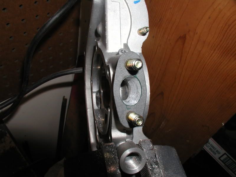

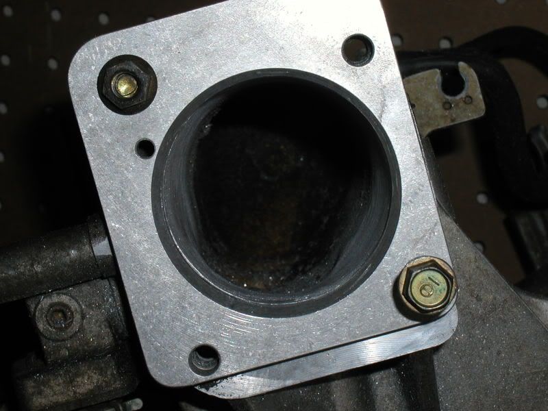

So all the real gangsters in the hood have themselves a '92 CX hatchback.  I myself, am as white as they come, so of course I have one too.

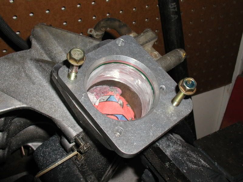

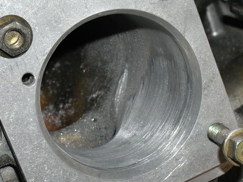

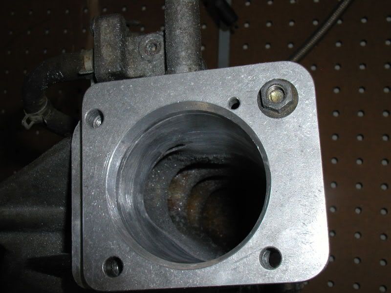

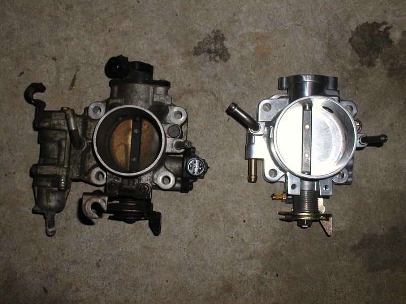

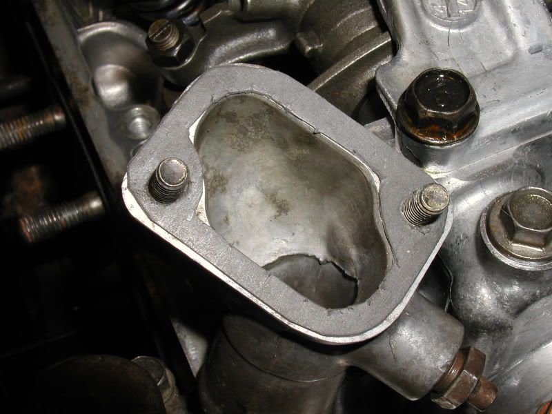

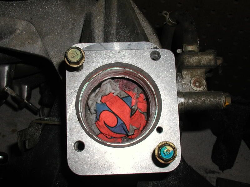

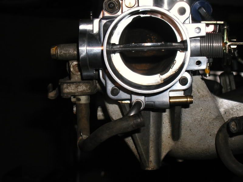

Starting things off with Chris' TB and spacer.  Stock vs. Aftermarket
Installed straight on a Z6 manifold

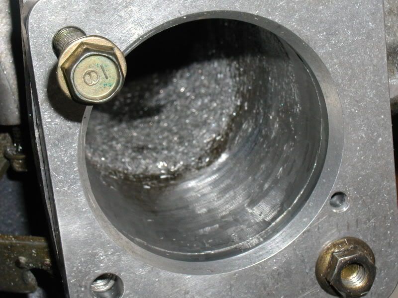

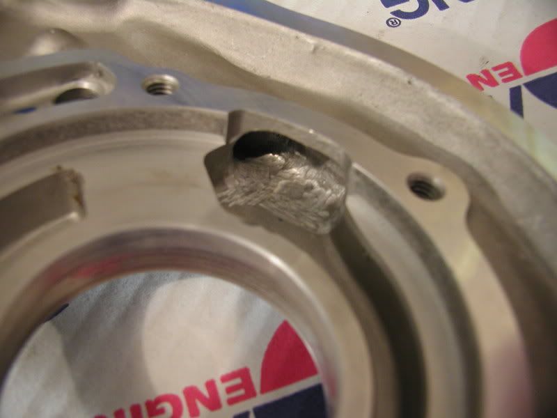

Spacer outlined and some die grinder action

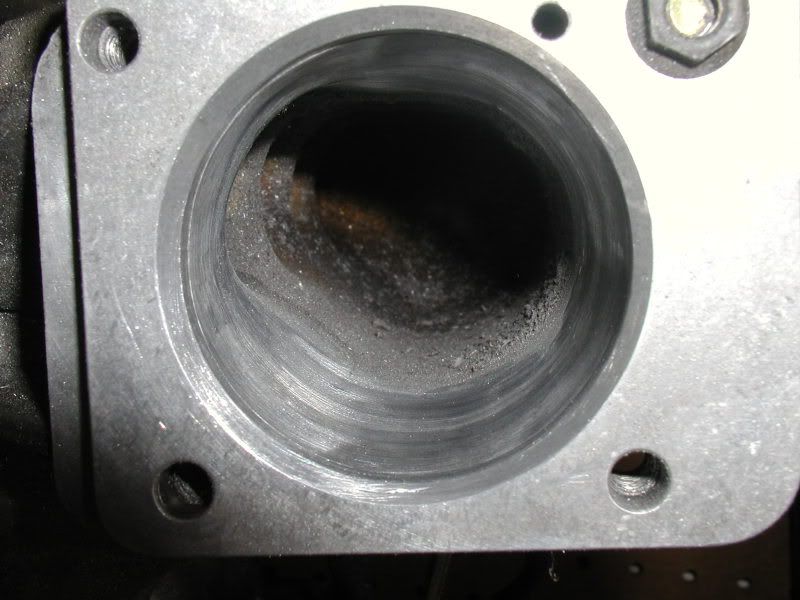

The die grinder would start off like this
And then get filled on half the bit like this
I was getting really, really annoyed as patience isn't one of my strong suits.  So I called it a night and waited till the next day to continue.
This was about 15 minutes of work

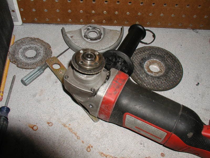

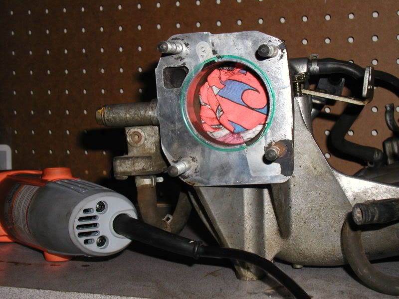

So I never throw anything away and I remembered that I had some really used angle grinder discs in my box.  Turns out, the shield is really easy to remove and the disc reaches in over an inch on the manifold.
Now we're in business
Still going to need smoothed out, and the spacer will be blended into the manifold
Put your steady hands on and don't get in a big hurry.  Put some Barry White on the radio or something

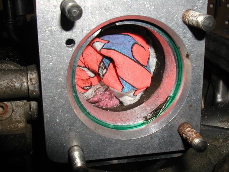

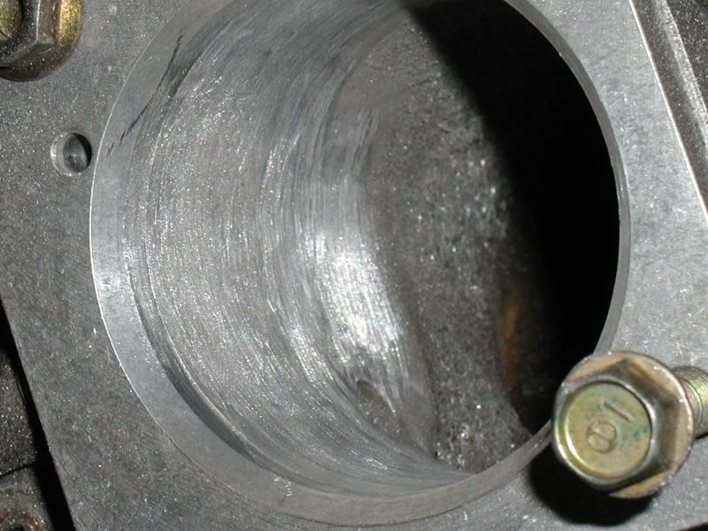

Next is smoothing out with some oxide stones and maybe some more bits in the die grinder
I've got plenty to do, and I'll post up more pictures of the build as I see fit and as I have time.  I'm taking lots of pictures, so expect them in the thread.

Re: 350 or Bust - Love me some D

Its the balla d setup. Im not sure how the manifold will perform with the little bit of work being done with not blending the whole plenum. I port the whole plenum and match into the runners.
I also port the whole runner and full cast removal

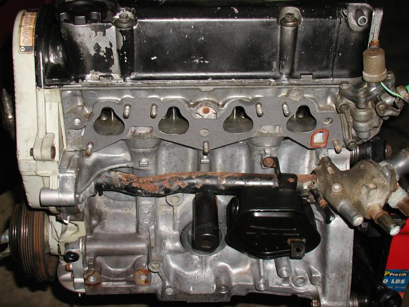

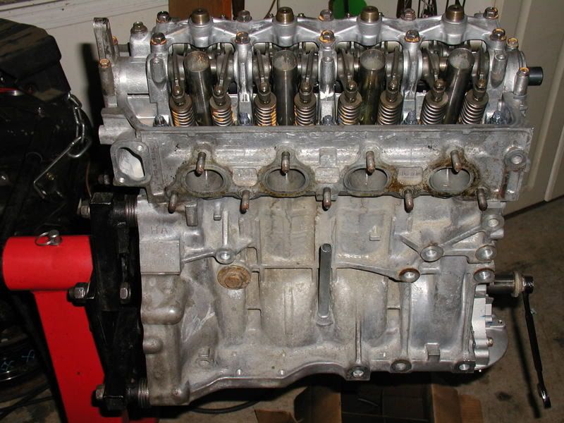

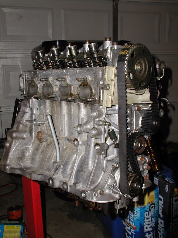

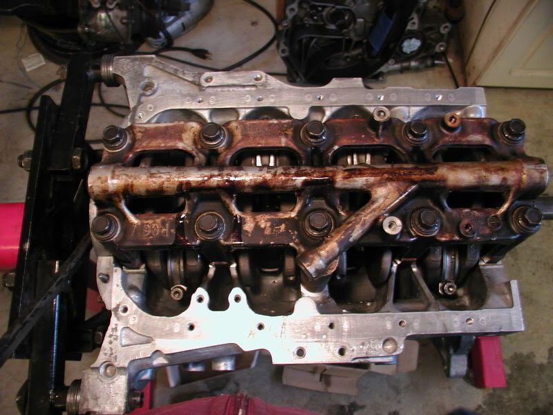

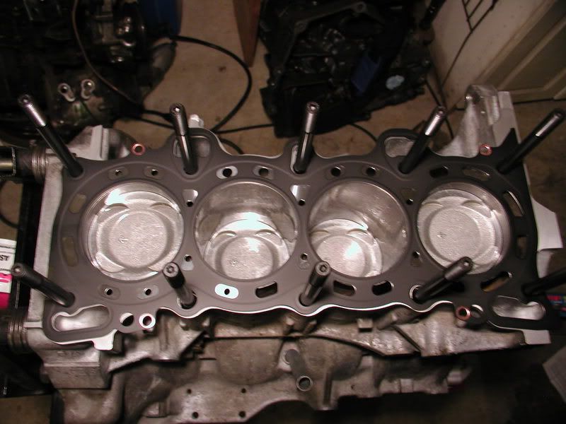

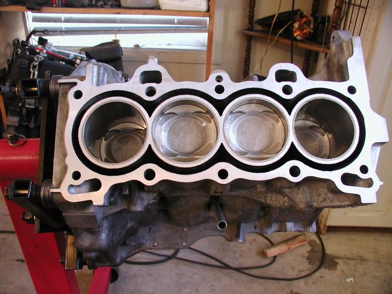

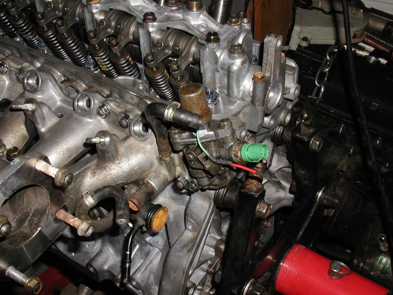

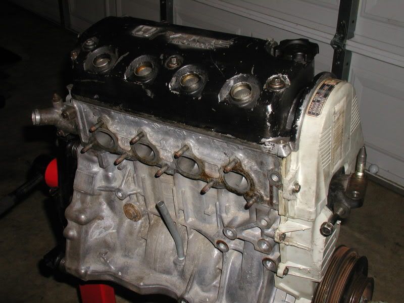

Some pictures of the engine build
76 mm Vitaras from FJT
FJT custom I-beams with ARP rod bolts

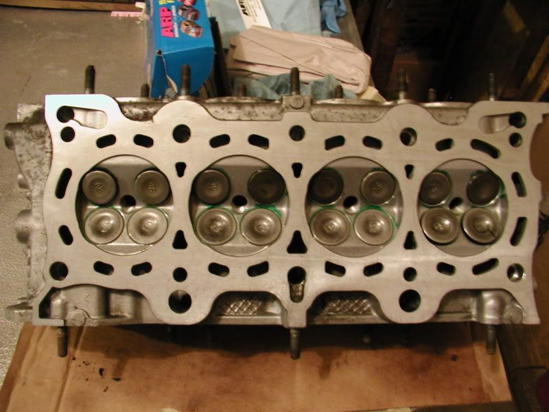

"Good" Z6 head from Eb0la, notice the new valves to replace the bent ones
Bottom end
ARP head studs
Torqued to perfection
« Reply #7 on: March 15, 2009, 01:33:03 PM »

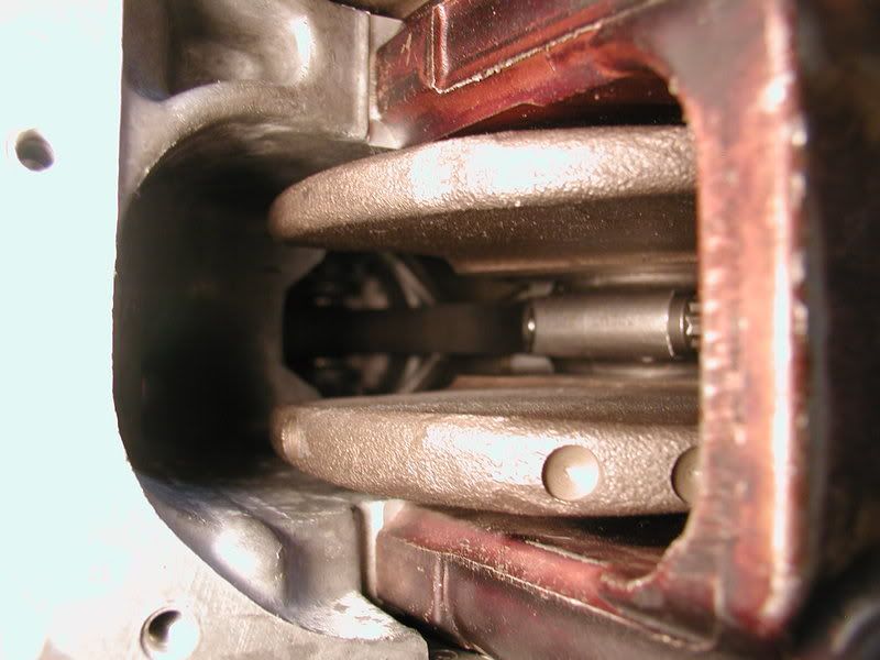

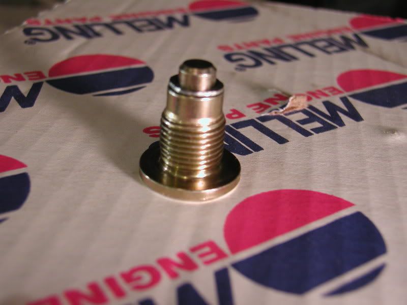

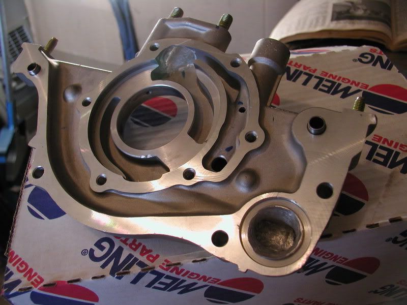

Ported brand new Melling oil pump
Outlet
Pick-up
Shim job
VVVVVTEC solenoid
New timing belt and new water pump
Crank pulley and timing belt covers
Home made gasket
Valve cover
Crossover pipe and PCV box

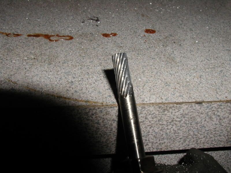

The burs for regular steel suck for alluminum. You need to sport for a good carbide alluminum bur like this one. (if you already knew that sorry, I thought you might and were just useing what you had) Concidering there is so much allimunum in the projects we do, it is a great investment. If only used for aluminum they don't really dull either. Soapy water sprayed on your work will also help a bunch in acheiving good cutting. It makes a bit of a mess but really aids in the work and really helps keep the bur from clogging.
« Reply #12 on: March 15, 2009, 06:16:31 PM »
I thought it might have something to do with it being alluminum.  Those bits are the cheap ones from harbor freight.  I'll have to look into that special aluminum bit.
thanks for the tip
caged
  • Posts: 364
« Reply #13 on: March 15, 2009, 06:58:57 PM »
Or if your cheap just use the steal one with CRC and when it clogs up clean it by cutting a big bit of mild steal :noel:
« Reply #14 on: March 15, 2009, 07:49:38 PM »
Put some air tool oil or wd-40 on the bit, every so often as well, helps keep the aluminum from sticking.

Put some wd-40 on the bit, every so often as well, helps keep the aluminum from sticking.
uhh, yea.  AWESOME tip.  makes aluminum dissapear 10x faster, and it doesn't clog the bit up hardley at all as long as you keep it lubed up.  Spent the last two hours making the intake pretty with the die grinder.  Shit looks solid for my first port job.  going to hit it with some sandpaper rolls tomorrow and get it cleaned out.  shavings EVERYWHERE
pics later

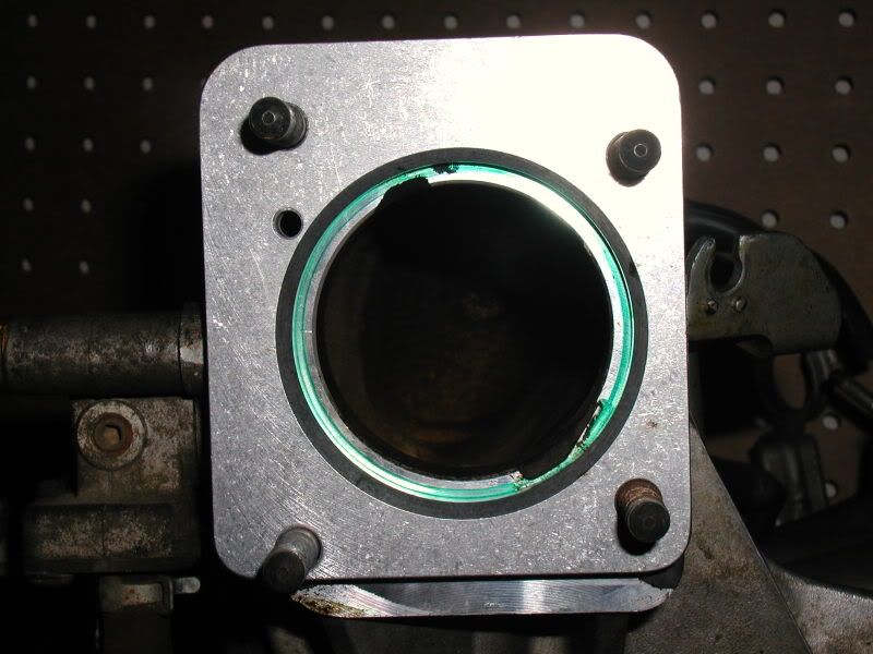

« Reply #22 on: March 18, 2009, 11:14:12 PM »
After the die grinder was done
After 80 grit sandpaper roll action
After 120 grit
Final product
Really happy with how it turned out.  Ended up blending it in about 3 inches total.  Wish I had some deep throat bits that I could really get in there with but I'm making do with what I got.

Not bad for a first timer. Lots of cans of carb cleaner to clean up all the shavings. The spacer really is a nice guide to use when porting
« Reply #25 on: March 19, 2009, 12:05:20 AM »
forgot to mention, i took all the sensors off after i ported it.  definatley will do that before next time, now i get to clean everything else too.  i'm going to the car wash tomorrow to blast what i can out of it before i atack it with the 2.83 a can carb cleaner
