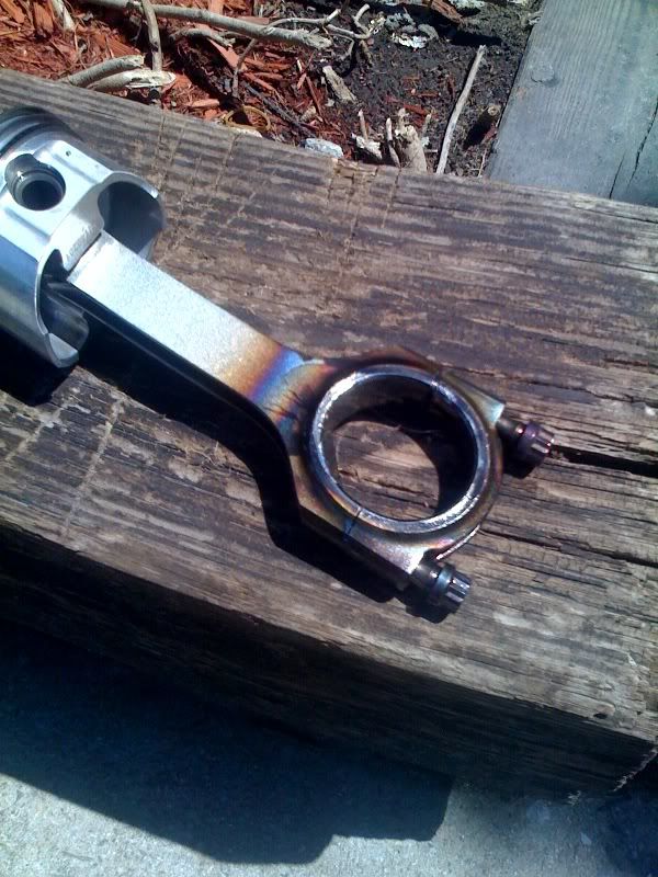

Yeah, his oil pump was shitcanned and pressure was falling off at the far end of the motor.

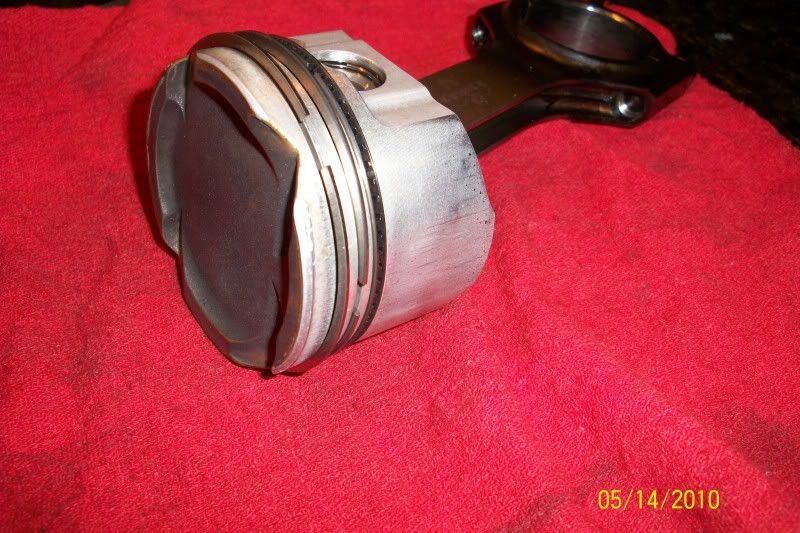

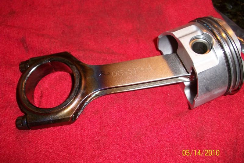

     The day at the track the car got really hot on the 5th pass and then temp went back to normal. After making another pass the car overheated and began to knock. The #2 piston/rod is where the damaged occurred.The last build I used an ebay oil pump which did a lot of damage to the cylinder head, specifically the cam and cam caps. I have currently been using an OEM Honda oil pump that I ported and shimmed.
   I really wanted to use the same pistons, but, b/c the wrist pin appears to be bent, and the corner of the crown/ringland look damaged, Im probably gonna put a set of Vitaras that have been thermal coated, and a new set of Eagles.
   When I was removing the ARP head studs, I noticed pieces of threads that were in the block. I assume that torquing the head over and over to 85ft lbs took its toll. Timesert and Helicoil make kits but are kind of costly. I have to ask the machine shop for the labor rate.

i haven't followed thsi one closely, so bare with my ignorance.  If the block isn't sleeved, then having time Serts(far superior to Helicoils) would cost more than sourcing another block and having it machined.
I know it isn't cheap when we Time Sert Northstars.
Why in the hell were you torquing the head studs to 85 ft-lbs?  D16 studs are only M10, and ARP only recommends 70 ft-lbs with 30 weight oil on the 220,000 psi rated hardware.  The head studs are heat treated to 200,000 pis.

Yeah, I admit I made them too tight. I thought more would cause less head lift but it was the head gasket becoming compressed during the heat cycles.
I have a spare block, but I'm trying to avoid notching the block and girdle for the Eagle rods. Lol
