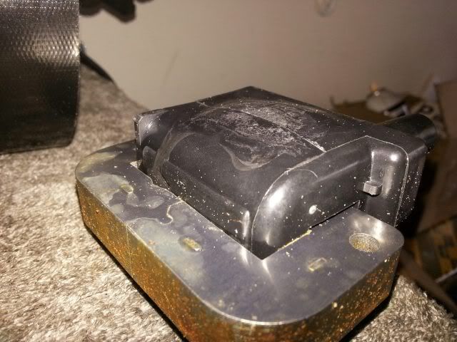

oh here is the coil:
it was not being photogenic. but you can see on the top where it is budging/melted...  :o

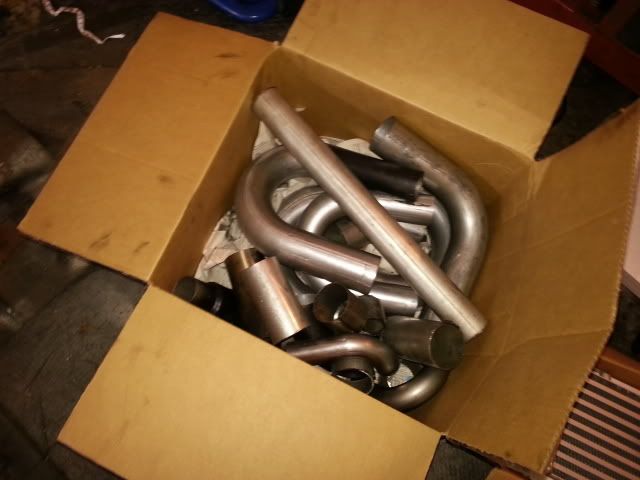

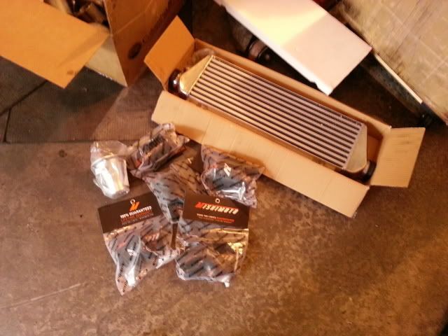

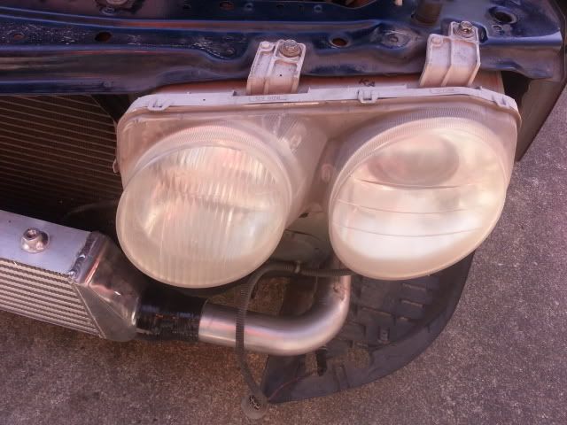

TURBO FAB....  :noel:
EMUSA 27x7x2.5? intercooler. and a bunch of Mishimoto black couplers.
this is most of my order from Columbia. i have a handful of flanges somewhere else. i also dug threw my scraps and threw them in there just in case.

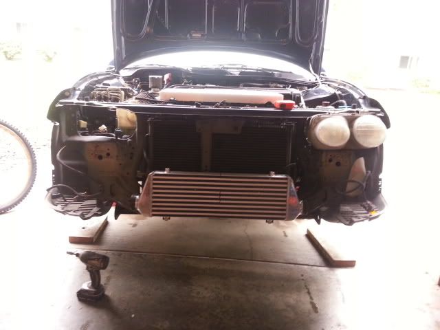

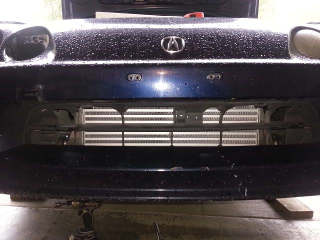

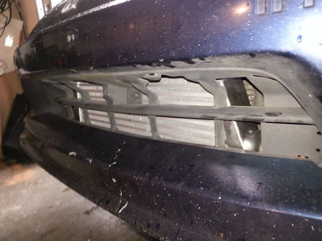

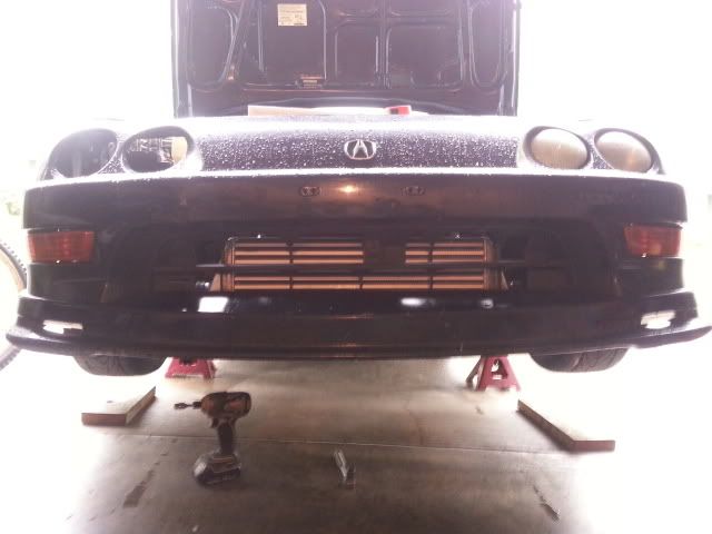

intercooler getting mocked up... took the bumper beam out cuz it was fuckin tweaked. took the headlight out cuz it was tweaked enough where i was afraid to hit the headlight when i tried beating on it and removing it.
so not sure wtf im gonna do about that? probably nothing. fuckit.
intercooler is actually bolted to the car... not sure i have ever done that before? its usually sitting on something, held up by the chargepipes, zip ties, etc...
intercooler will be painted black before final assembly...  O0
bumper cover took the ever so slightest bit of trimming. there where a couple little useless tabs on the back that bumped the end tanks.

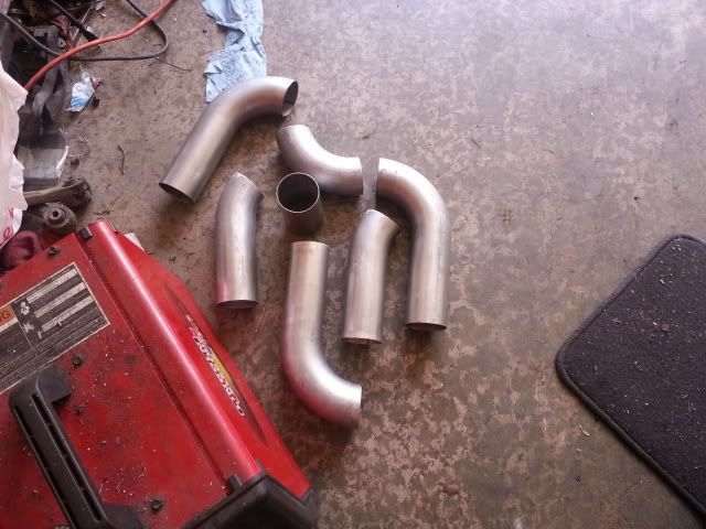

then i started cutting up all the pipes i just bought....and didnt take a single pic. lol. i think i was in the zone. should turn out pretty nice, i think. just all loosely fabbed up. need to get some brake cleaner to clean the pipes before welding them up.
more later...
 :Jew:
Sedrostyle
  • Posts: 106
  • Turbine Noob
What a fucking tease. Turbo fab. But no cuts or welds pics.
Failing. Errrrr

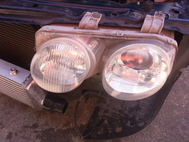

So why did you pull the headlight again? And it will need to be replaced yes? Haha
this car was rear ended before. and when it was it looks like it was pushed into something else also, probably a trailer hitch? and it tweaked the crash beam. it was a cunt hair from the headlight when i pulled the bumper off. so i pulled the headlight to get it out of the way. then just removed the beam.
you can see the scar on the bumper below the inner light in the pics.
both headlights need sanded and buffed as they are weathered, but other than that they are fine.
oh, and i have a replacement oem bumper and lip for this.. just waiting to get them painted.

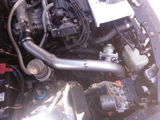

ok...more...

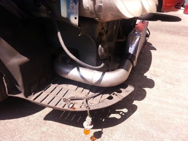

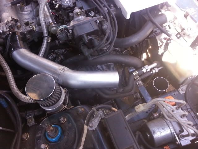

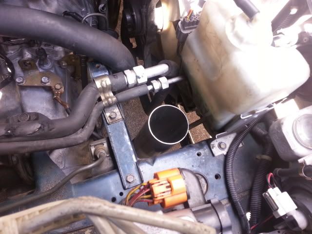

hotside of chargepipes...

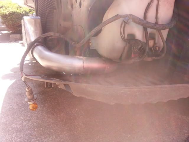

gonna look about like this. i used 2" pipe on this side.
on the car

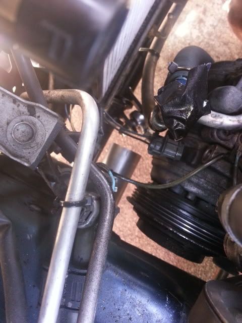

and this is why i run 2" pipe. much easier to snake around cool shit like washer tank, AC compressor, traction bar, etc...

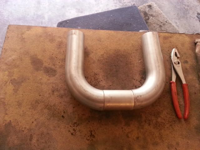

cold side pipes
like i said before i cut these up earlier.
thats x2 180*, and a 90*... all where cut in the center. then i trimmed a couple to my liking.
sun was making picture taking difficult
looking good...

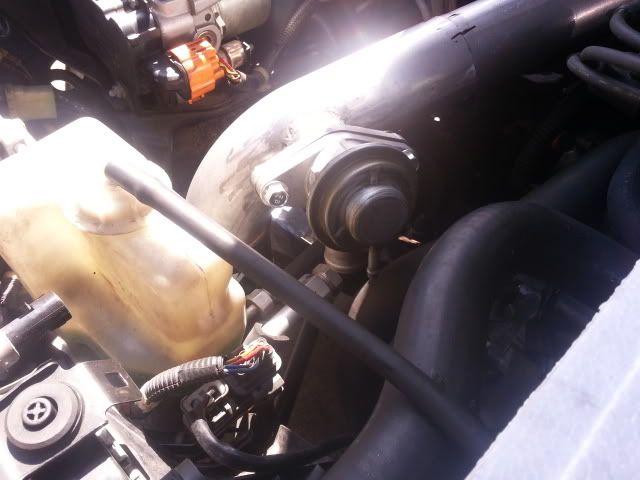

oh yeah, i mention im running a 1g DSM BOV? cuz i am. i have a brand new OEM gasket around here somewhere for it (these are less than 2bucks). this one is slightly crushed... by crushed, i mean i hit it with my mallet a couple times. add more as needed :P

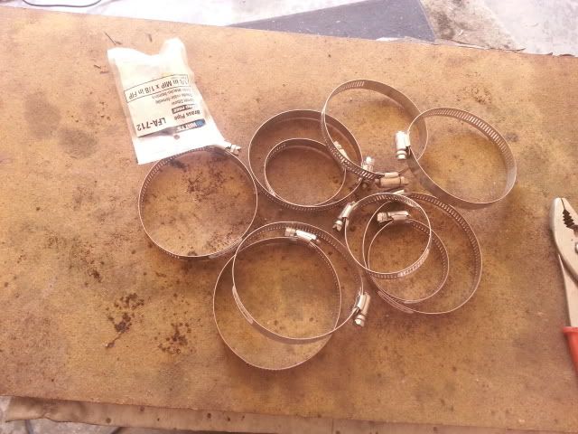

btw. fuck T-bolt clamps.
these work fine. got them at Home Depot. like 15bucks for all of them. i have used them on the ITR, CRX, EK, GVR4, etc... just buy 3" ones, and trim the extra off.
then i figured i was about done for that.

not sure if you can see that from the other pics i have posted, but the headlights look like SHIT.
oh yeah, sexy now.  8)
i used the 3M headlight kit. was like 18bucks. hit it with a couple levels of wet/dry sand paper (wet), then buffed it out with the supplied buffer pad on my drill. also had some rubbing compound in the package, i used that, but i have used (and still have a bunch) Meguirs PlastiX.

cheapo tooth paste works on headlights too
ohisofly
  • Posts: 166
Looks good, I like how the intercooler piping is turning out
91 Crx Si - turbo ls vtec
Looking good!
